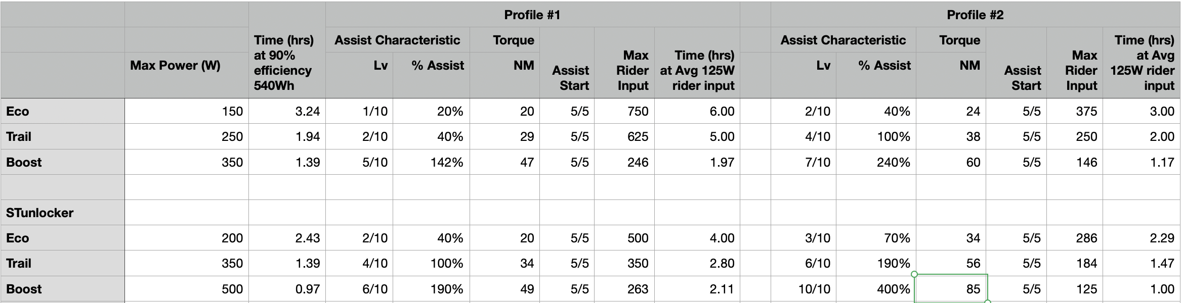

I have just done the same but I haven't put it into a full ride yet but in testing it seems good. I typically only ride the one profile and had it set up as eco 33NM, trail 47NM and Boost 60NM. My intent was to unlock some power for shorter boost sessions using 85NM and the full 500w for when I REALLY need it. I don't expect to use it much as I don't use boost all that much anyway today at 60NM. I had some concern on what this might do to the 540wh battery (currently at 41 full cycles and 100% health after 2,500+ miles and 2 years) so I wanted regular settings to be somewhat close to before.
My goal. Profile 1 to be similar to stock with boost up to 60NM. Profile 2 to go full power with eco similar to prior trail and trail closer to boost.
Stock, power is:
eco 150w
trail 250w
boost 350w
I changed power to be:
eco 200w
trail 350w
boost 500w
I did some calculations on how I might do this.
Basically I have (All at 5/5 assist start):
Profile #1
eco - assist 2/10 (40%) - 20NM
trail - assist 4/10 (100%) - 34NM
boost - assist 6/10 (190%) - 49NM
Profile #2
eco - assist 3/10 (70%) - 34NM
trail - assist 6/10 (190%) - 56NM
boost - assist 10/10 (400%) - 85NM
I see myself using profile 1 on flatter terrain and shifting between trail and boost but I would have eco to fall back on for really long rides. For shorter, hillier terrain I can use profile 2 and run mostly eco or trail, with boost for those - I really need it moments.
In preliminary testing it feels pretty good but will adjust as I get used to it and determine my real needs. I agree though it would be nice if we could limit power between the tow profiles so that profile 1 was more the "rs" tune and profile 2 more unrestricted.
