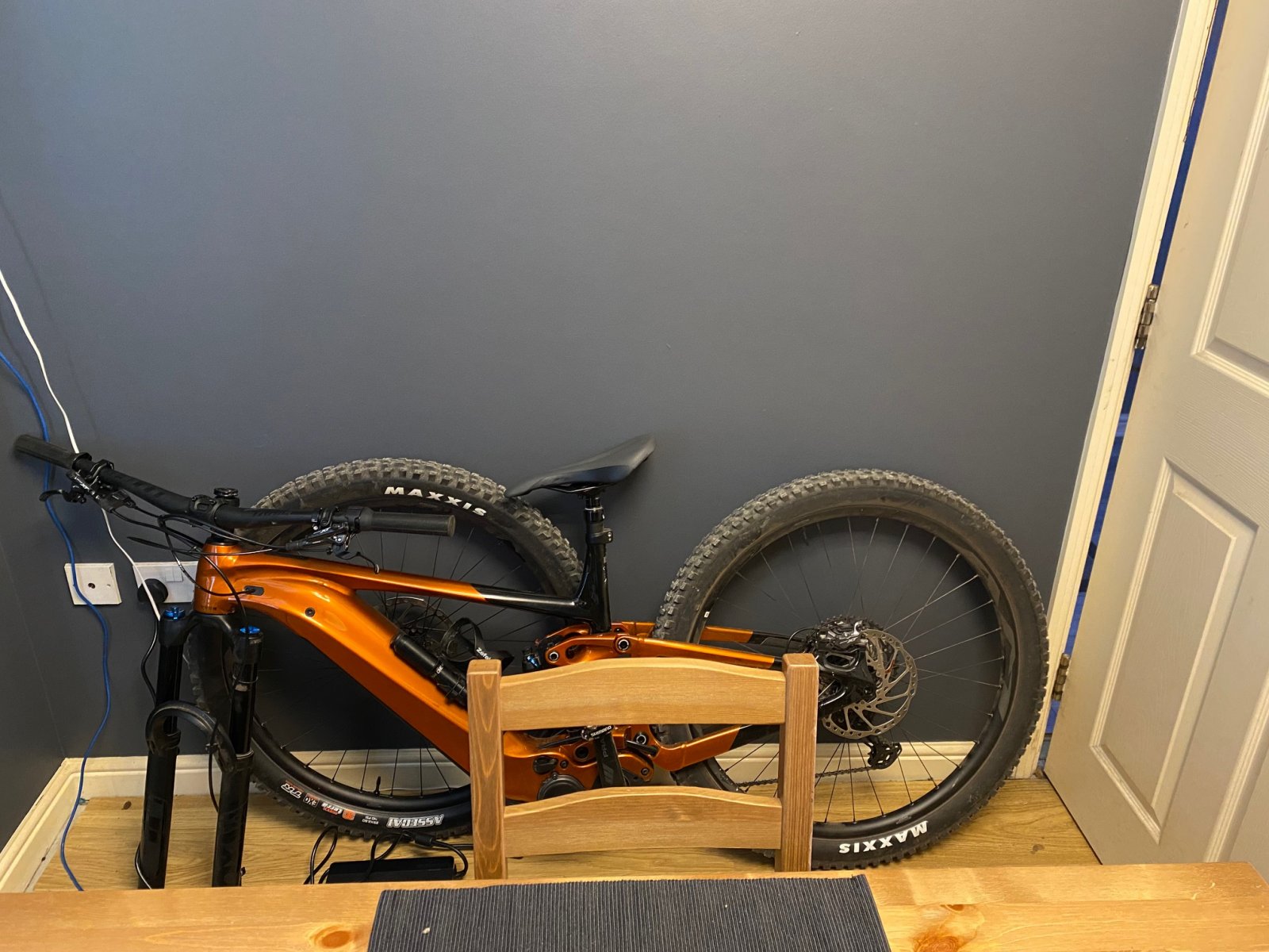

A pic is attached of now and will post more pictures when I start the work, so everybody can see what the above means :)
The floor and wood paint is to be re-done at some point as the floor was terribly fitted many years ago ( I have removed edging strips, hence the large gap)

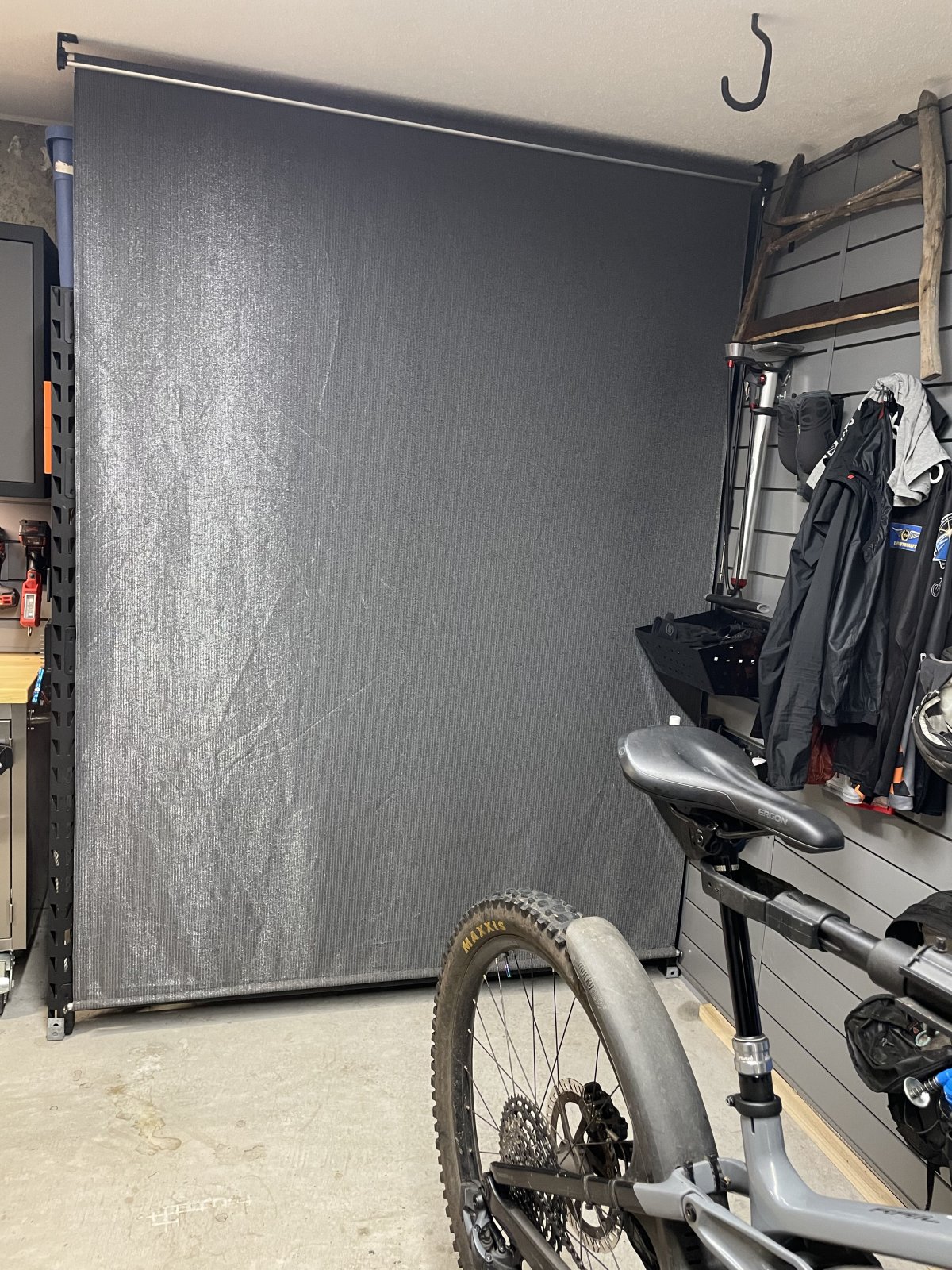

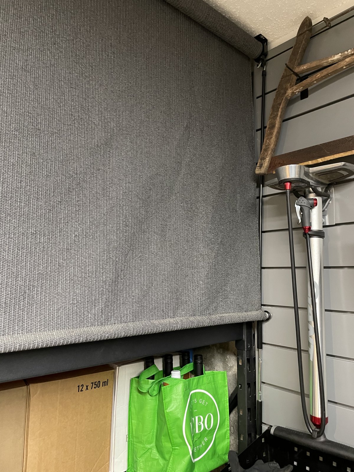

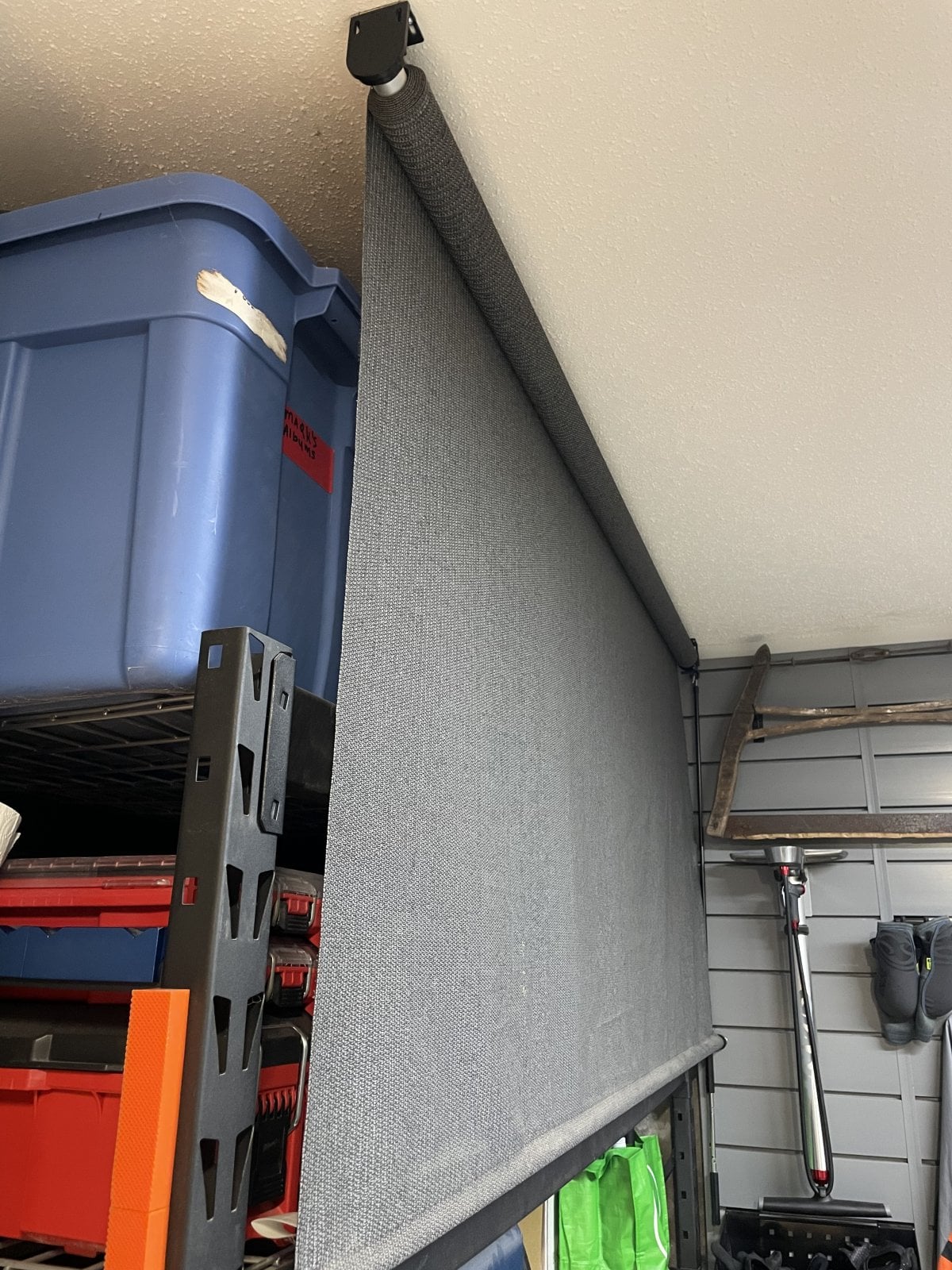

How about a roller blind instead of doors?...
Also made to measure.
Yup, I did the same. Home Depot had them in different widths (72” & 96”). I didn’t need to hide the bikes but the other house-stuff is outta sight.
There’s a rod on the right side for rolling up or down.
Didn’t need to cover up everything and the ceiling is a little higher then 9’.
In this case I anchored to the floor/ceil joist.

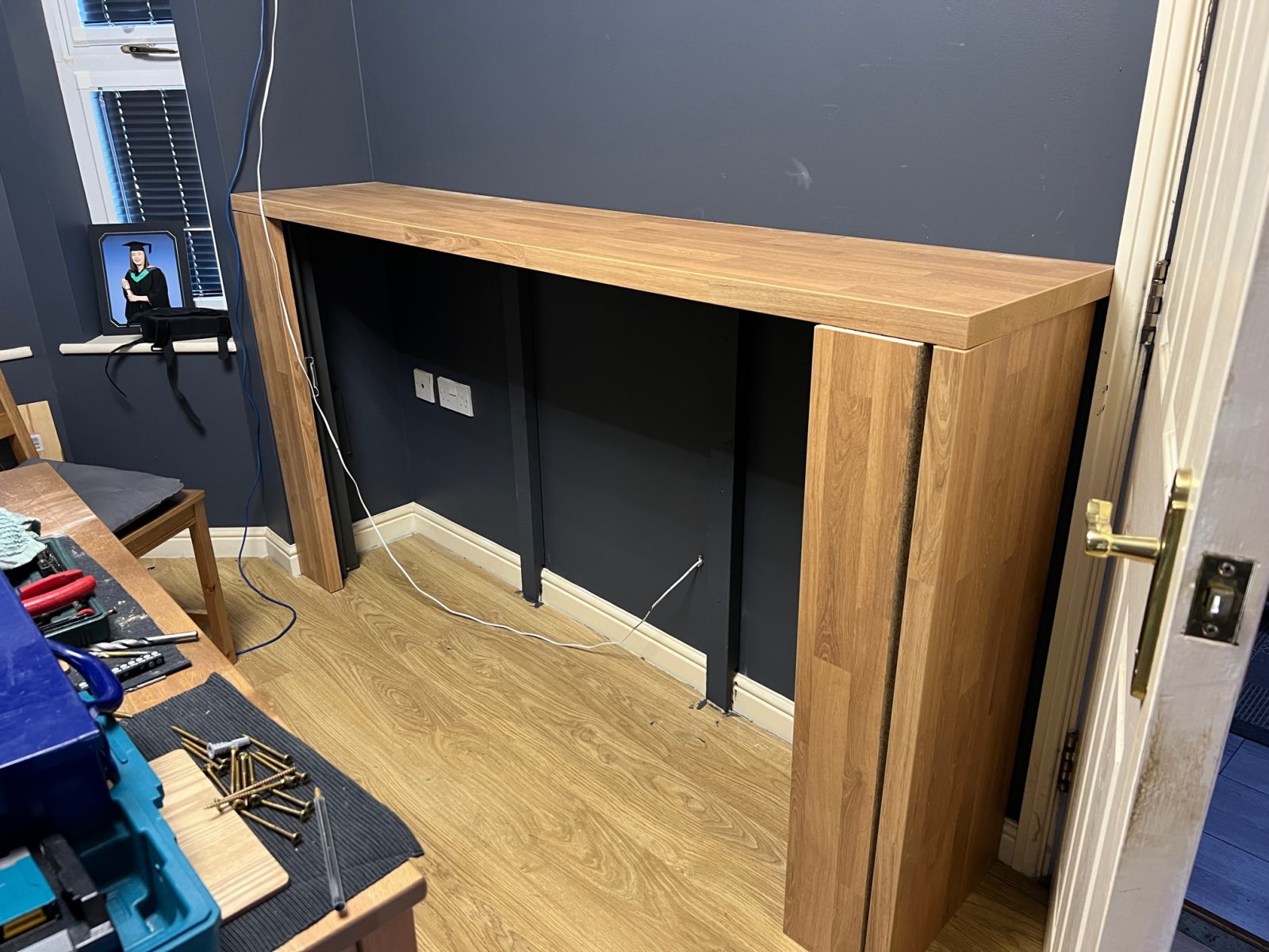

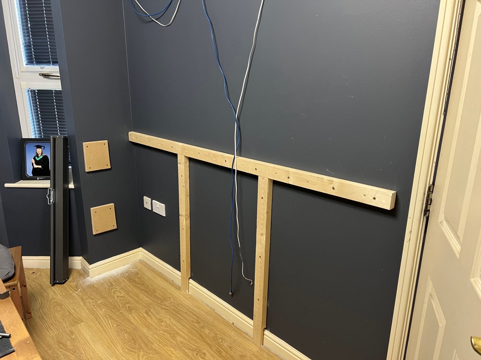

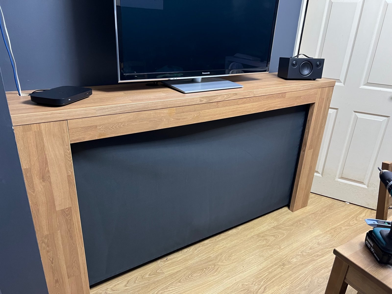

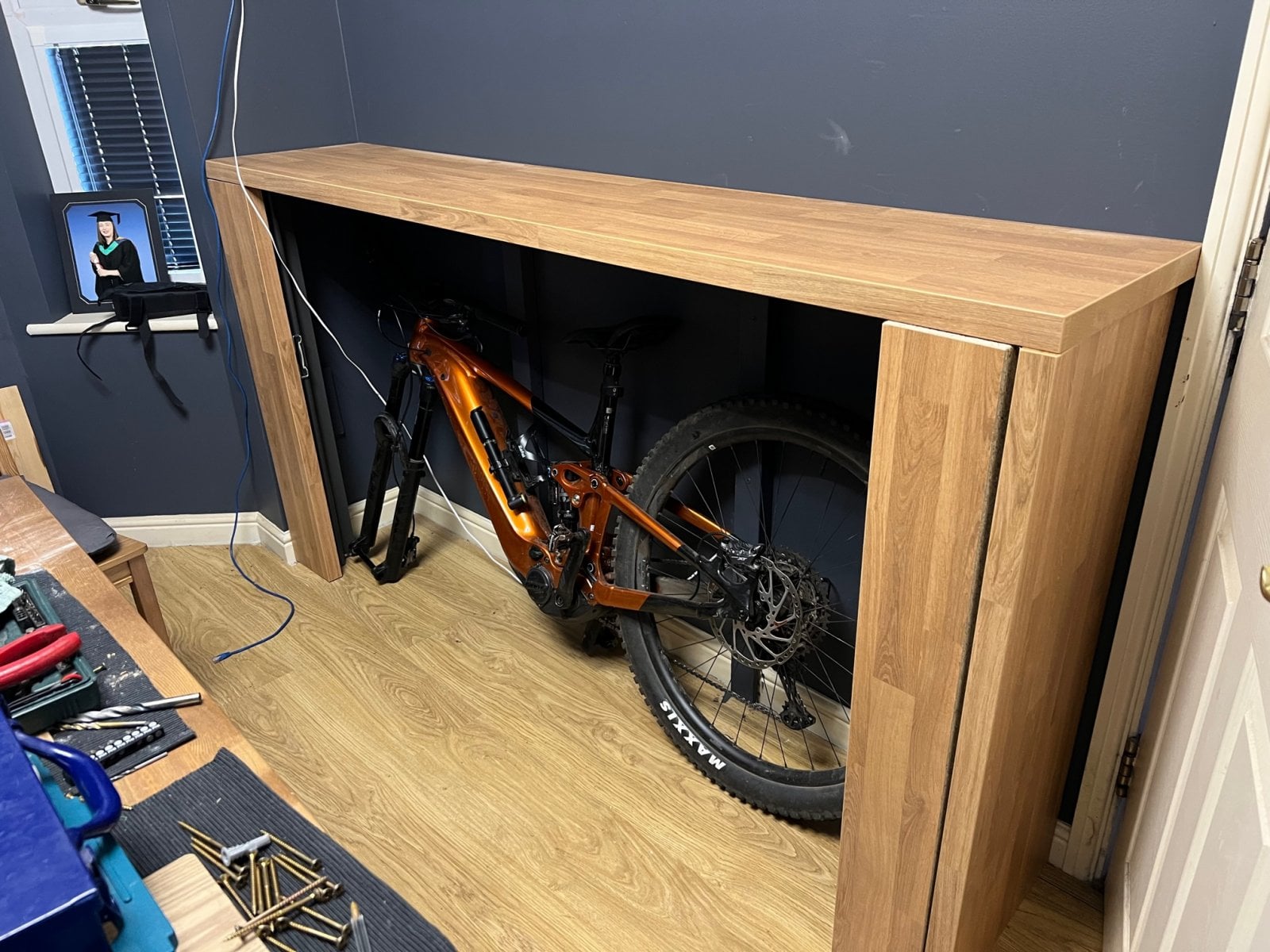

Thought I'd update this in case anybody is interested.
Have a couple of weeks off work so set to the bike storage.
After buying the awning thing mentioned above for £65 from Amazon, I looked into a load of options for the frame.
Went from made to measure oak timber sections (£800+), to butchering a £350 unit down to making my own from dual layered 18mm MDF and laminate sheets, I ended up at a happy medium with 2 Ikea worktops and copious use of a track saw.
The only real problem was man handling the 38KG 2.4M long work tops from the car to garage and into position to be cut. Once cut down it was all relatively easy.
Here is a much shortened sequence of events.
1. Support on wall, with further support for support down to the floor as it is into am internal wall and plasterboard only.
2. Panels loosely in place to check fit.
3. Bike in to check fit before final assembly.
4. All assembled and fixed.
Still have to put a cable port in the top left (Done the the other two, this one needs the broadband cable unplugging and feeding through the wall). Also have some cable management trays coming tomorrow for a few cables that are currently behind the bike.
The cloth on the blind is a little uneven - to let it settle and then maybe tweak the mounting etc to smooth it out.
All in all though, looks good imho and serves a purpose locating the TV at the right height for being sat at the table.
Cost £200 for everything and is removable as a complete unit in 15 minutes if we need to change the floor.
That is pretty damn sweet!

Nice work Twonks. You've made a mantelpiece too.. Not sure if theres a subliminal message about being on fire :LOL:
