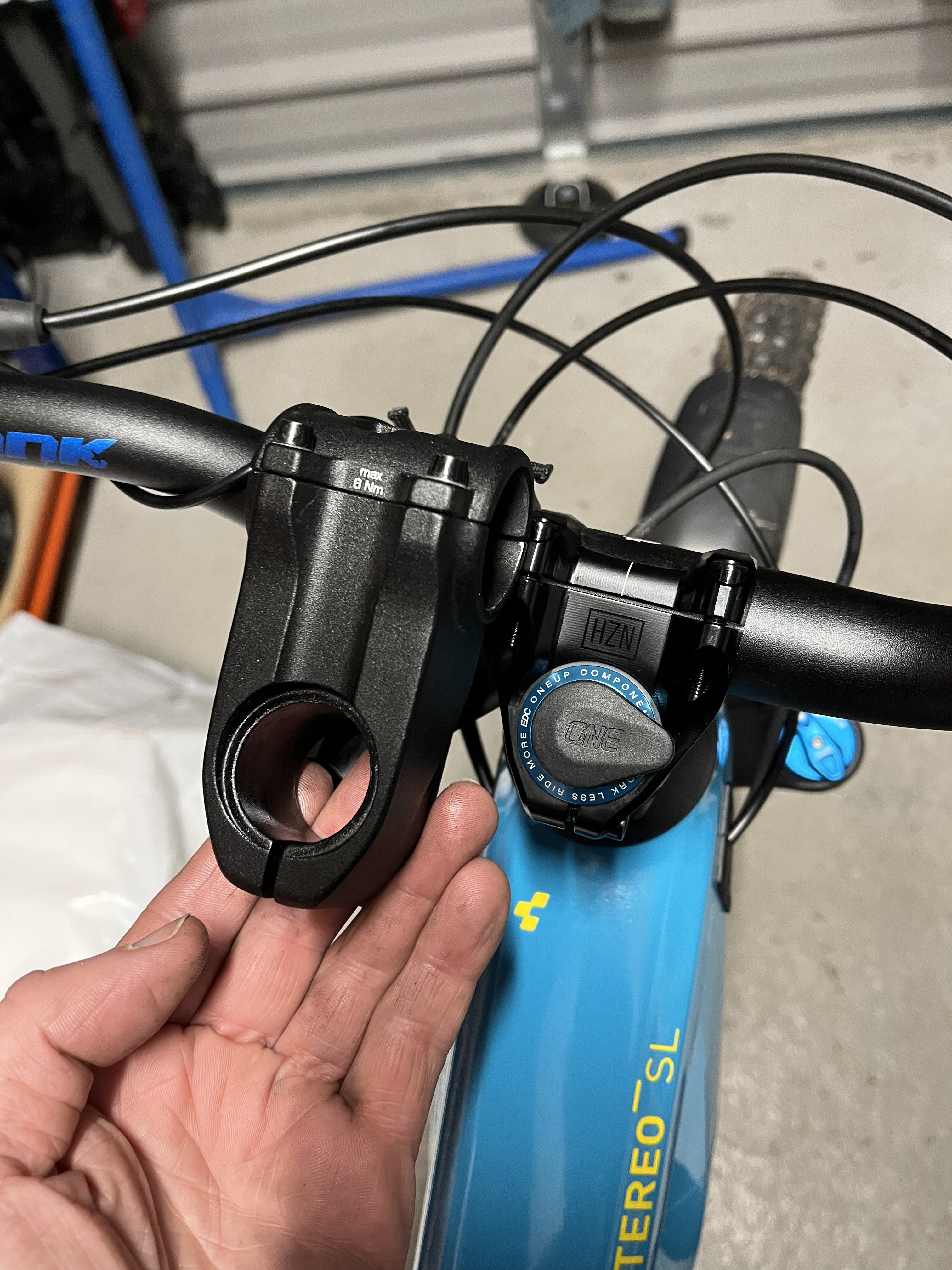

Just a visual on the change of stem

Cheers mate, yeah I guess a bit more effort on climbing to get the weight forward but should be nice for downhills.
