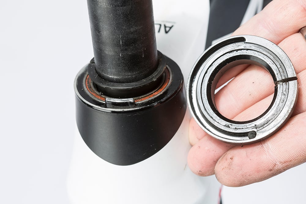

I may be wrong but I believe the cubes steering lock is built into the headset a bit like the image below, so if thats the case whats possibly happened is your headset cup gas slipped round in the frame a bit.
Not an actual Cube headset, but I believe the Cube has something similar
RipGroove
Jun 3, 2022
375
188
Glos/UK
Some of the Cubes use an ACROS AZF-1035 headset that has the built in 120° lock, so maybe worth trying to find some images of that to give you an idea of what might have happened.

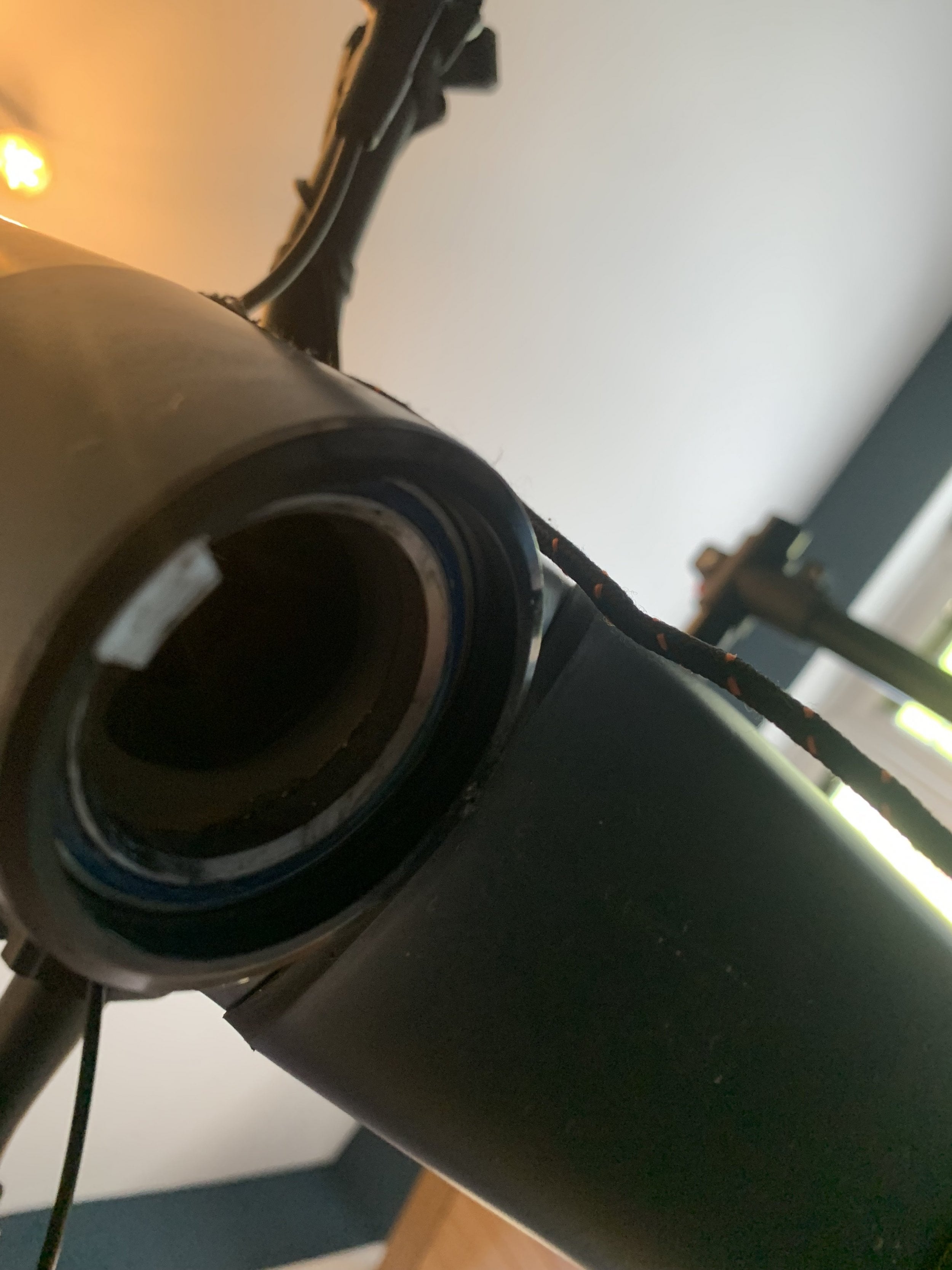

AndyS2
Jul 31, 2023
10
sheffield
I had the same problem the other day after a minor off, its easy to fix. Mine looked like the picture in post #5, so take the pinch bolt out of the stem, remove the handlebars and let the forks drop down to expose the bottom of the stem, the lock stop ring is just pressed onto the stem, so I just used a small pin punch to tap it back round until it was central.
