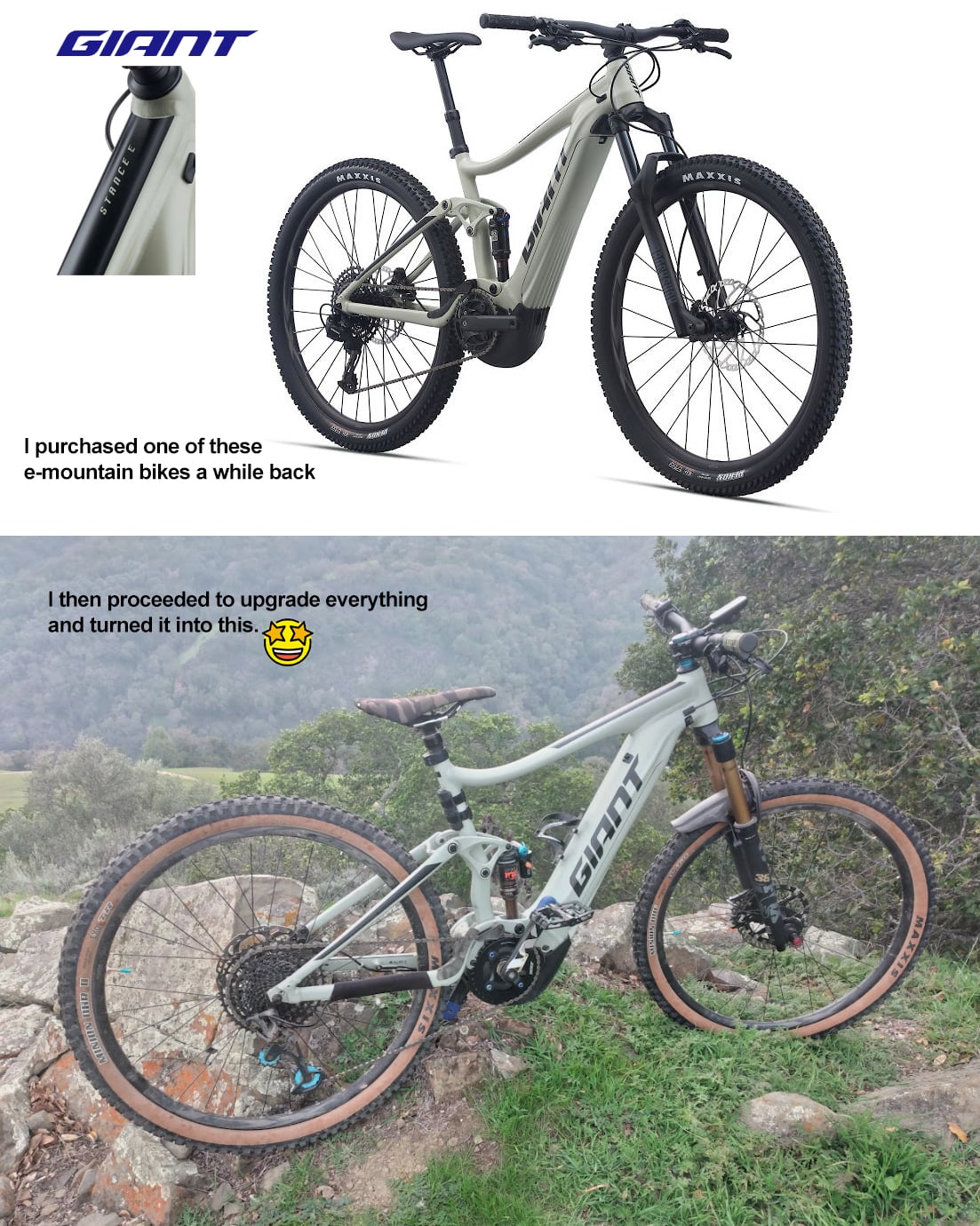

new to the forum...posting my ride. swapping out the Thompson stem for a Diety with a bit for rise w/new bars and some ergon grips. Other than that I think she's good for a while. stay well, ride hard!
zeKe
Jan 14, 2022
9
17
norcal
Nice upgrades. What is your primary use for the bike? How much money did you put on it?
I pretty much ride trails. However, I do have a de-regulator chip. I turn it on if I'm riding surface streets and it'll allow full time pedal assist (past the 25mph US reg). This is rare so it's usually turned off.
Upgrades:
fork (Fox 36 Factory 41mm offset; +20mm over OEM which were Rock Shox Recon Silver)
rear shock (Fox DPX2; OEM was Rock Shox Monarch)
rear mech (SRAM X01)
brakes (Magura)
brake rotors (202mm floating Magura; going to upgrade front to 220mm)
stem (Thomson; replacing with a Diety)
handle bars (Diety)
seat (Diety)
grips (Ergon)
tires (Maxxis Minion DHF DHR)
chain ring (Shimano Zee)
cranks (SRAM OEM)
SpeedBox 2.1 derestrictor
bunch of little stuff (ex. bolts, spacers, SRAM pulleys, valve caps, thru axels, front fender, etc.)
Basically, I just needed something to use as a canvas to put what I wanted on it.
All of that is probabaly just shy of +$3000. Pretty much the only things that are original are the wheelset, dropper post, chain, gear cluster, and bottom bracket). I'm thinking about taking every I removed and building a dirt jumper or something.
Oh, I also have a Garmin 830 computer with live tracking and auto SOS notification via txt w/GPS location....just in case I crash! :-|

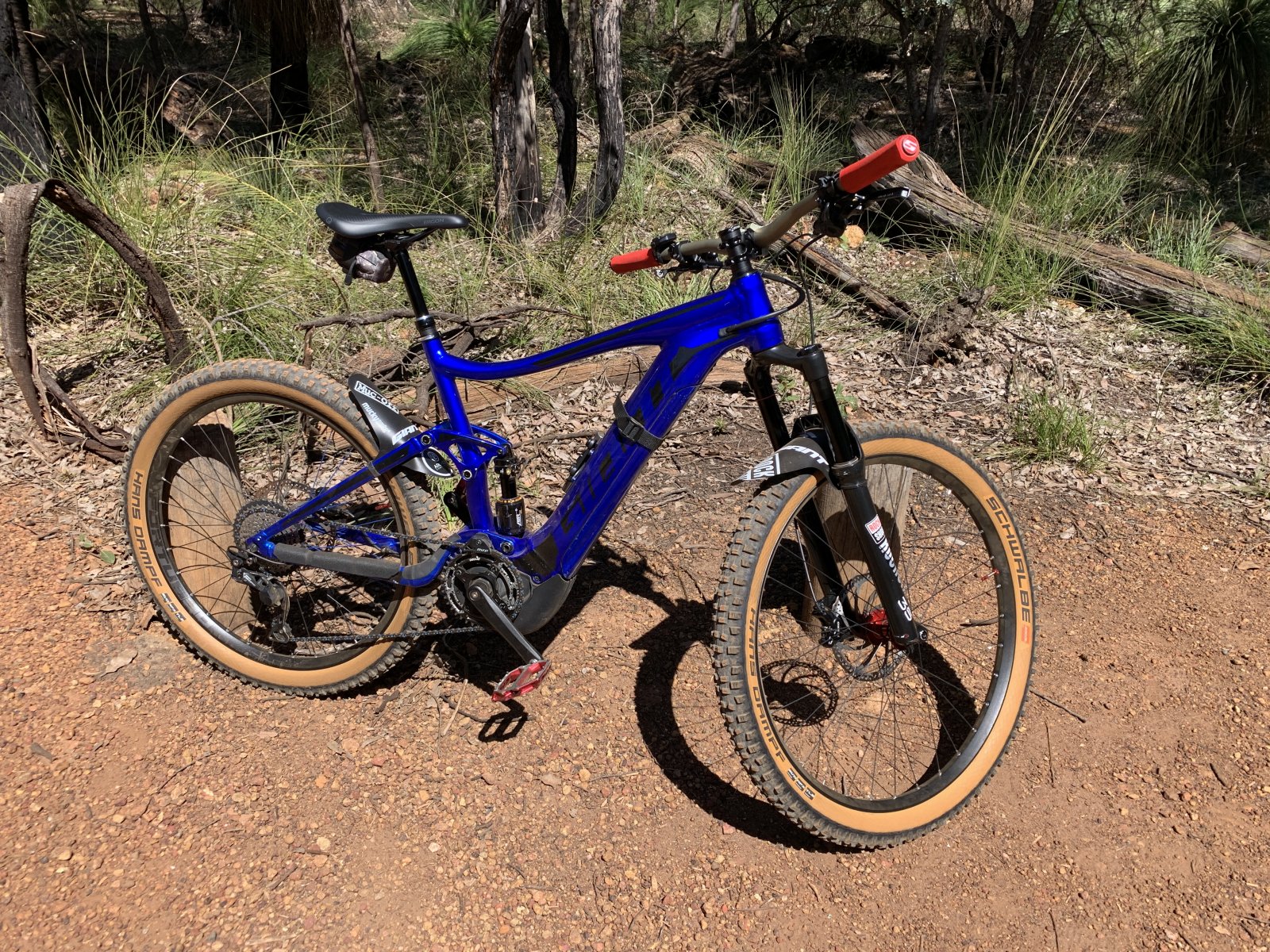

I did the same with my Giant Stance E2 2020. Purchased it and rode it for a while.
Then over time I personalised it and upgraded things on it.
Upgrades so far:
Speedbox 2 Derestricted
Archer components Wireless shifting
Rockshox 35s forks 150mm (29, up from 27.5)
Cane Creek Double Barrel Rear shock
Hope Fortus Wheels 35s - Pro 4 hubs (Mullet - 29 upfront 27.5 rear)
Schwalbe 2.6 tyres
Giant contact switch dropper
Ergon E saddle
Renthal bars and stem
Garmin edge 830 mtb
Nukeproof Horizon Sam Hill Pedals
Fidlock water bottle
Trance Chainring Spider
40T Chainring
KMC DLC Chain

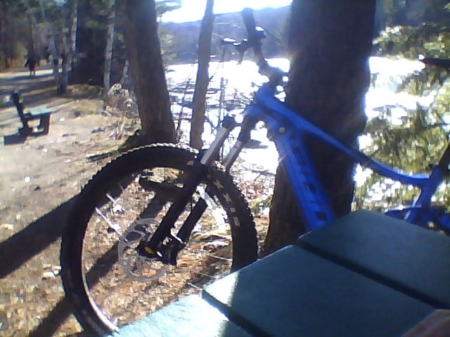

After 11 months with my Stance E + i sold it almost the price i paid.
Here in Quebec there was only one version, 400Wh.
I bought the 2021 Stance E+ now i am on 29, i have 500Wh and the main thing
the medium was a bit too long with 29 so i love my small frame.
The high demand make it the time to sell. I also sold 2 other bikes so my
fleet is younger. For our winter 400Wh was a bit small.
