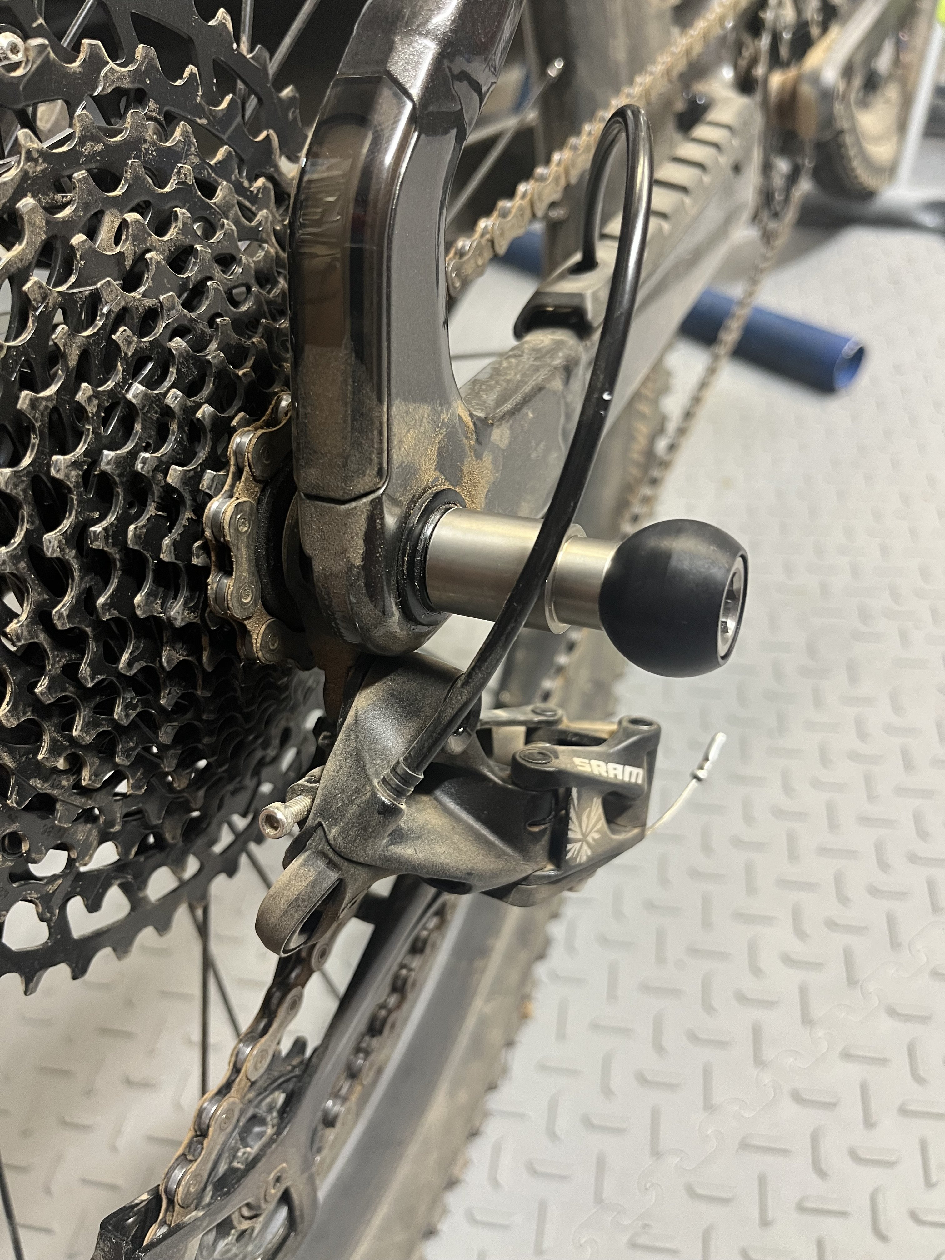

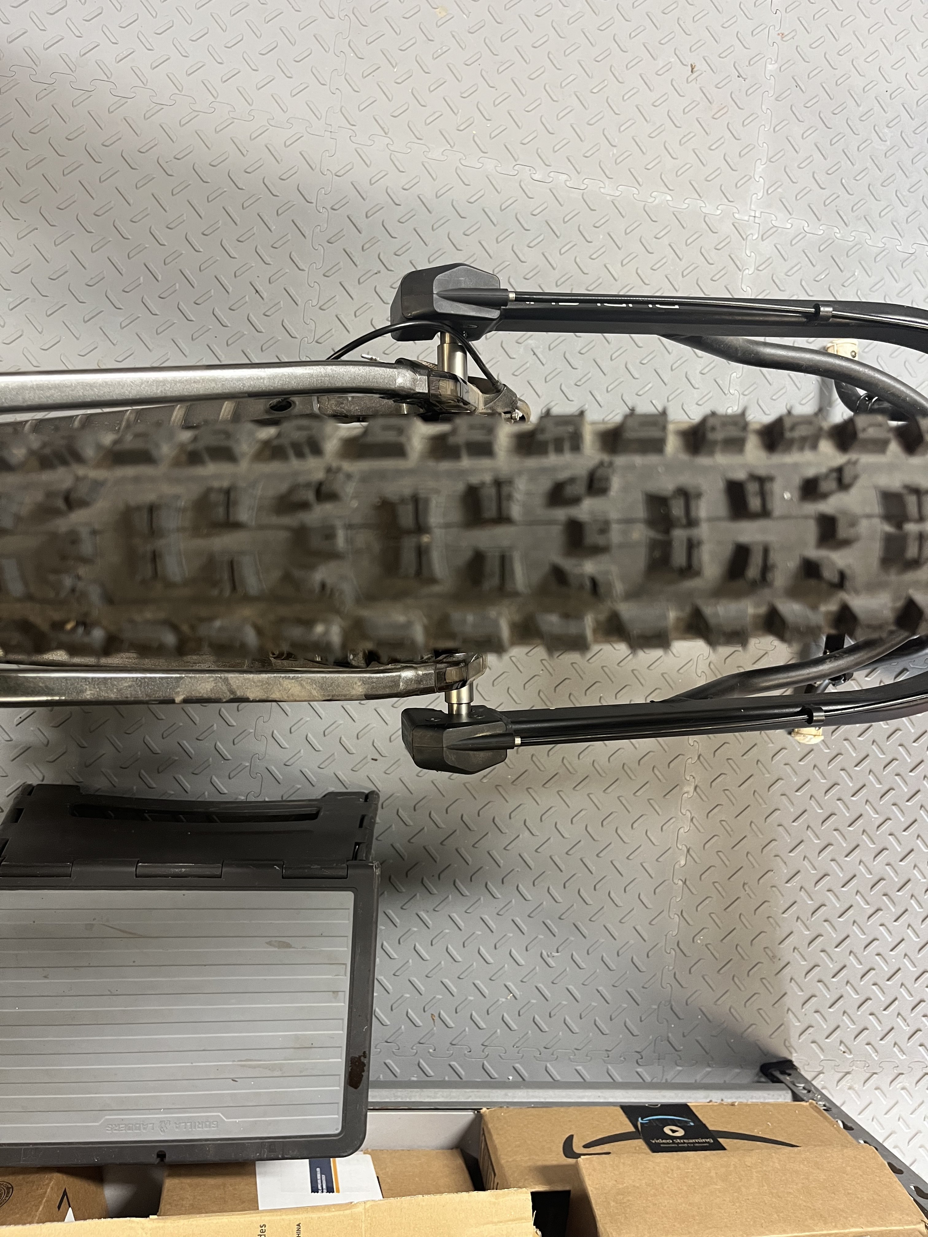

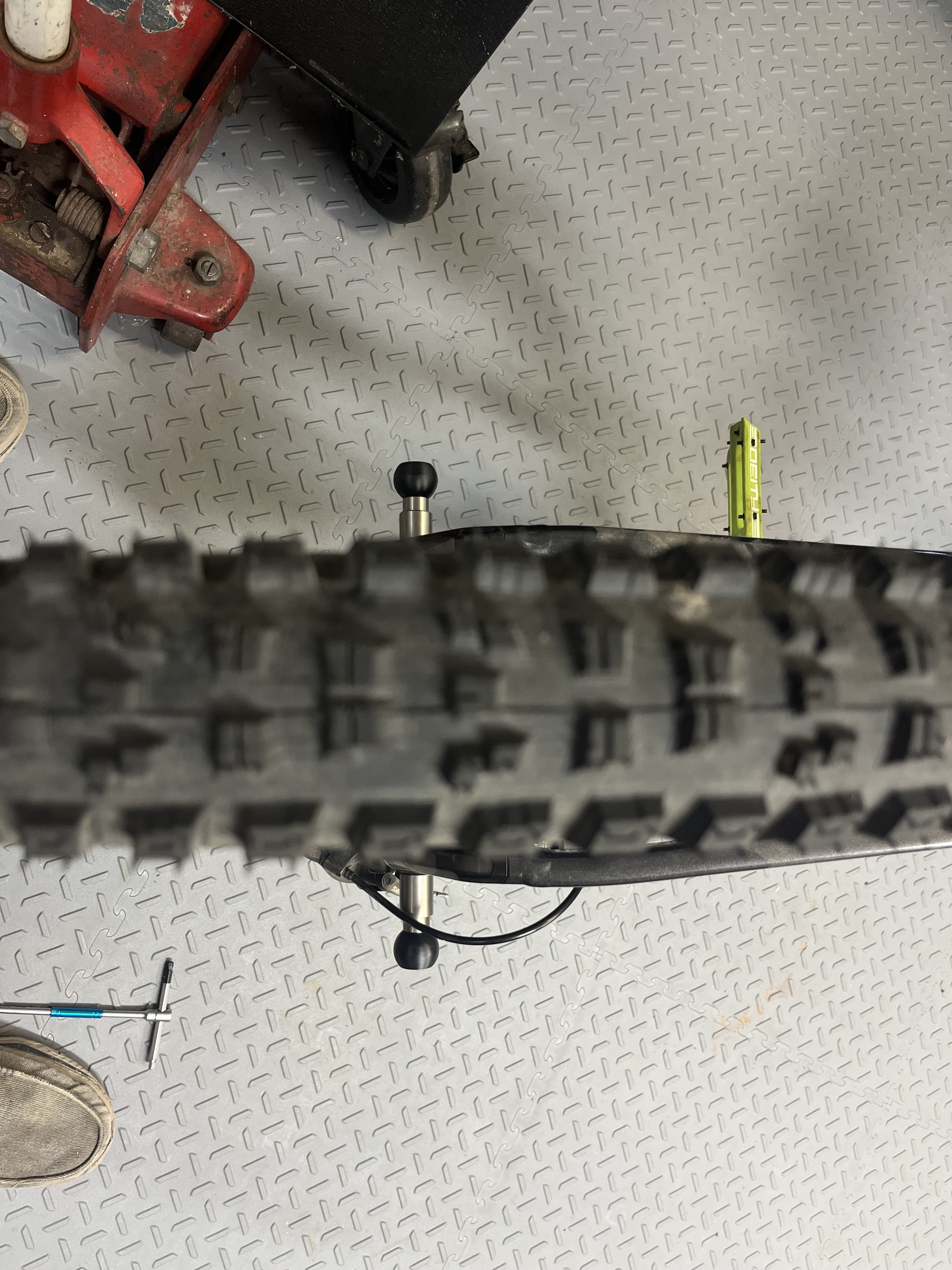

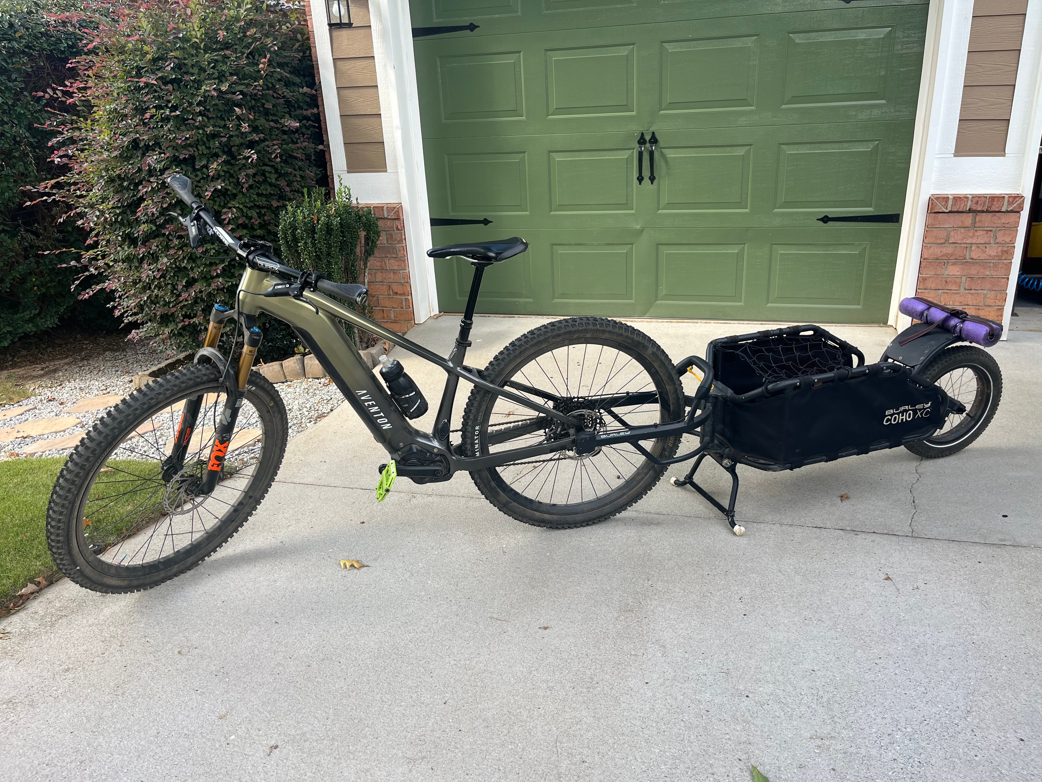

I bought a burley coho trailer and the double ended through axle needs to go all the way through. The UDH hanger is capped on the drive side so the trailer through axle can’t pass through. Any one found a solution for this?
my hack would be to drill out the cap on the drive side so the burley axle can go through.

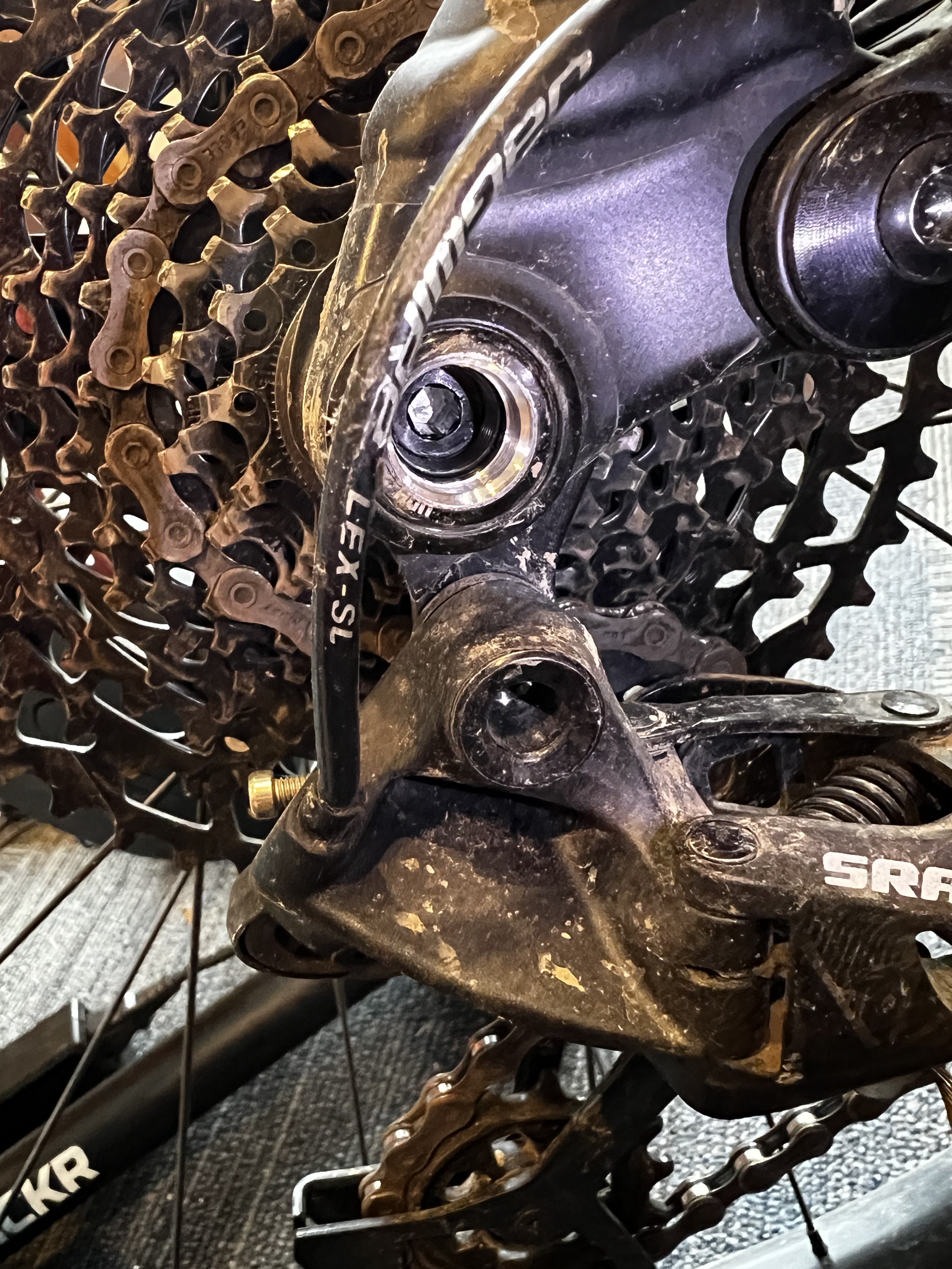

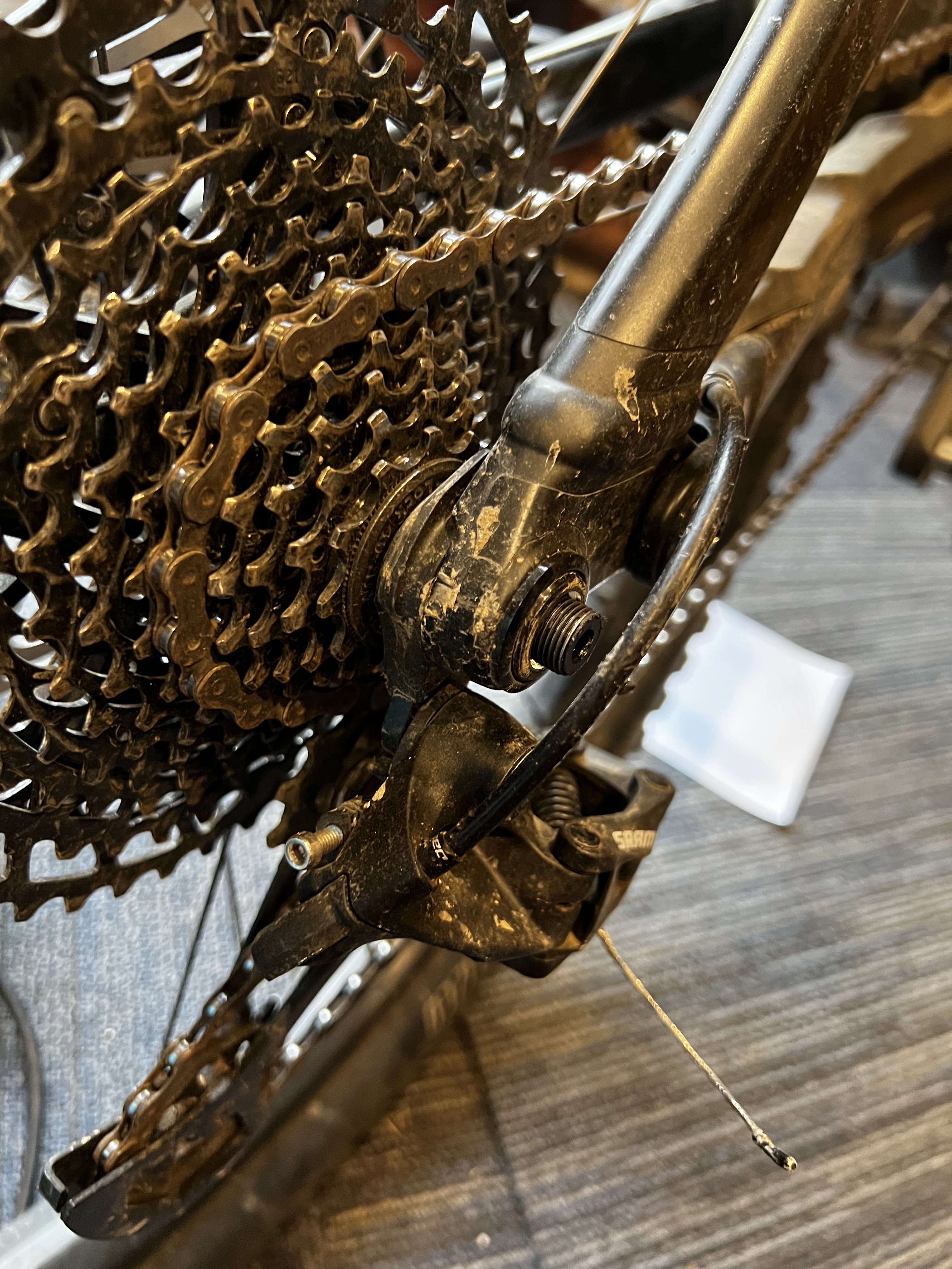

Burley replied to an inquiry saying they do not currently have a solution for the UDH hanger. I made it work by drilling a 5/8 hole in the UDH nut to pass the throughaxle through.
I realize that this will make the axle nut difficult to take off. And probably unusable after the fact. But if I’m taking it off the hanger is probably bent anyway.

I’ve got the same issue! Do you have any way of taking the UDH off now if you’ve drilled through the cap?
Savan
Dec 16, 2021
44
Iowa

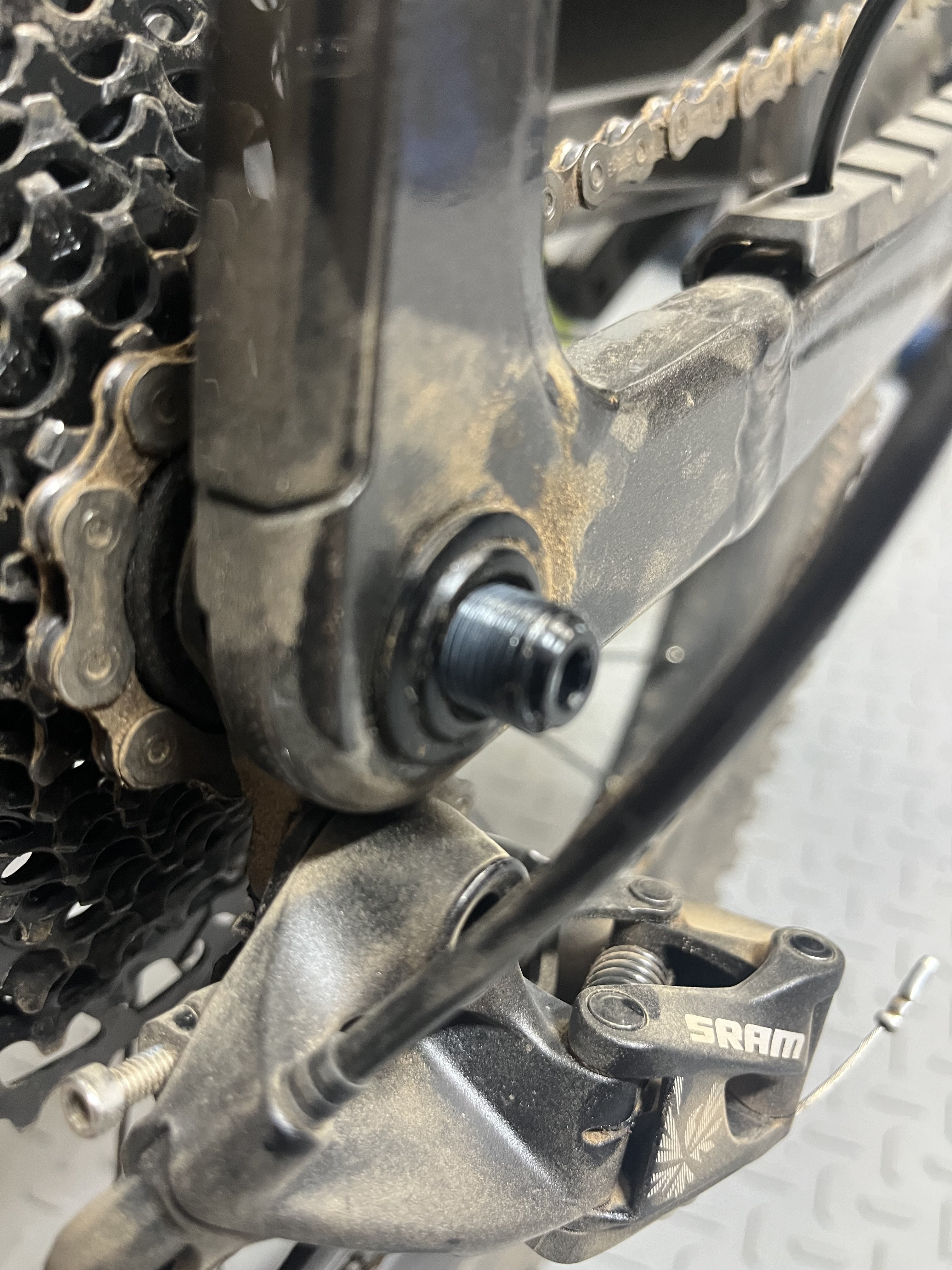

Hi Jim, I haven't had to take the hanger off yet. You can see in the attached photo what I'll be dealing with tho vs what it used to look like. This can't be a field repair so i'll be screwed if it happens on the trail. But, I plan on using something like these screw extractors to reverse it out.

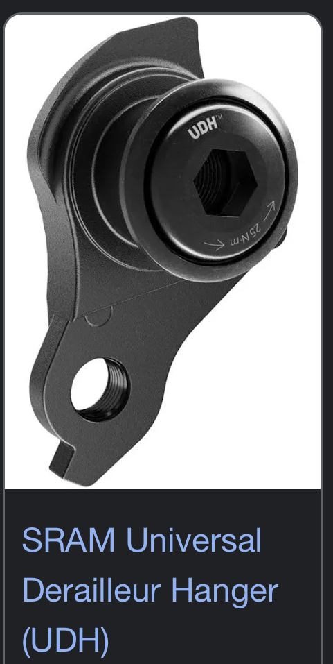

Here's a photo of what the udh looks like if you've not had one apart before.

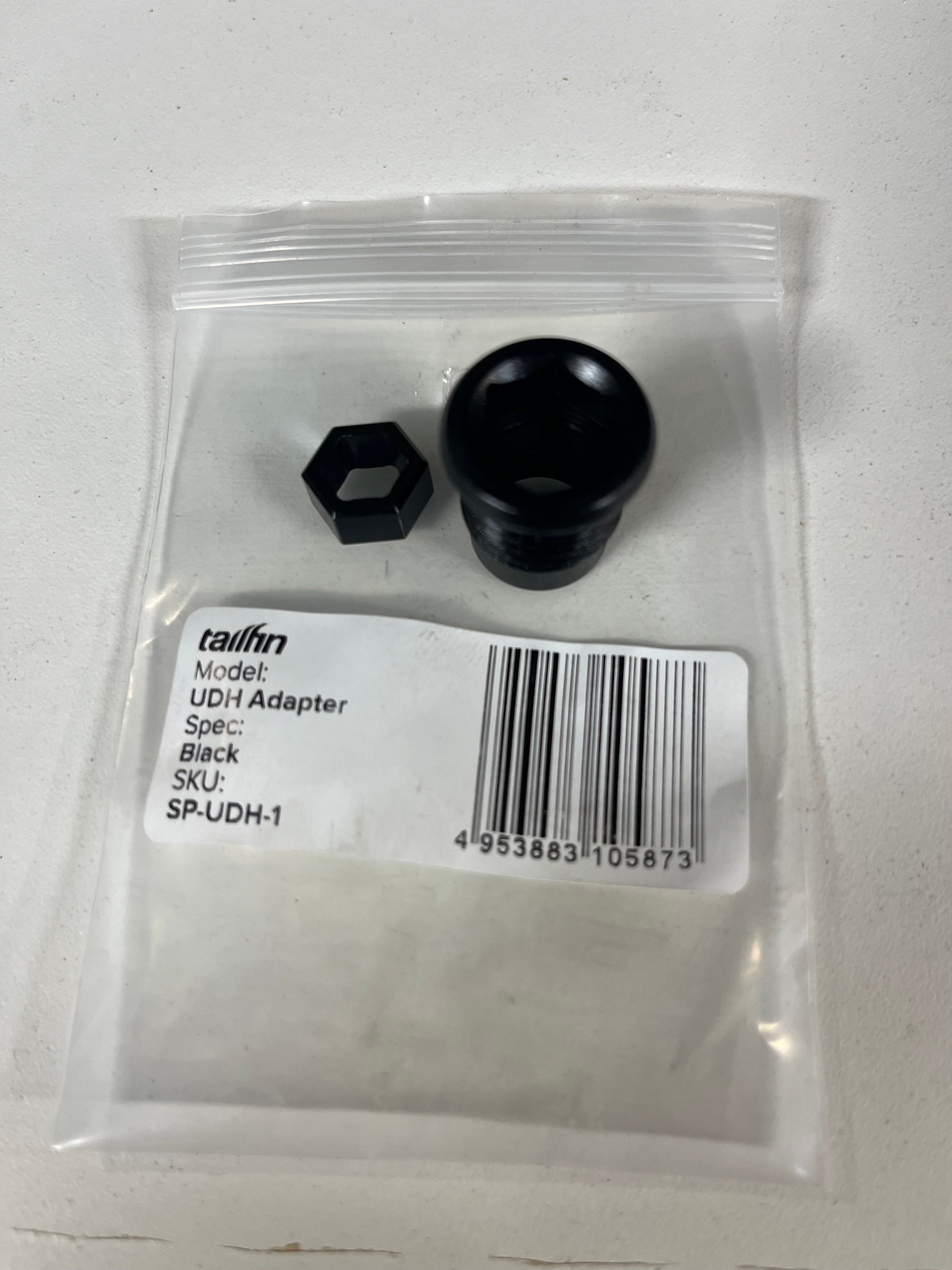

Savan
Dec 16, 2021
44
Iowa
hah, that is way better. looks like they created that to solve the problem for their own custom through alxe.
great find!
Helynt Melyn
Jun 14, 2021
9
Tregarth
Thanks for finding that adapter and sharing the link. Just ordered one. Now I’ll be able to use my acoustic Stumpjumper with the same axle I’ve got for my Levo.
