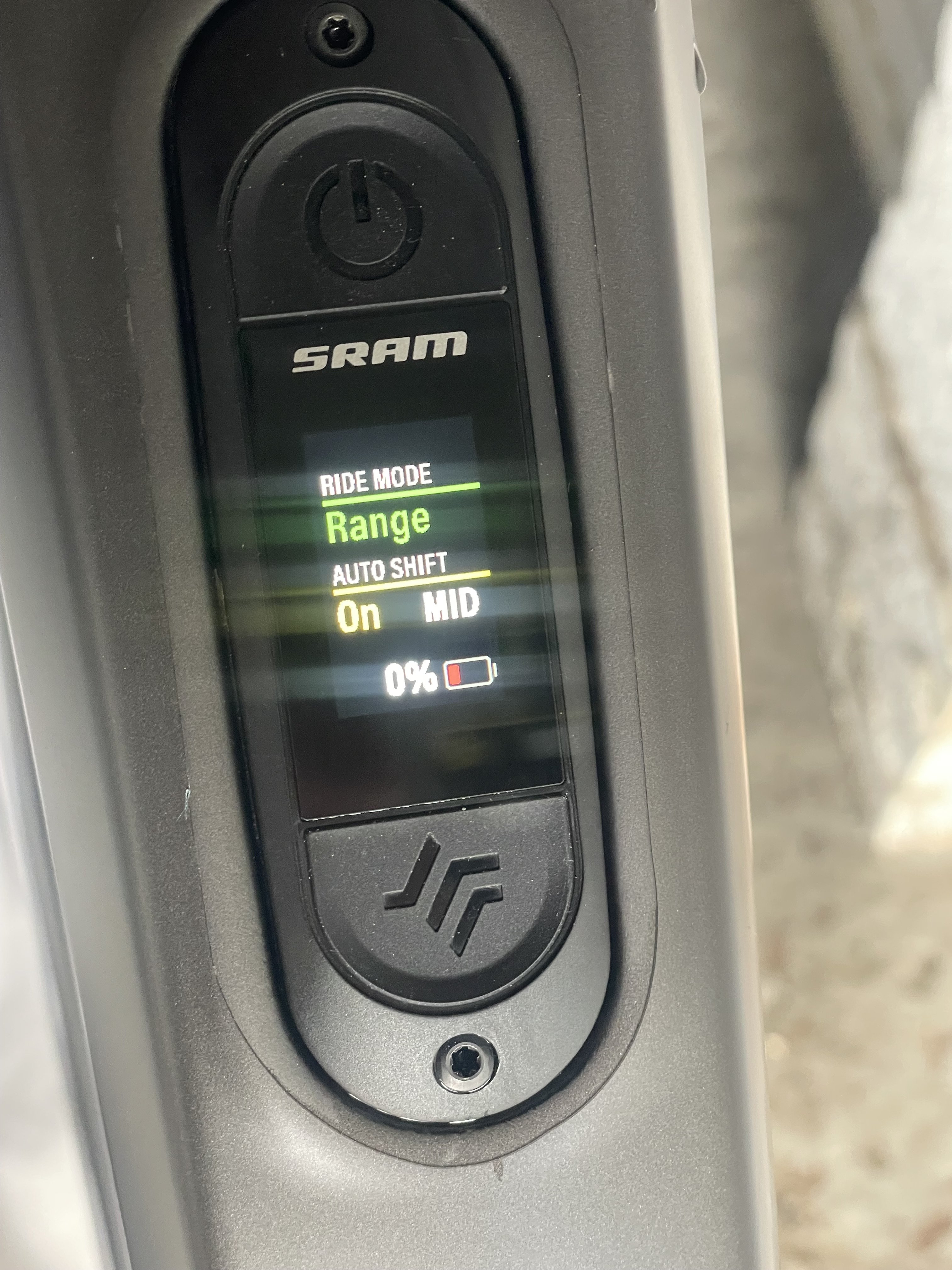

I’ve got the same problem with mine. Fitted a new motor @100 miles. Now it won’t turn on. Great bike when it works. But this will be the 3rd time it’s gone back and only done 300 miles total. Not good enough for a ten grander.
Paulh9848
Apr 14, 2024
England

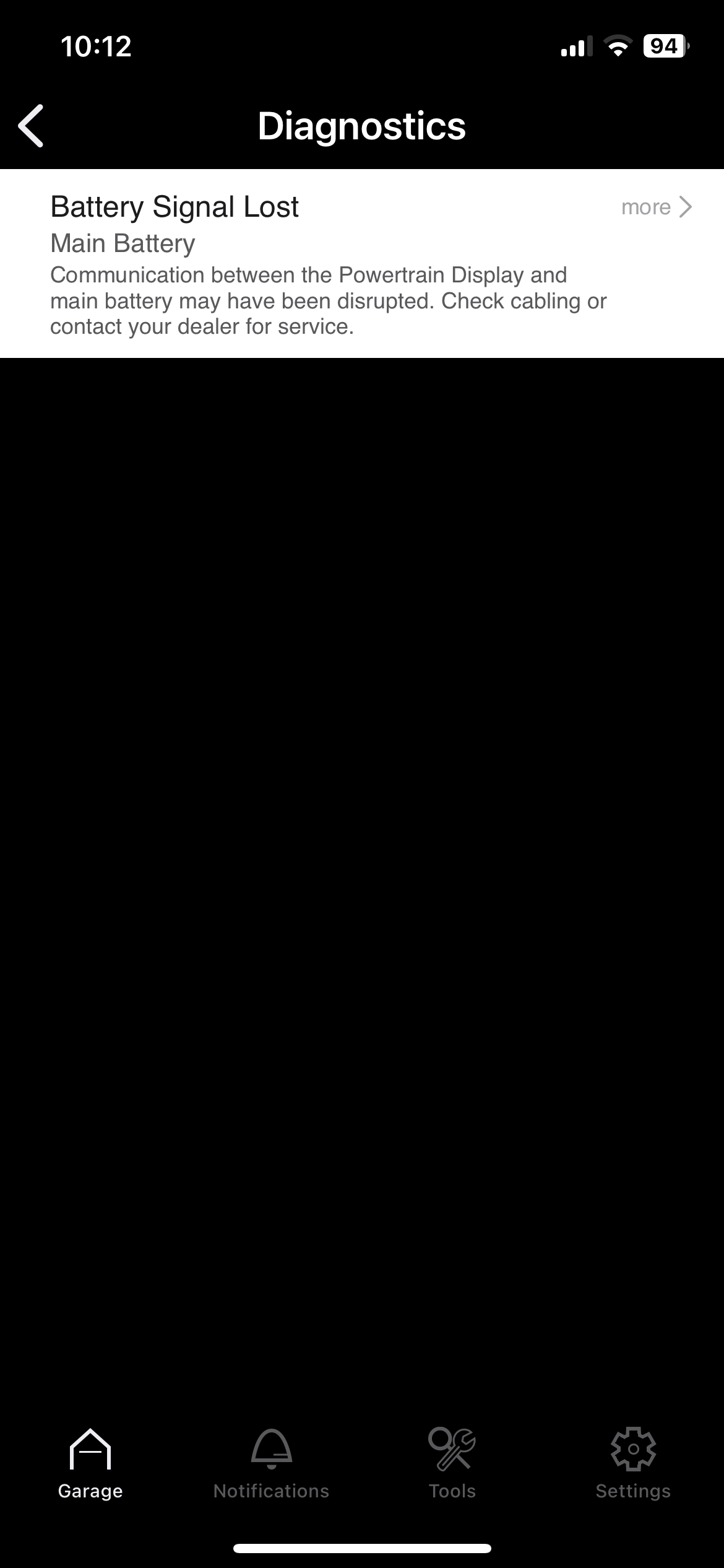

I continue to have intermittent issues with battery signal loss errors. Power up sometimes just flashes logo and turns off. SRAM has another wire harness they want to try. The last harness lasted 500 miles and started crapping out just like the first. I love the bike when it’s working properly but my patience has been tested and if they can’t get it sorted out soon I’m going to have to do some buyback with them as it’s too iffy whether or not I’ll get a good ride in. I don’t think they tested production units adequately before release. I’ll keep ya posted of any updates in this thread.
Thanks for the quick update. I hope SRAM sorts you out. Keep this post open and let us know, very curious about customer service as I have only engaged with the LBS and my own off hand "fixes". Agree that the bike is amazing when it runs without an issue. Sigh.

They sent the SRAMbulance this time. On the first harness replacement, the local shop monkey did not apply dielectric grease on the connector to the battery and according to the engineers in Germany, the dry connector is prone to fretting on the pins and sockets after 500 miles or so. This time the expert changed the harness and lubed it properly. It’s been agreed with SRAM, should this issue arise again in the future, they will facilitate a return / refund with Transition. They (SRAM) have been very responsive and helpful but understand that a bike this expensive should not be giving this much trouble. When the drive system is working properly, it’s amazing and I would hate to give it up but there comes a time where ya have to cut bait and run. Hoping it does not come to that but only time will tell now….

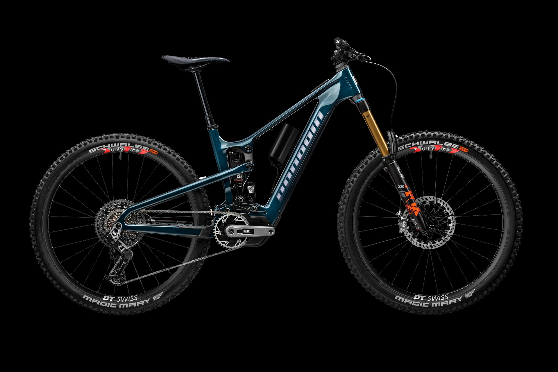

hi!
i've owned a propain ekano cf in march this year (sram powertrain). german direct seller, so no dealer support for me. have 1800km so far. had several battery errors that i could fix with taking the battery out and in again. sometimes short time loss of motor power, wich was improved with the update 9.2.2. i love the bike WHEN IT WORKS.
a week ago the motor seems to be broken. in rally mode (with max torque) the motor supports and then turns up and the torque goes down. this happens 2 or 3 times and than the display shows error. "restart ebike" or "service required". i contacted propain and sram with not much success. it seems to be not so easy to jump into the "next level support" at sram. does anyone here have a direct contact at sram?

update:
received the bike wednesday and had a ride yesterday - world is perfect again. new motor. propain took just two days for replacing the motor (THANK YOU PROPAIN, honestly), so the already have spare motors. dhl took from wednesday to wednesday to deliver it back (argh). service hotline propain took nearly a week to get me to the right person that told me to send it in. dhl from me to propain took 4 days.
the fastest way to get the motor fixed is to send the bike to propain and you get it back with a new motor in aproxx one and a half week if everyone is doing his job. next time... and there will be next time...
sram are you listening? introducing a "new" motor with this level of engagment is just not enough. if you're serious with ebike please do your homework and train your dealers. i understand that it is not easy, but if you dont do that your "service-net" is just marketing-bla bla :-(. at least you should have an overview wich sram-dealer can do a diagnose to help your customers! this diagnose-dongle is just 200€
