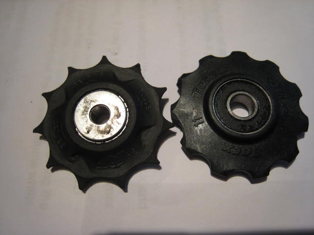

after 6 weeks of ownership from brand new my SRAM GX11 jockey wheels are seized solid and are clearly a pile of shit.. I have stripped and cleaned the bearings before packing them with marine grease to get me over the Christmas period but that will be a regular thing for me unless I replace them so...
judging by my experience I imagine many of you have already been here so, what did you replace them with?
straight away im thinking HOPE but all suggestions welcome.

I have the sram x1 jockey wheels, and I've been very impressed, they have been on the bike over 4000 miles and are not badly worn and have never seized.
Don't know what difference is between them and the gx11 ones?

No issue here, fine since August.. but a quick search suggest just getting NX version* and do away with bearings or replace the bearing in your current set with 626rs bearings. Otherwise Uberbike do some for £30..
*you've prompted me to buy some, as not being able to ride due a failed cheap part is rubbish

Amazed to hear they last at all, these are mine after 6 weeks and around 15 rides

This has happened to me twice, both times at the 3 month point. First time put on Hope 12 tooth ones, still sound after 3 years, second time Superstar Components, first ride ok. Next time I get a SRAM rear mech I'll swap the jockey wheels straight away and keep the originals as a spare.

Two dirty rides on my brand new gx drive train.
Got bike out of garage today and both jockey wheels seized solid.
Freed them up and re greased, hope this is not a regular occurrence

That looks like water damage, are you using a pressure washer? I’m still running the same jockey wheels for over 1k miles on my GX11 rear mech, including through our lovely British winter.

Oops, missed that bit. I went for regular bearings on the premise that the seals are the same on both, and the weak point. A point to watch on the mech, by the way, is the pulley wheel that the cable goes round, it is prone to getting sticky but is dead easy to take apart and clean. Just take some photos first so you get it back together the same.

I have worn out the teeth on jockey wheels, but I have never had any seize up on me. Maybe it is because after every wash of the bike, I use the thin straw on an aerosol can of TF2 teflon to spray into the jockey axle. (Just don't let overspray get onto the brake disc).
