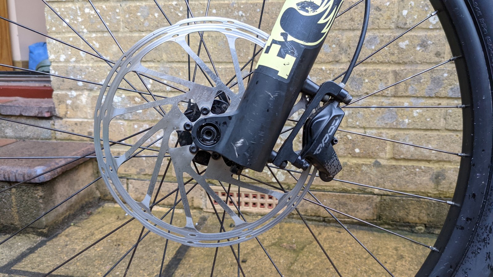

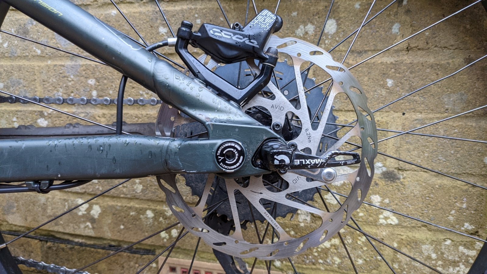

The ride in the Quantocks yesterday was cut short - firstly by one of my mates breaking his mech hanger (same bike as mine :oops:), then by my other mate losing pressure in his shock which, when we tried to pump up, found it had blown a seal.
So not a real test of the brakes, though - having cleaned out the pistons & recentered the calipers - I got the feeling there was some improvement. Just waiting for the Uberbike matrix pads to arrive now.
One thing I noticed whilst fiddling with the calipers the other day was that the rear caliper had a washer between it and the mount, which is a bit unusual. Also, the rear pads had a thin, unused lip along part of the tops, meaning they're raised beyond the rotor by having the shim/washer under the caliper. I refitted the caliper without the shim and found it was then fouling the rotor! I then realised the rear isn't the original rotor and is different to the front rotor, albeit still an Avid 200mm (see photos). In the end, I had to put that shim back between the caliper & the mount, but it ain't right. Maybe the new pads will align better with the rotors? But I wonder if the rear rotor is measuring larger than specs. The mount is the correct Whyte mount for 200mm rotor. Weird.
The rear rotor looks a little burned and the front rotor looks pretty scored, too.
