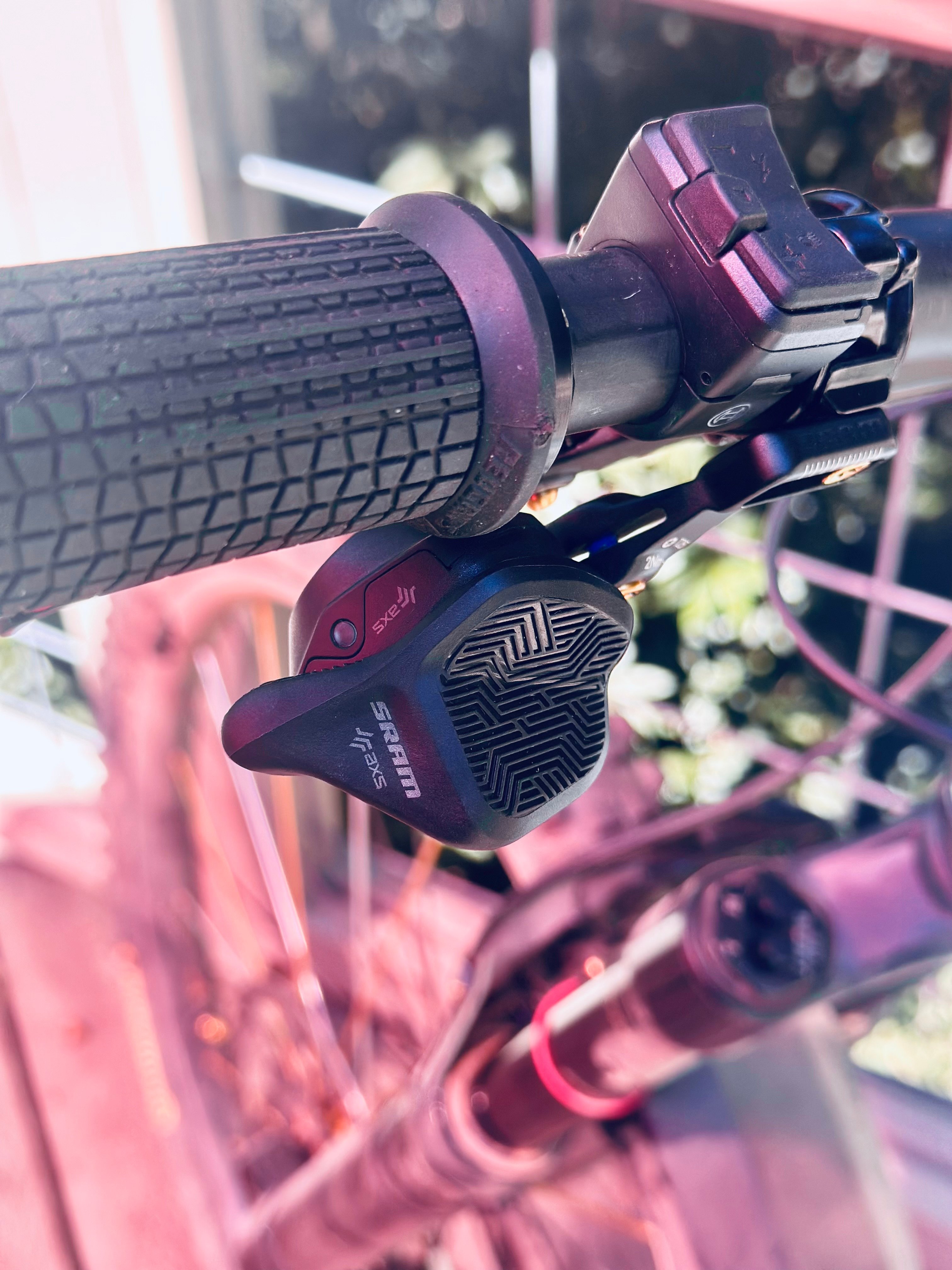

Installed mine today and I REALLY like the feel and function of it over the Ultimate pod buttons. I only ordered the left side because all the right side rocker paddles are on back order everywhere I’ve searched……once again, another waiting game for a bicycle part.

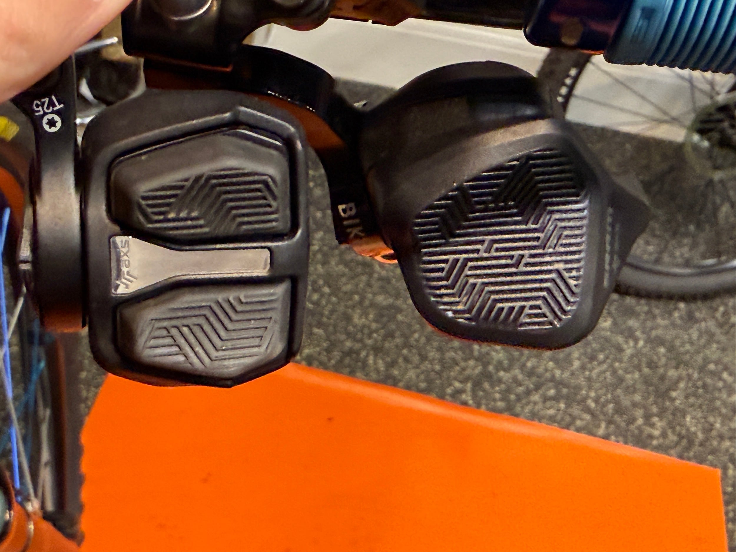

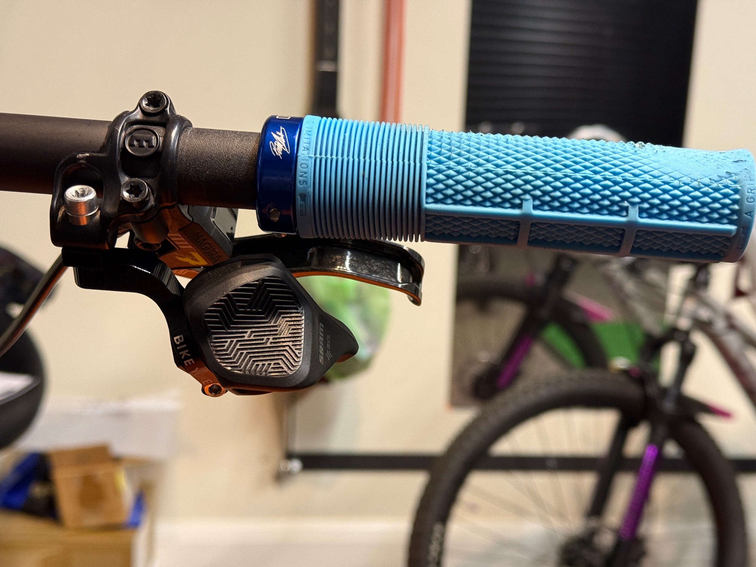

POD rocker on the bike with the BikeYoke and Magura matchmaker combo.
POD rocker vs original 2 button POD.

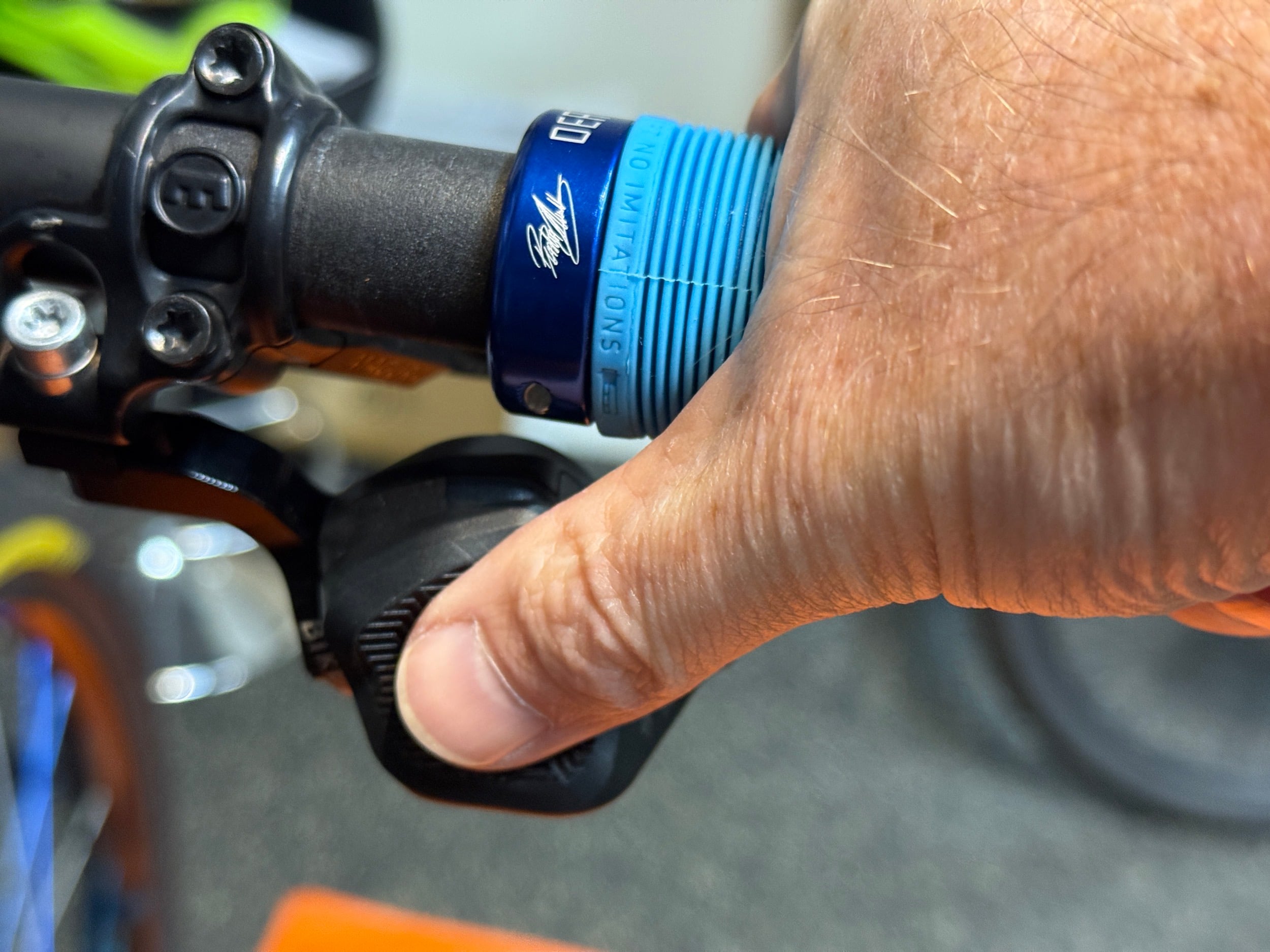

Correctly placed - my thumb sits right in the middle of the rocker without any stretching. A pretty natural position when I lower my thumb.
Index finger reaches the ‘trigger’ without moving my hand position too. Perfect! 👍
