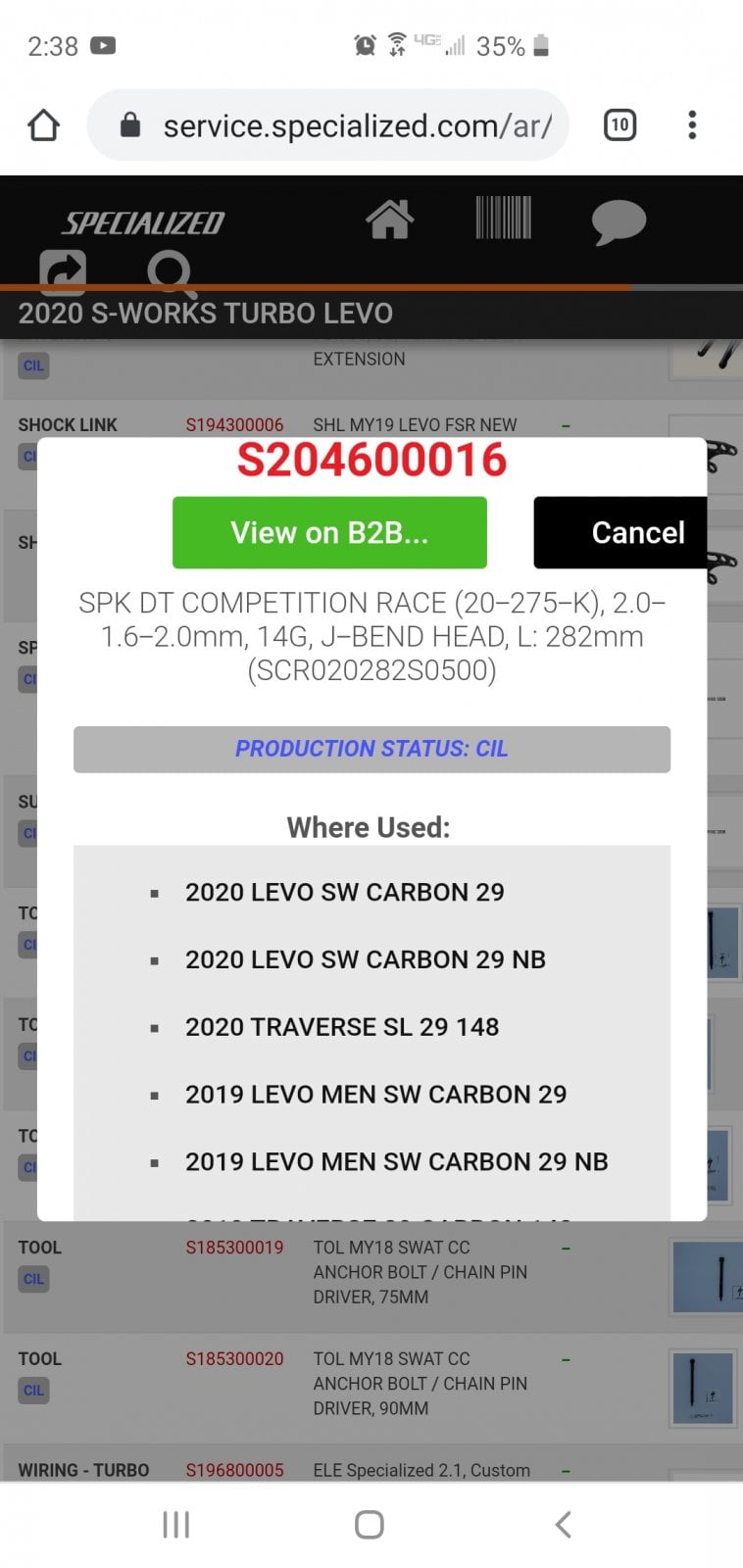

Swan
Oct 19, 2019
87
122
North Idaho, US
There is the part number for the spoke.. As mentioned earlier, it's a standard 282mm DT Competition Race spoke that butts from 2.0mm down to 1.6 and back to 2.0mm.
We don't usually keep those super butted spokes in stock at out shop, but keep 10mm increments of the 2.0mm-1.8mm -2.0mm ones in stock that we can cut down those to the exact length we need.. A good quality shop should have a replacement for you or at a minimum have a straight gauge spoke to keep you running.
And I would place a large amount of money that your wheels are not using brass nipples.. Unless Specialized started doing that recently, pretty much every Roval wheelset I can remember has come with alloy nipples and not brass... And as Gary pointed out, alloy nipples suck when they are a few seasons old.. I relace a few dozen wheels a year and replace the alloy nipples with brass.
Alpman
Oct 21, 2019
63
51
Annecy France
This is great stuff Mr. Swan, many thanks. I’ve added the part data to my maintenance files; I try and be as mechanically self-sufficient as possible. And if I can‘t do the repair myself at least it speeds up the process when I visit the LBS. And on closer inspection I think you are right - the fitted nipples do appear not to be brass. Fascinating stuff; whenever something breaks it serves as a nudge to learn more - and buy more tools heh heh.
