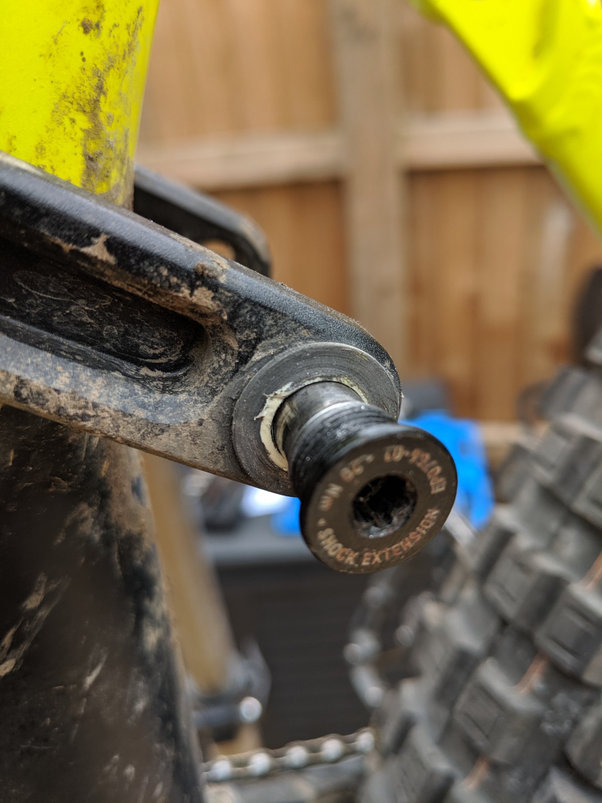

Hi I've had similar issues with my 8.0 as have two of my buddies who both have 7.0's. With all 3 bikes we have found that the plastic bushing is the item that is causing excessive play. The play is where the rear shock extended bolts to the pivot and is noticable when you lift the bike by the seat.
Canyon don't list the parts on their website but you can buy them by contacting canyon through the web chat. The item is part #10000068 (shown as Part #23 on the exploded parts diagram) and costs £2.95 for a pack of two bushes. Its relatively simple to fit although the old bush takes a bit of digging out and generally falls to bits in the process. In all cases when we have replaced them it solves the play issue immediately. With all our bikes this bush failed with less than 1000 miles on the bikes so I expect it will be an item that needs regular replacement. All the other bearings on the bikes are holding up well for now. See exploded parts diagram attached
390 miles on my 8.0, just noticed the exact play you are referring to. Cheers for this post I will contact Canyon. As they didn't last long and are relatively cheap I may stock up on them.

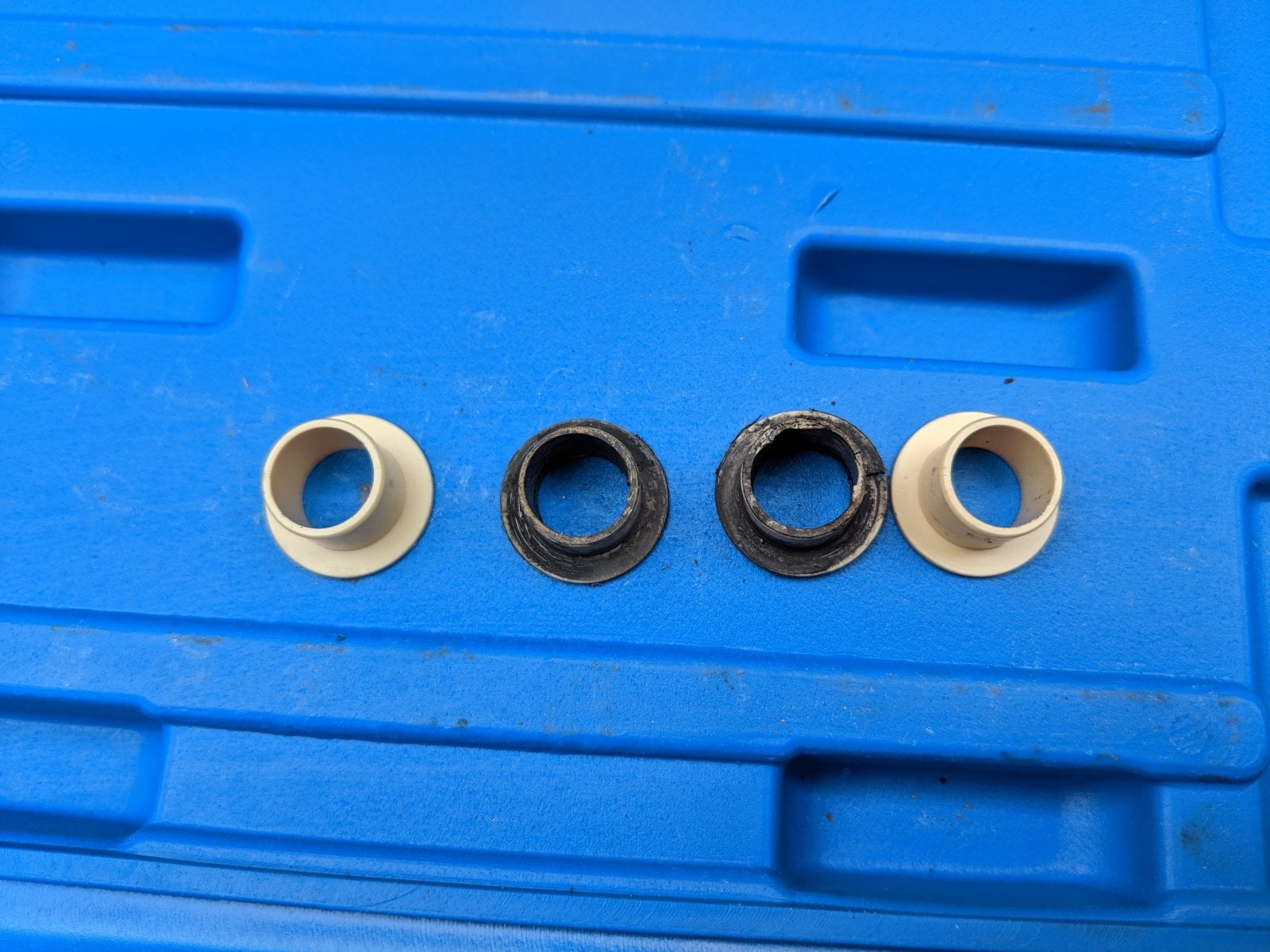

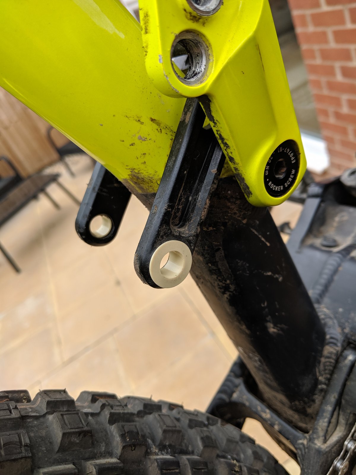

So I spoke with Canyon and ordered some bearings, the guy was pretty annoying and kept asking for detailed photographs. In the end I just gave him the part number and bought them. I think I will get some pictures and send them in anyway in the hopes of getting some spares. In total cost me about £12.60 including the £6.99 shipping :mad:
Edit: I was going back through some GoPro footage and I found where they failed. My bike didn't feel as sturdy after and at the time I thought it was the headset or loose spokes. It wasn't a nasty feature just a fairly big G-out at the bottom of a hill.
Edit 2: Happens at 16 minute mark. Wouldn't let me link at a specific time
Clansey
Aug 13, 2018
269
197
Liverpool
So the bushings arrived and I have replaced them. It's fixed the play so cheers! The new bushings were the same as the old ones so hopefully this doesn't happen again soon.
You can see from the images that the old ones were oval shaped.
