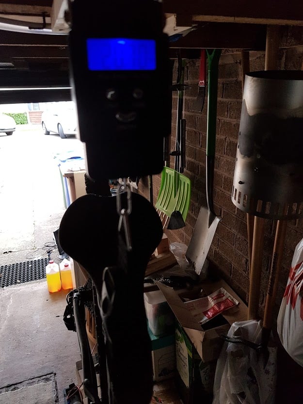

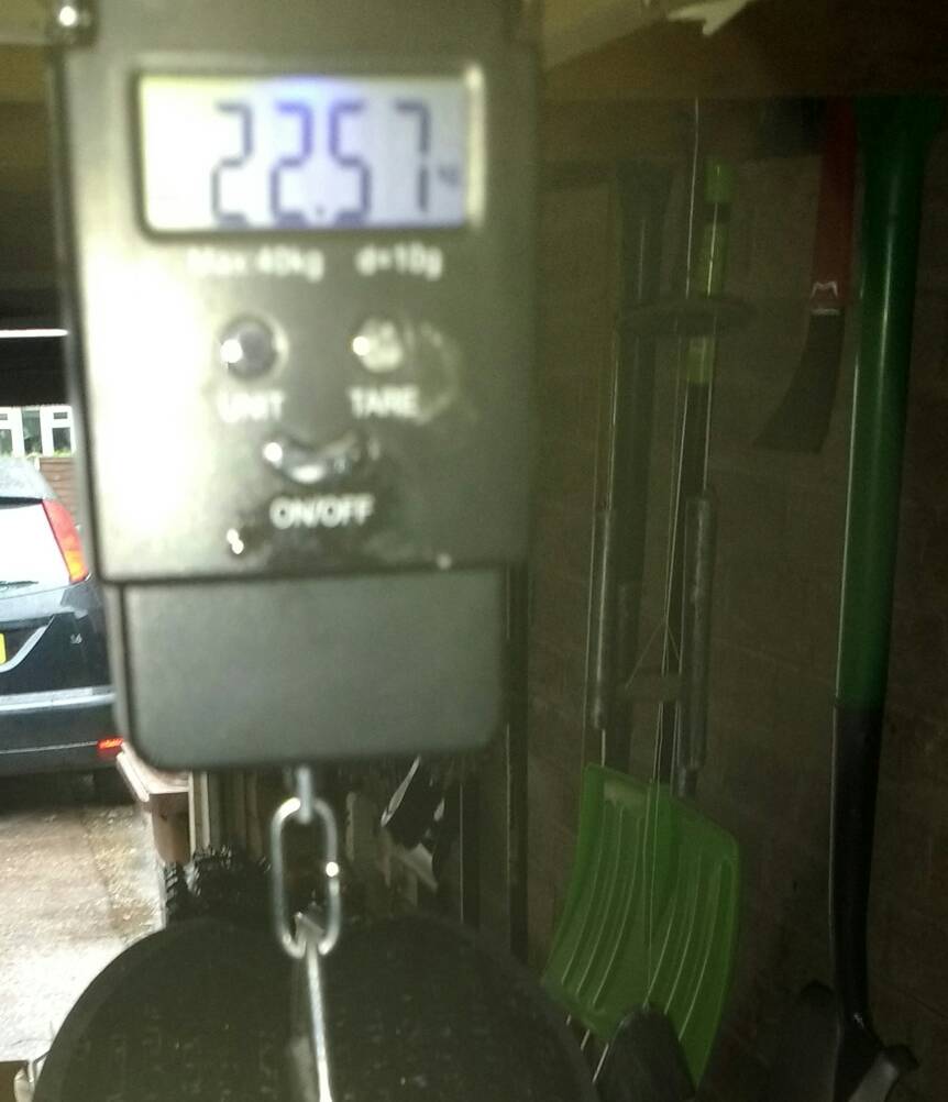

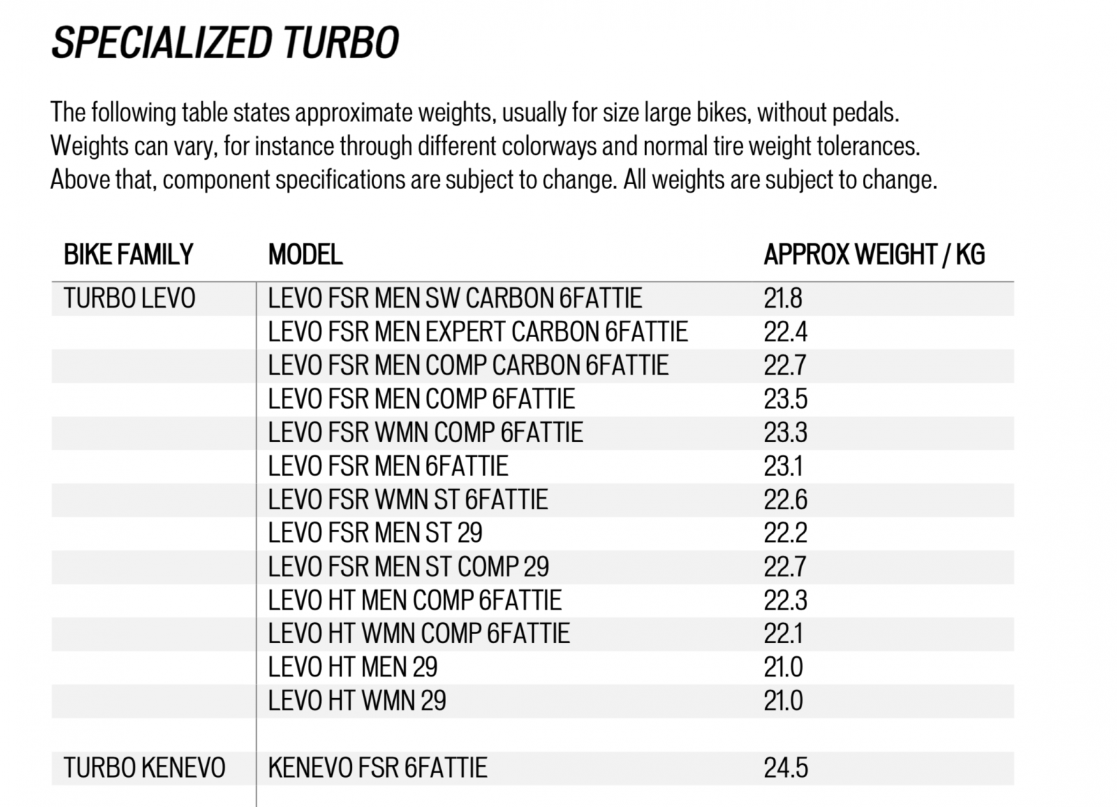

Posting it here so I can find it when I need to refer to it:

I also wondering how much this bikes weight without battery and motor.
In my rough calculation if battery and motor weight around 7 Kg, Levo carbon should weight around 15 Kg as normal bike.
Isn't that too much? where are those extra 3 Kg come from compare to a normal stumpy? :unsure:
Evo-L
Jul 13, 2018
FL, USA
Maybe larger frame, motor mounts, bigger tires and wheels, bigger brakes. Probably 3k, maybe more
9,190
This, everything is beefed up on an E-Bike, both to take the weight of the motor and battery, and also to cope with the extra weight and resulting abuse the bike dolls out to components. Just look at the weights of most of the tyres specced on E-bikes

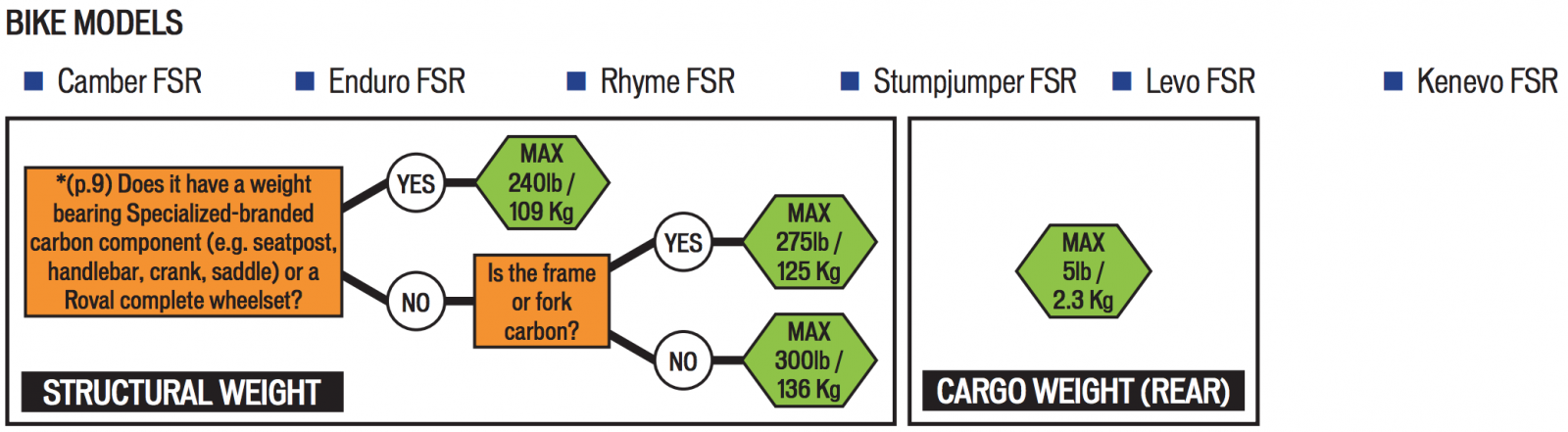

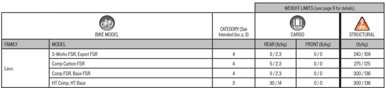

the max system weight would be interesting. i heard the levo comp has 136kg. but above the levo expert, sworks only 125kg. can anyone confirm? kenevo? thanks
edit: thanks to @eFat. i ve updated the weights above ✌?

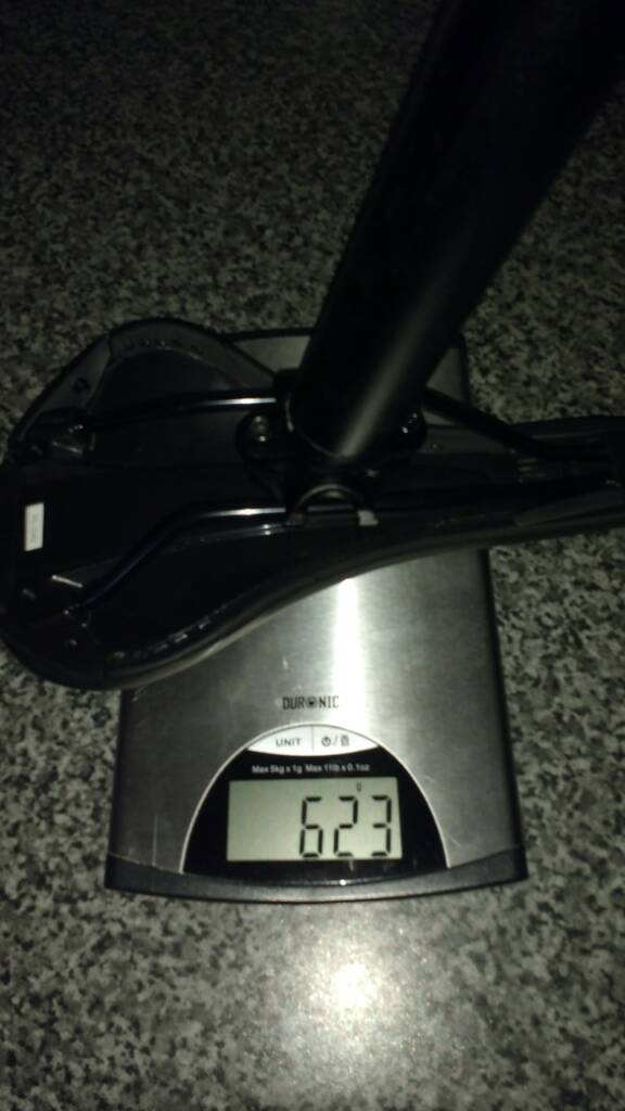

my kenevo expert 2018 size small, with seatpost rockshox reverb stealth 100 mm, rear wheel DT H 1700 30 mm., combo stem and handlebar renthal aluminium, front tire magic mary 2.6 apex orange, rear maxxis aggressor 2.5 dd wt, abs roc antiflat on every wheels, set disc brake formula c4, avs handguards, saint spd pedals, 24.540 gr.
