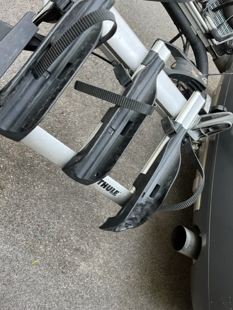

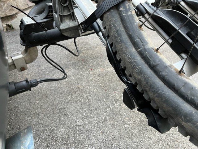

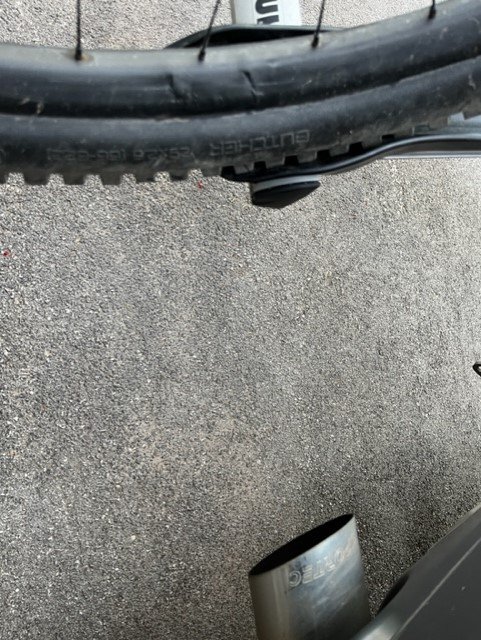

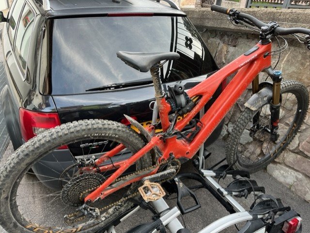

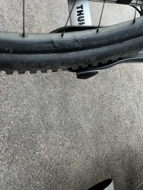

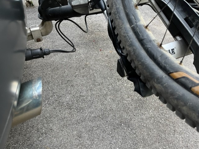

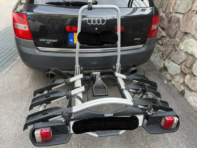

Last week I went biking together with @PaoloBLEvo in Italy. We had a great time but unfortunately also faced a big issue with my Levo Pro Roval carbon wheel set.

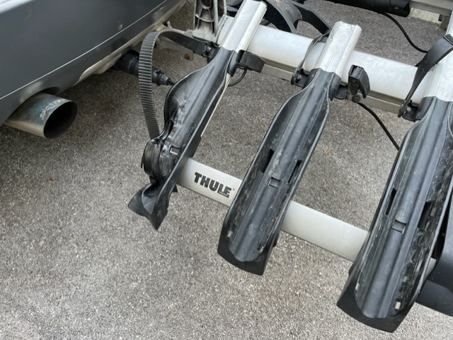

A friend had my bike mounted on a Thule bike carrier behind his Audi with double exhaust pipes and it seems due to heat generated by the exhausts, the bike carrier melted including my Roval Traverse carbon rims. This bike carrier has been used for at least 15 years without any issues behind all different cars. Unfortunately now the issue occurred. Just see this post please as a warning to make you aware what happened to my bike.
It also seems to happen more frequent as Specialized added this exclusion to their "shit happens" warranty policy:
"Damaged your carbon wheel from an exhaust pipe or drove into your garage with your bike on the roof? While that **it happens, it’s not covered."
Bike is around 6 months old. We were with a group of friends 8 people in total no one thought about this including my dealer. Let it be a warning for all of you.

Oooh - that's gotta hurt. Looks like Audi thought more about clean lines than what people are using the trailer hook for. I'd guess more people use them for bikes than actual trailers.

I think you are right that these are aftermarket pipes. I think it has been a combination of riding through the mountains which generated excessive heat. Searched on the internet obviously and it seemed to have happened more often with other riders.
Personally I have an electric car now as well but as we only went to Italy for 5 days (3 bike riding days) we thought the petrol car would be more convenient. Stupid lesson and expensive damage.
Hope we will be able to sort it out.

Aftermarket tips are not going to change how much heat comes out - the pedal foot, load and road speed/terrain will. The tips will also not change where it comes out (unless they also redirect, though usually not common).
FWIW, it looks to me like the carrier wheel trays are too low - this gets the bikes out of the wind, but the result was the damage lower down … unfortunately.
My own (foldable) bike carrier wheel trays are not so low - also Thule. It might be a known problem to Audi too.

Hi, as discussed here it is not a problem of the rim / bike but the car used, found to be problem e.g. with BMW X and Audi:

Yah, when you have a turbocharged engine going up mountain passes and blowing 800' exhaust gas on your plastic bike probably for minutes at a time, your plastic bike is probably going to melt. Duh.
