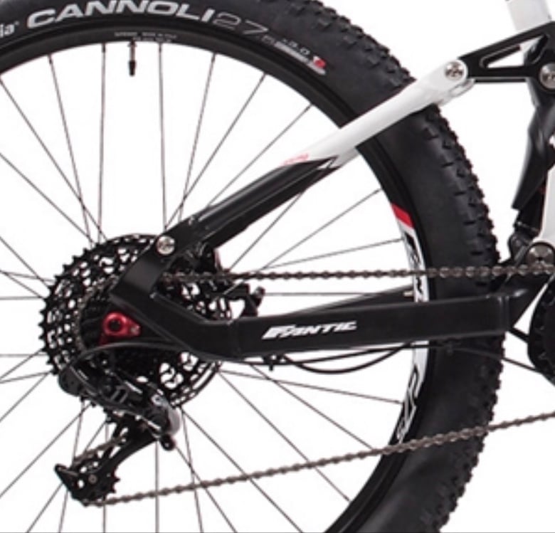

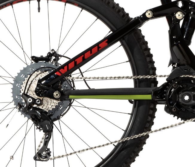

The Vitus is a 4-bar Horst link system, but I am pretty sure the Fantic is a faux-bar single pivot from the pictures; the Vitus has the tell tale pivot on the chainstay, but with the Fantic it is on the seatstay.
The ultimate guide to mountain bike rear suspension systems
Both have the lower shock pivot on the lower chain stay, not fixed to frame. At least that’s the way it looks to me in pics. I have never seen a virus here in states. Good looking bike and i like how the battery is mounted on inside of the triangle
Ok, gotcha. Even so I would still say the difference between a single pivot (Fantic) and a 4-bar linkage (Vitus, not Virus ;)) is pretty significant however the shock is mounted. They are likely to give quite different characteristics, especially when you are working hard out of the saddle.

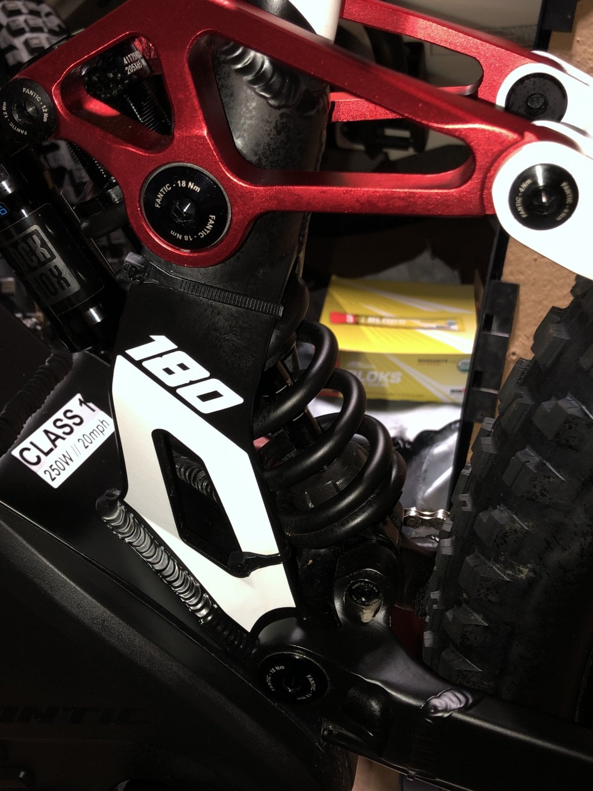

Lmao. My phone auto corrects vitus to virus
But i found close up and your right there very different. The Vitus has fixed lower shock pivot.
The Fantic the lower shock mount is on swing arm so it has progressive ratio.
But they both are 4 bar duel pivot. The Fantic pivots on upper chain stays and the Vitus is on lower rear.
But at first look i thought the Vitus had the lower shock mount on chain stays when second look it’s a fixed mount on the bottom bracket.
I am partial to live mounted shock. Meaning both end of the shock move not a fixed shock mount or dead ended mount.

"The E-Sommet uses a Horst link suspension layout, but with the lower shock mount attached to the chainstay. The means the shock is pushed upwards from the chainstay, and downwards by the upper rocker link simultaneously"
E-Sommet suspension Video - Pinkbike
R120, thanks for that video, so both the Fantic. And Vitus have very similar rear suspension. They both have Horst link. So there is a difference in rear chain stay pivots. One is upper the other is lower.

The Fantic doesn't have a horst link. It's a single pivot swing arm with a 4 bar linkage. That's what Matty has been telling you.
Matty saying the difference will be when working hard pedalling stood up isn't the only difference. Activeness and behaviour under braking will be different between the two frame designs as well.
placement of the horst link on a bike can be calculated to behave a certain way under pedalling forces and braking forces that a single pivot cannot. That pivot position can be utilised to control anti-squat and anti-rise. (obviously it's not all down to one pivot, the bike's instant centre needs to be used and gearing)
You can also still design a very progressive leverage curve with a fixed shock position.
a floating shock mount alone doesn't necessarily make all that much difference to it's characteristics. it's mounting position does and the arc of each link does.
Simply looking at two bike frames and seeing similarities doesn't really tell you a lot unless you know what you're looking at/for. And even then without knowing exact dimensions and pivot placement positions you're guessing.
download Linkage software and have a play with it if you want to understand how various pivot positions/liinkages affect LR, AS, AR, pedal kickback etc.

It may seem like pedantry, but the move of the rear pivot from chainstay (Vitus) to seatstay (Fantic) is very significant to the way the suspension works, much more so than the fact the base of the shock links to the chainstays in both bikes. Go back and read the link I posted previously - it is a very useful reference for explaining the differences between the different suspension systems.
Key extracts:
" 2. Linkage-driven single pivot
A linkage-driven single pivot design still uses an uninterrupted swingarm, connecting the rear axle directly to the mainframe. However, it incorporates some form of linkage to drive the shock. This allows the designers to manipulate the leverage curve and so control the frame’s progressivity (how much the suspension firms up towards the end of the stroke).
On a Scott Gambler, or any recent Evil, for example, the linkage is driven from the front of the swingarm.
Kona, Cannondale and Commencal — among others — typically use a visually different design, which sees the shock driven from a pivot (or flex-stay) located above the rear axle.
This looks similar to a four-bar (Horst-link) design, so is sometimes referred to as “faux-bar”; but the rear axle is still connected to the main pivot via a simple swingarm, so this is just another form of linkage-driven single pivot."
...and...
"3. Horst-link (four-bar)
Horst-link (aka four-bar) suspension — as used by Specialized, Norco, and newer Transitions (as well as many others) — is marked out by a rear pivot located below the rear axle on the chainstay (rather than the seatstay as with the “faux-bar”).
This means the rear axle is not directly connected to the mainframe, and so moves in a path which is defined by its Instant Centre and Centre of curvature, which may move as the suspension cycles through its travel. Depending on the position of the Instant Centre, the effect of braking forces on the suspension (known as anti-rise) can be reduced relative to a single pivot design.
As I’ll explain later, this can afford designers more control over the levels of anti-squat throughout the suspension’s travel, as well as reducing the effect of braking forces (known as anti-rise) on the suspension, with the aim of improving sensitivity."
