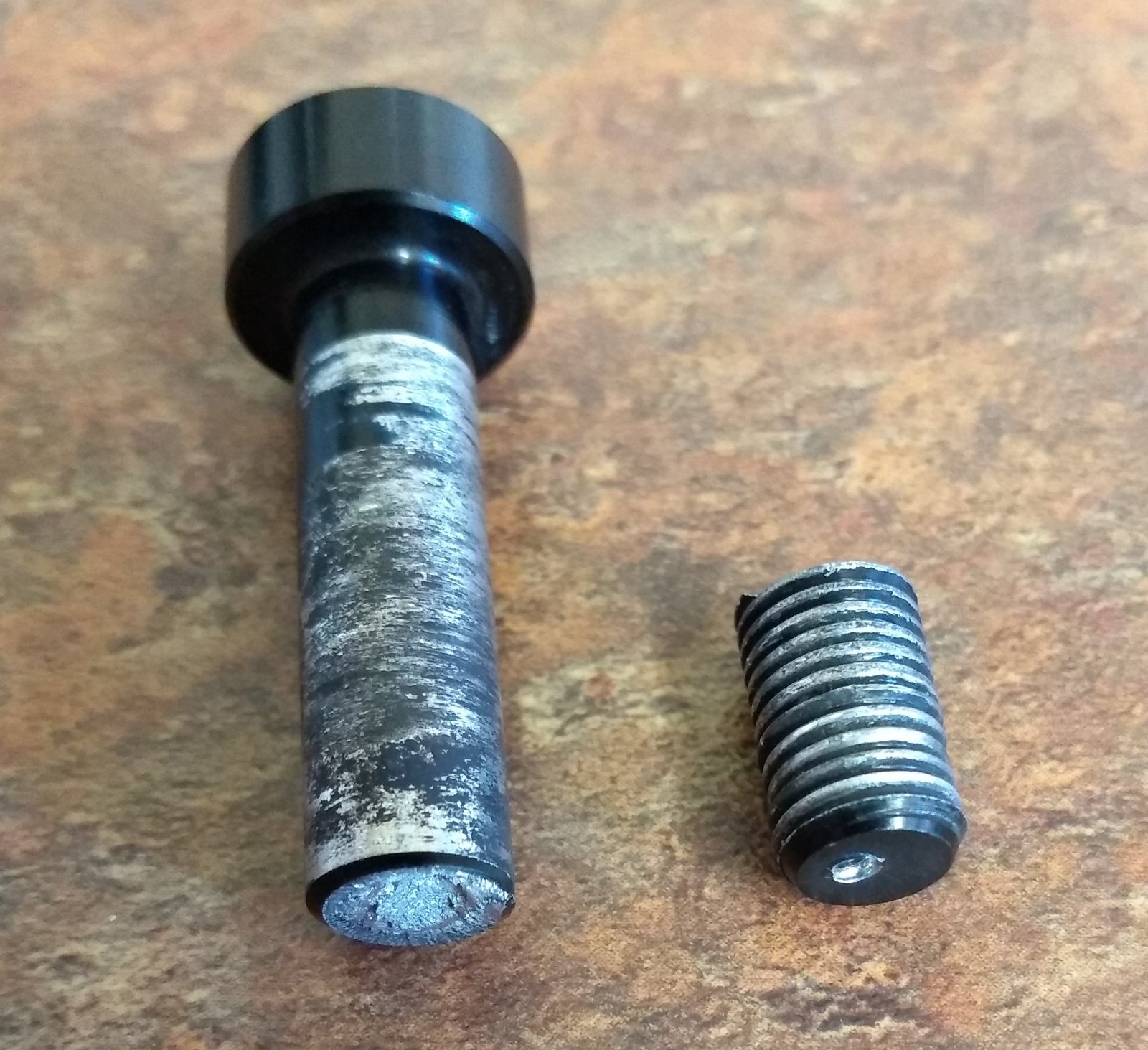

On my Focus Jam2 the bolt came loose on the lower shock mounting bolt came loose and slowly withdrew itself until it sheared. No rattles or noises, it just sheared. Fortunately only the end of the bolt sheared and the rest of the bolt stayed in place, so no catastrophe!
New bolt, Loctited this time (as it should have been from the beginning). Upper bolt replaced and Loctited at same time, just to be sure. Bolts cost about £6 each!
