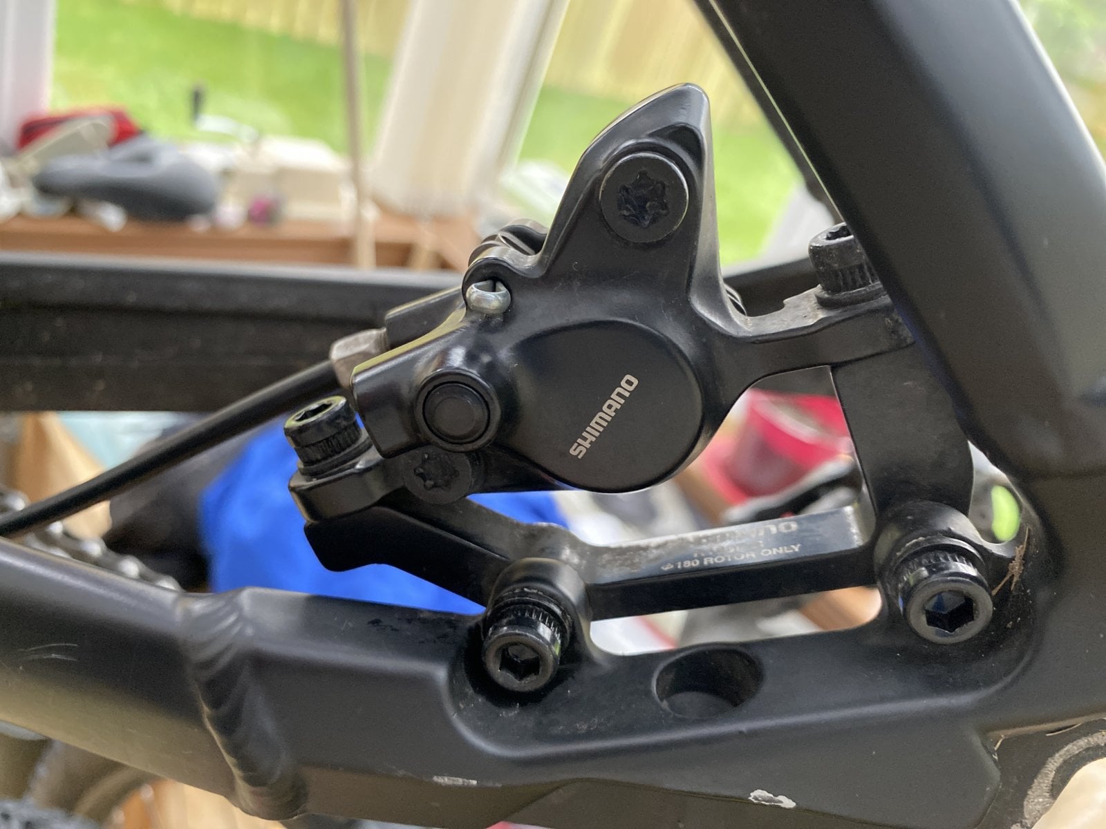

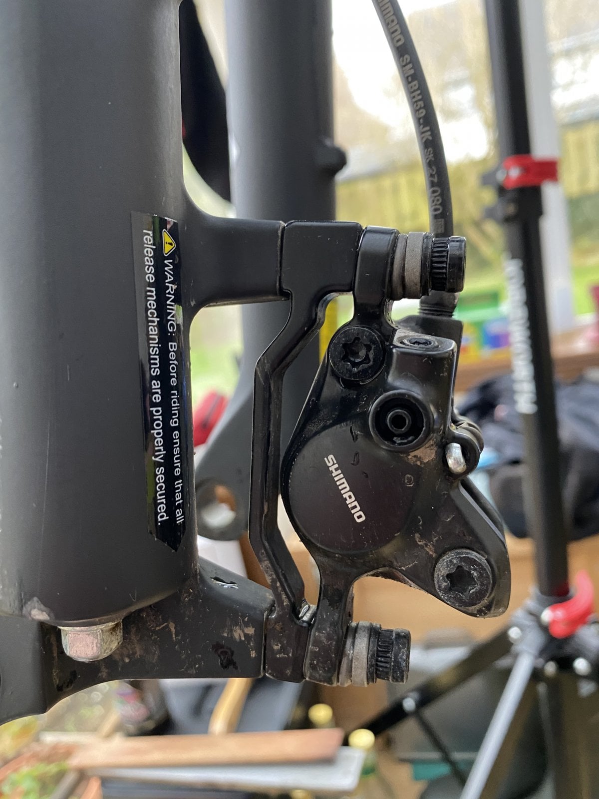

If you want to ping up a photo of the calliper mount, on the fork, I'll let you know (it should be good), but you can always check with the manufacturer to be certain.
Sorry for my late reaction, many things came in between.
I have attached two photos, if you need more let me know.
What would be a good suggestion for brake callipers if needed replacing and also what would be a good adapter for this, have seen a few.
I believe the mounting is a standard fit.
The other thing I am just wondering if the 203 mm won’t be too much for the fork?
Front wheel:
Back wheel:
Those are both the rear. You'll be able to upsize by 20mm on what you are currently running. If you can ping a photo of the fork, let me know what make and model the fork is, and I'll let you know about that too.
I edit the lat post, there is now a picture of the fork.
The fork is:
  • Fork SR suntour XCM34 Coil, Tapered 15x110mm, 100mm, lockout
The fork is:
Cool, thanks. Yes, you will be able to increase your front rotor size by 20mm as well. On the rear you'll need a 200 or 203mm adapter, of the same type you have, same on the front. Bear in mind that the front and rear adapters are different types. This one would be for the rear LifeLine IS to Post Disc Brake Mount Adaptor | Chain Reaction and this one for the front Shimano Front Disc Mount Adaptor (Post to Post) | Chain Reaction
What size rotors do you currently have? From memory it was 180/180? If you get the 203mm version of each of those adapters, it will enable you to run 203mm front and rear. The only thing you will need to check first, is whether your frame is designed to allow such an increase in rotor size. That's best done by checking the product specs and/or emailing the manufacturer.
