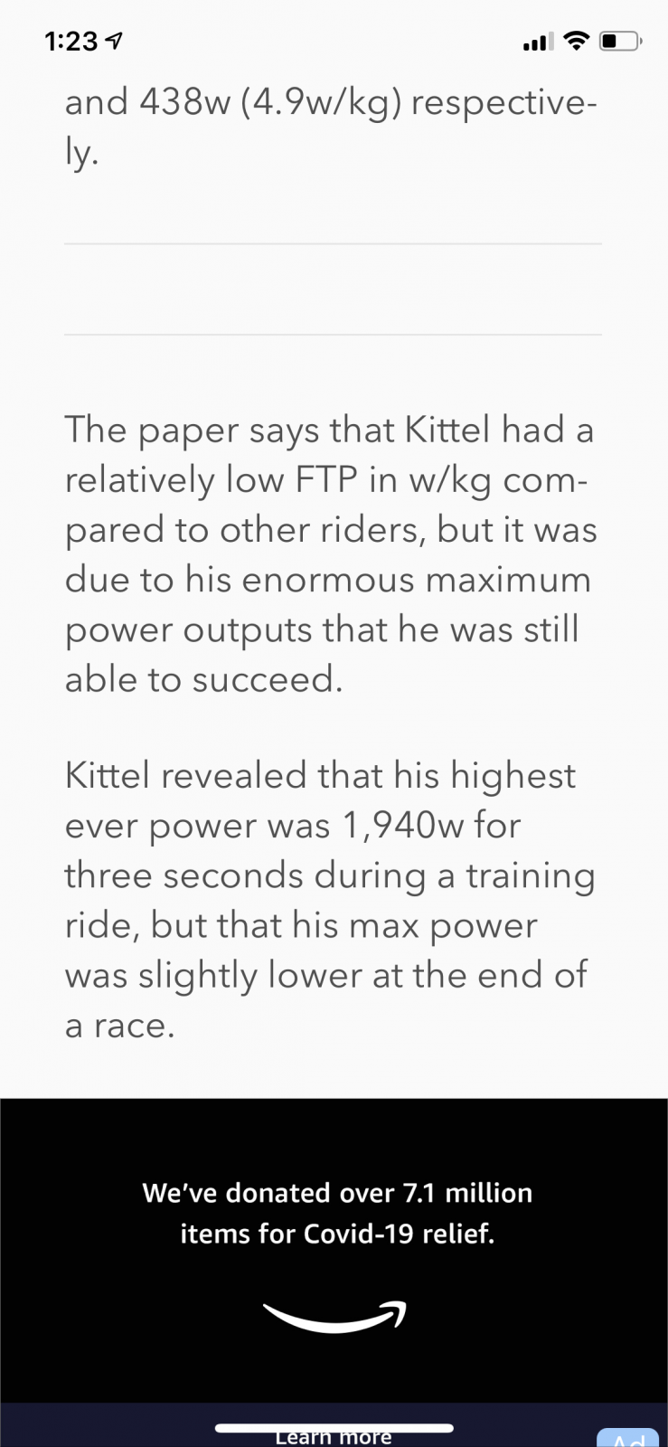

Normal drivetrain components are plenty strong/durable enough. The average EMTB rider cannot output elite cyclist levels of power even with a motor..
Most damaged and broken chains are from poor shifting under load.
The fact that you think a 40t sprocket is small tells me you're probably not an elite level cyclist. A closer ratio cassette and better shifting technique would do more towards a "possible solution" to the "issues" you describe than a wide range 8 speed cassette.
