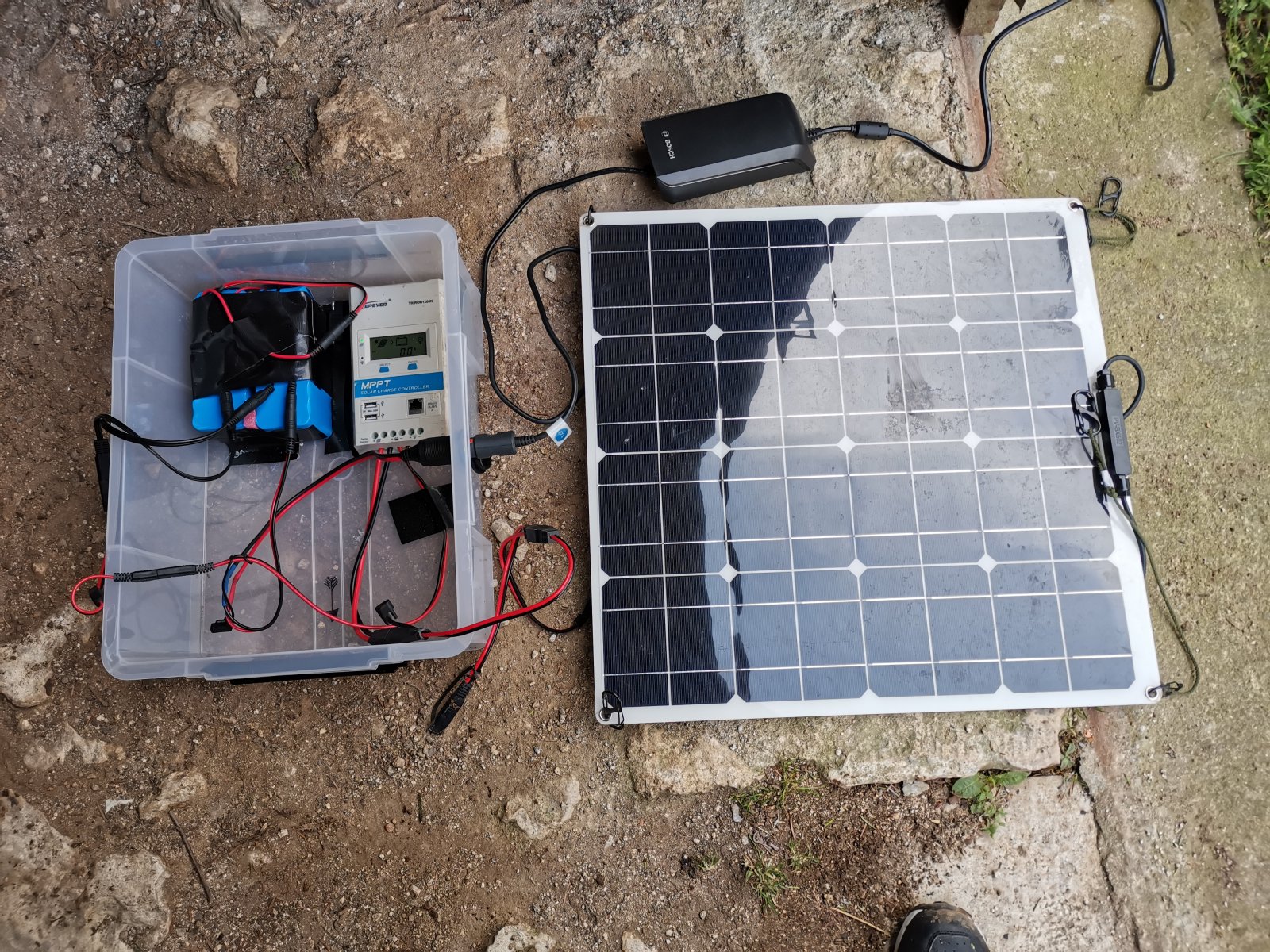

I have a 50watt flexible solar panel on top of my trailer. In a box in the bottom I have an mppt controller and two 12volt lithium batteries for a total of 42 amp hours. I also have in the box a Bosch travel charger running off 12 volts, and a three way mains extension. If you can't get the Bosch charger or it won't work for your bike you could use a power butler or an invertor. Shimano batteries won't work with the power butler.
I take the mains fast charger for the bike and the 2 amp charger for the two batteries as well. While I am riding the solar panel charges the batteries in the box and on arrival I park the trailer in the sun and plug the bike in via the 12volt charger. If there isn't enough sun to charge then I have to find mains for a couple of hours. I charge my phone and the bike lights on USB from the mppt controller as well.
When I'm touring with the camper I have a larger folding panel which also charges the camper battery, and enables me to run an invertor. I use pure sine wave as some chargers are fussy about their wobbly volts.

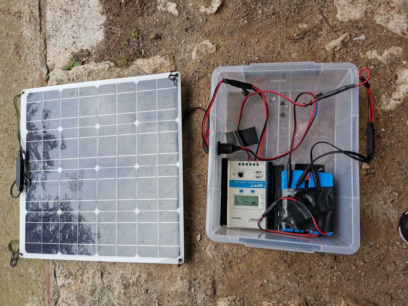

Here you are. The box that holds the batteries etc is just a plastic storage box with a cigarette lighter socket in the side for use on arrival.

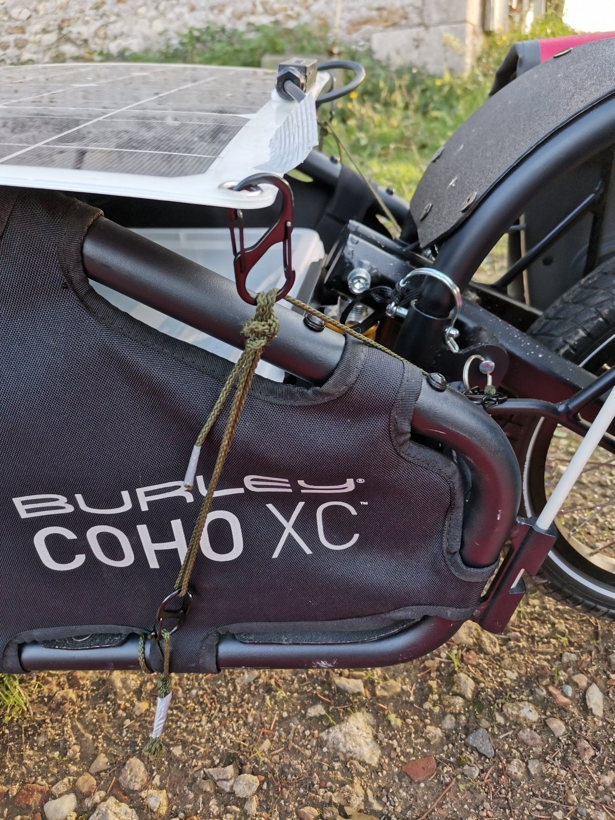

And here is the trailer on the bike. Minus the panel in this picture, but you get the idea.

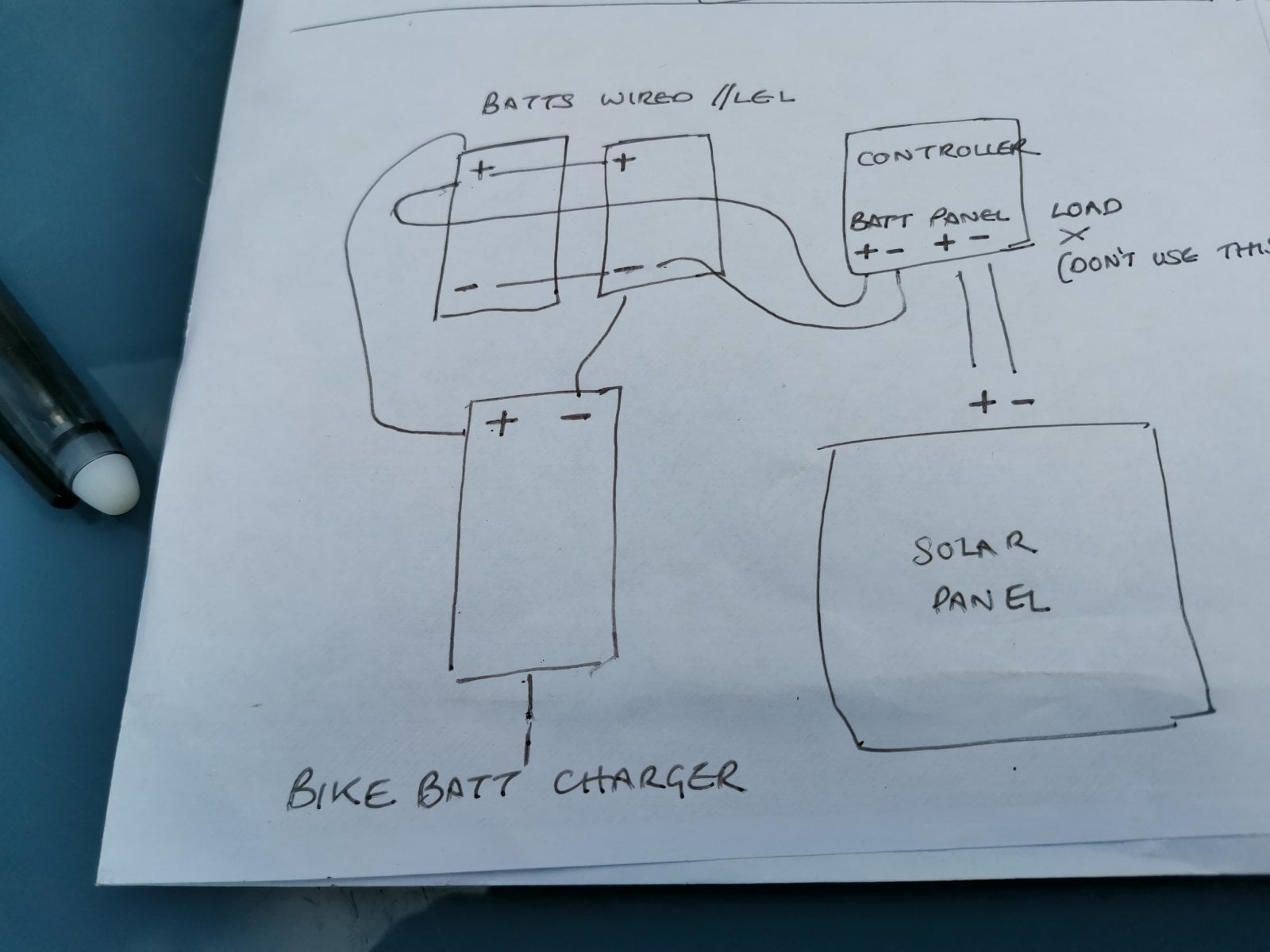

Sure, no problem. It's pretty straightforward. You can use one or two or as many 12 volt batteries as you like which you need to wire in parallel. They do need to be identical though.
Then you connect battery to controller first before plugging in the panel. That's it, really. I used a flex panel which nearly covers the trailer, from Ali Express, the batteries and controller are from there as well. A 10 amp controller is plenty. If you charge on mains the chargers come with the battery but they are only 2 amp so take a while. I used sae plugs and sockets which are cheap and come with the wire, so you don't have much soldering to do. They are damp proof only but they are in a sealed box apart from the last connection to the panel. 14AWG wire is thick enough.
I will draw it out for you as my setup allows for a second panel which complicates it a bit.
I took a bit of care with the plugs so I couldn't get it wrong when tired and /or too much after ride beer. That's why some of my connections use DIN plugs and sockets. You could make permanent connections in some places where I have made it separable as i have a slightly different setup for when I also have the van available. I will do a diagram when i have a bit of time to spare.

I hope that's clear. If you have a12 volt charger you don't need the invertor, but in either case go direct from the battery terminals and not from the controller output labelled load. Keep the wires between battery and invertor as short as possible and use 10AWG just for this part of the system.
Be careful not to bypass the battery management system. You need to plug the controller battery terminals to the same socket that the mains charger uses. And take the output for your inverter from the other terminals, which might just be two bits of wire.
You need to be able to separate the panel and the battery from the controller without having to poke wires into the controller terminals so you will need some connectors. I use SAE as they are small and fairly cheap. Check all your polarities before connecting it up. Cheap multimeter is handy here. Glue the battery and controller into the box. If you find a 12 volt charger then you can fit a socket (car lighter socket is fine for a 2 amp charger) into the side of the box
