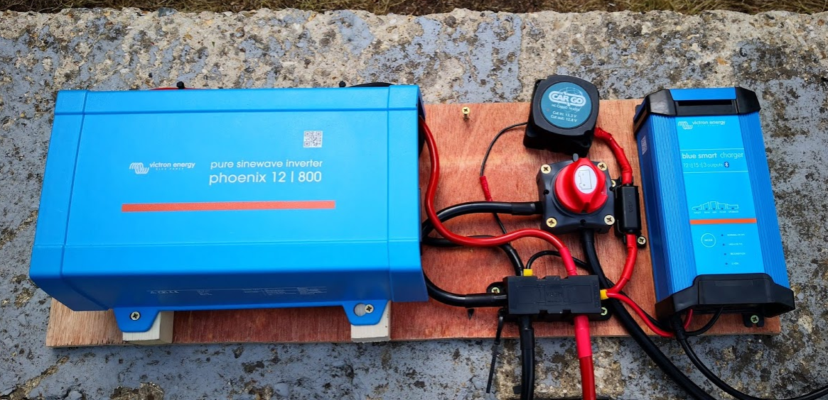

I think (maybe incorrectly) .. that @routrax had some in van charging options ?
You've got a good memory Zim!
I've got this installed in my van, with two 110ah leisure batteries and 150w flexi panel on the roof.
Charges from the engine via a voltage sensing relay (top middle black box), 240v with the blue charger on the right. I've also got a 15a victron mppt controller.
I run a fridge and charge a laptop/ebike/whatever with no difficulty in the summer.
Works pretty well, but another 150W would be a good idea in the UK.

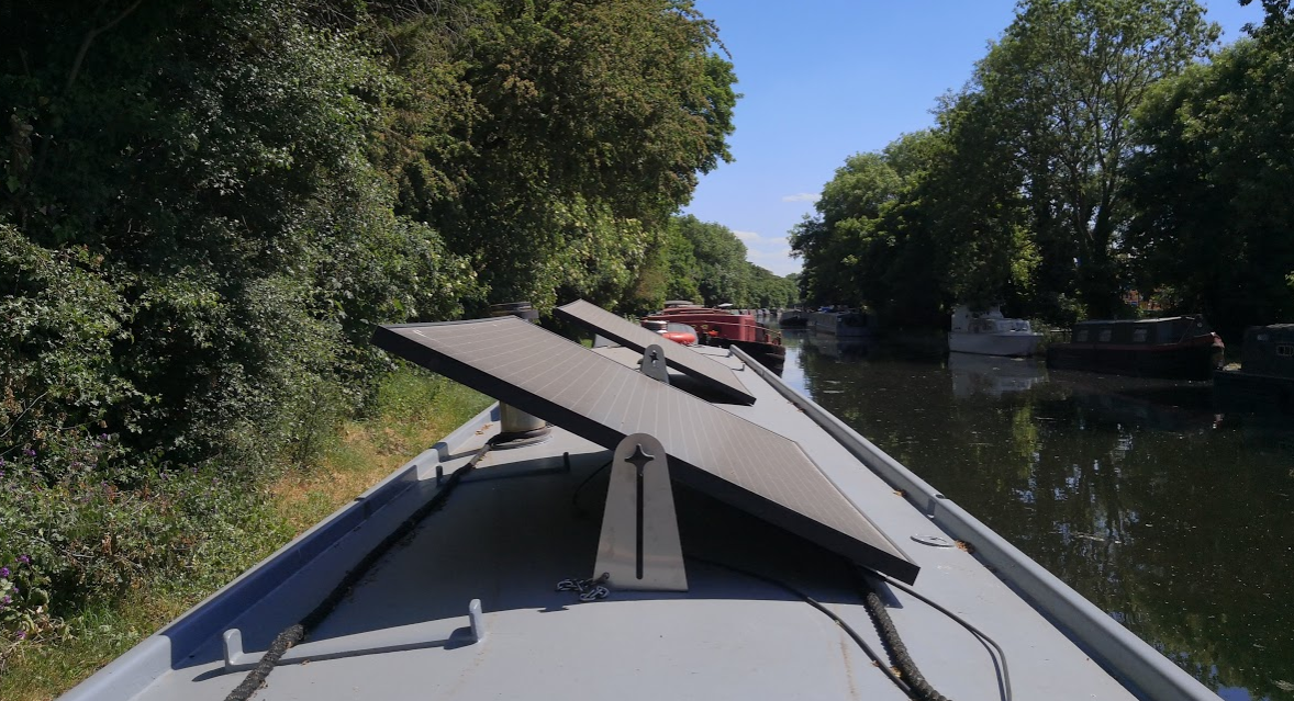

Got these on the roof of my boat
800w into a Tracer mppt and a 225ah 24v battery bank (4 x 6v semi traction batteries).
This works brilliantly and runs all of my domestic electricity (fridge freezer, TV, xbox, laptop, charging ebike, etc) for about 9 months a year. In the winter I need to run a generator and charge my batteries that way.
