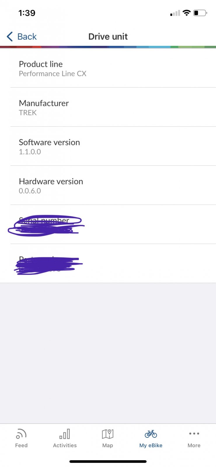

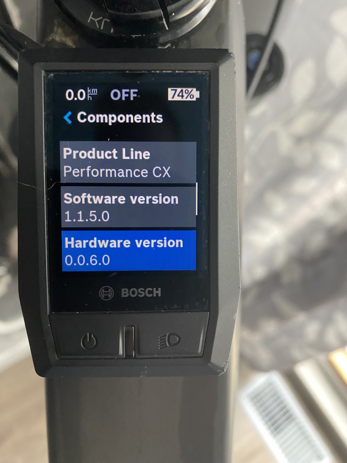

On my trek rail, motor software version is different on kiox vs ebike connect app.
Kiox: 1.1.5.0
App: 1.1.0.0
Does anyone know why it’s displaying two different versions, and which version I actually have?

What you need to is delete the bike on the app, and resync it. It happens to me with every firmware upgrade and it's the only way I have been able to resolve it.
