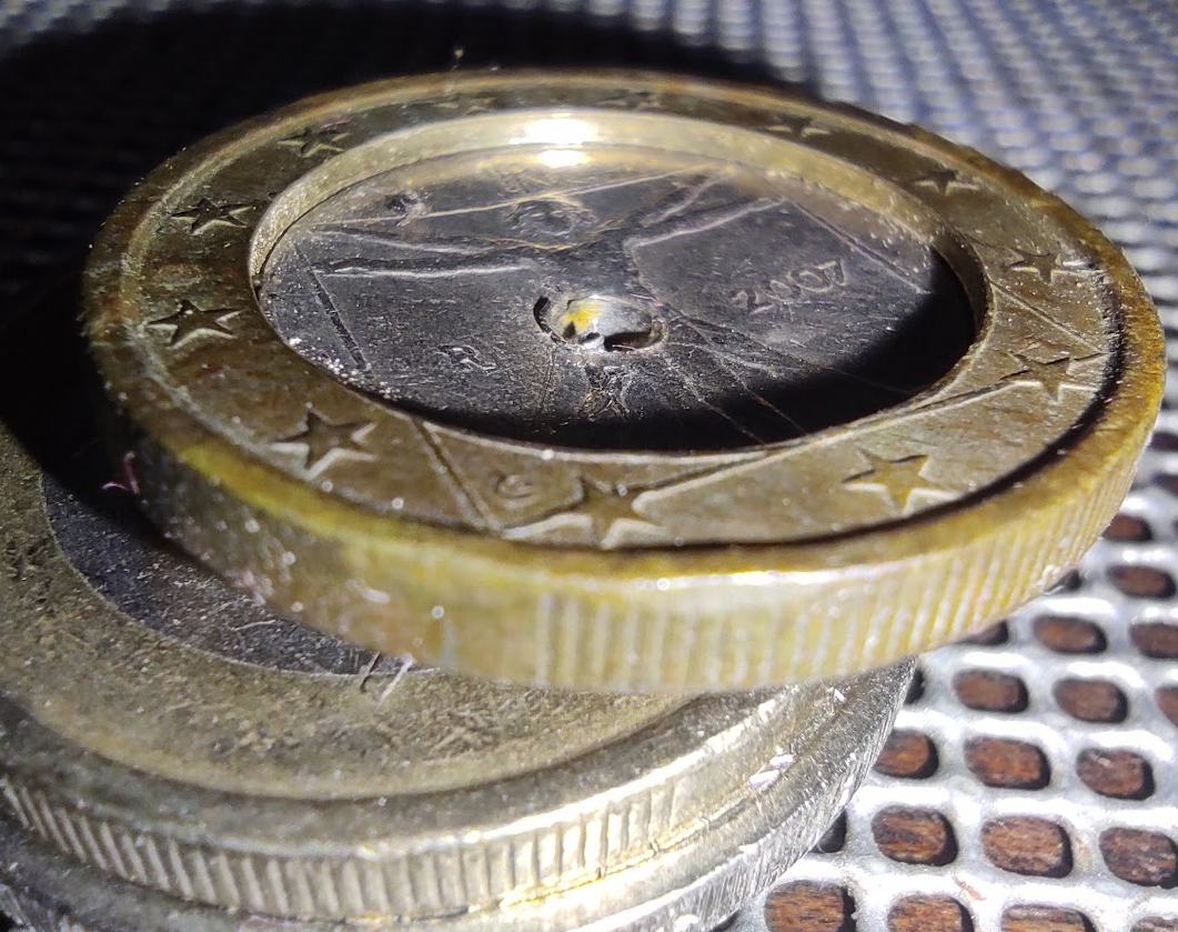

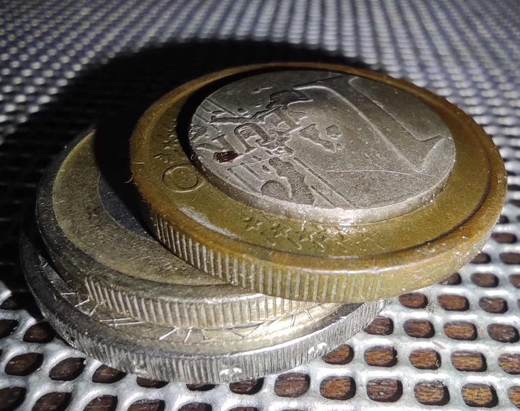

Another hack!!
Find/buy a spacer that has a diameter that will fit snugly ...............superglue/araldite JB weld it to the bearing outer race and leave for while to set. Or just use a section of bolt cut to a size that will span the diameter and glue it. Then bash both out from the other side.
e.g a 2p coin slightly reduced fits into the outer casing of a 6902 bearing, and 2 glued together would be strong.
