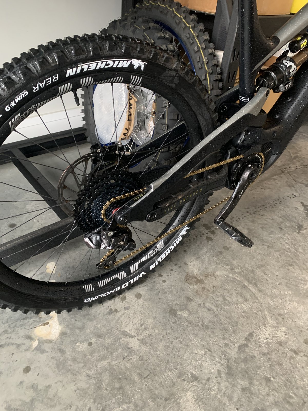

There are some steep hills around here that are difficult to pedal up even in boost mode, Chain/chainring/cassette were due for replacement so figured I’d go down a size.
By steep I mean difficult to keep the front wheel down while seated, and for extended lengths. I find my cadence was very slow in the 9 tooth cog on the E13 cassette at max assist speed also so switched to a 10-46 Sunring as well. Shifting is better as a bonus. Not as nice as the new 12spd Shimano but better than the E13 cassette at least.XT Di2shifter/derailleur.
I’m not a strong pedaller, I run a 30t on my non assist bikes even with 12spd cassettes.

^^ Curious as to what chain you are running ? GOLD (blingy):unsure:
How much better do you find the Sunrace cassette ? The only benefit I find to the e13 cassette is its loud enough to scare away bears and let hikers know your coming a mile away :)

Did you get a 32t? Looking for 1 also but cannot find any.
Yes, my local shop put on a 32t OneUp ring same time as the Sunrace 10-46 cassette and KMC chain, it’s just a standard chainring your local shop should have one. I’m not sure the exact spec of the OEM one for spacing but it was nothing special.
