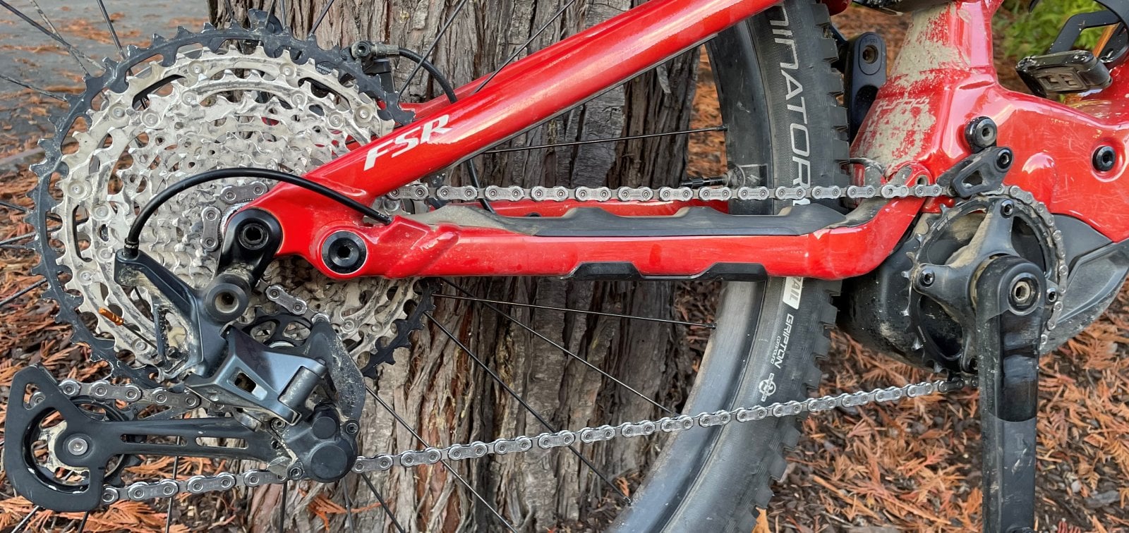

The chain has not been modified - this is the as delivered length.

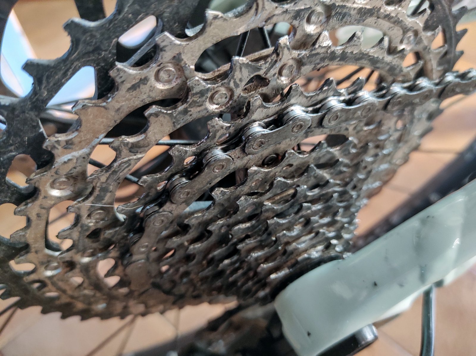

I would be amazed if a different lube would have made any but miniscule difference to the OP's remarkably short lived 11th and 12th gears. 100.001 miles instead of 100 miles if it is truly remarkable chain lube? That goes along with cleaning too. This seems to scream mechanical or more likely, metallurgical, failure.
This thread became longer than I imagined it would. What I discovered was the original material (contaminant?) on the chain was the issue. In 30+ years of Shimano chains I've never had to degrease a chain before riding, so I didn't, and the chain looked like any other new chain. My rides were on marginal to no dust technical trails. Moab is a very tough environment on chains - the forest conditions of these rides were as opposite of Moab as it could be. There was one day that was a little wet, but not otherwise remarkable.
Seriously cleaning the chain fixed. Although I have this lube ready to go, I changed one variable at a time to confirm what the hell was going on. I have used no lube in Moab in the past because some lubes are worse than no lube. I'm going with this stuff to see what happens.
Net: I agree with you. The chain had to be degreased first.

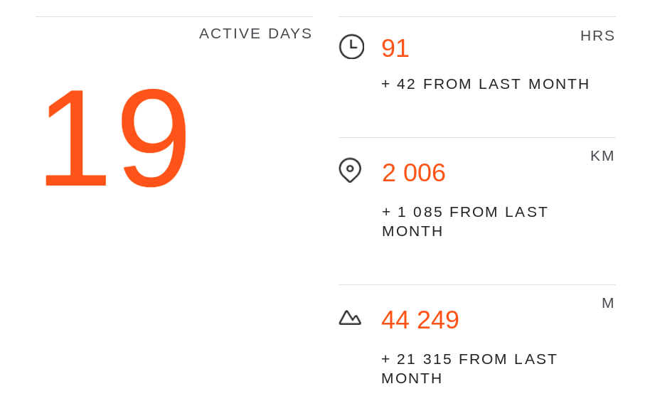

In defence of the SLX setup or to alleviate any concerns anyone might have. I thought I'd better put a new chain on mine and show it some love.
Focus with SLX cassette and chain. 4 Months old, 3000km's, 76000m climbing. Most of that's only in the last month due to injuries, but I don't think time scales should affect wear :)
I'm very very careful with shifts, but do feck up occasionally as I'm sure everyone does.
Just checked the new chain (SRAM - I prefer their chains, but not the rest) to the old chain and I'm showing virtually zero stretch/wear. So the old ones gone back on for now.
It's not perfect, but it never slips or jumps and still shifts perfectly.
September Focus Stats :
Edit : will be buying a Shimano chain to go on instead of the SRAM one I bought as after more research, it seems with the 12 speed system/hyperglide you get more performance benefits running the correct Shimano chain rather than a SRAM one (better shifting, less wear).
