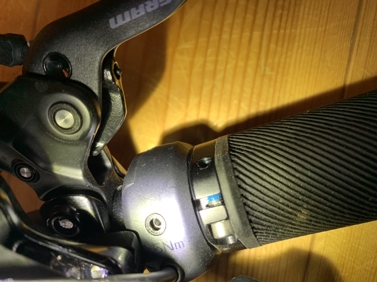

Hi,
I would like to rotate the remote that controls the power mood on my Levo SL Expert 2020. Can you tell me which size screw and type is used to secure the remote?
I’ve tried with light fire but I seem to strip the thread rather than removing the screw

There is a tiny grub screw recessed inside. I think it’s a 2.5mm hex key. Be careful not to do it up tight as you will round the Head of the screw. Just carefully undo it enough to move the controller and then re-tighten just enough so the controller Is hard to move.
