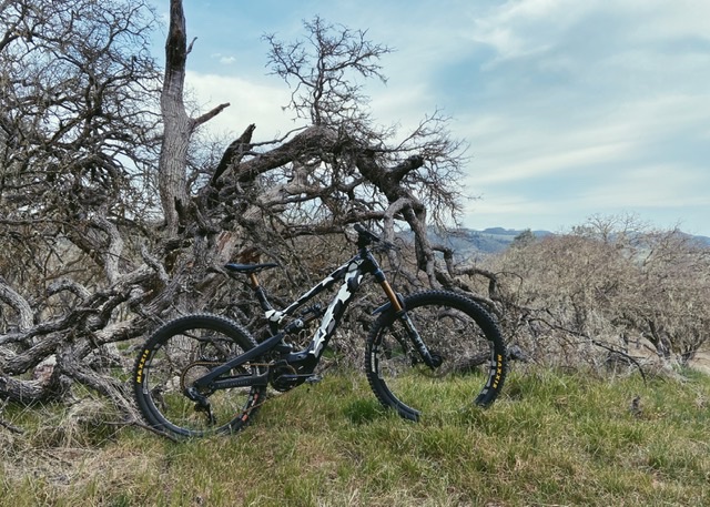

Folks do you think this Decoy29 Large looks about right if I'm used to Jeffsy29 Large geo?
2018 JEFFSY 29 carbon2020 Decoy 29 PROCHANGECHANGEQuality
LL%mm/deg.
TOP TUBE LENGTH (mm)616.0608.0-1.3%-8.0shorterTOP TUBE LENGTH (mm)
REACH (mm)445.0462.03.8%17.0longerREACH (mm)
STACK (mm)623.0624.00.2%1.0higherSTACK (mm)
SEAT TUBE LENGTH (mm)480.0445.0-7.3%-35.0shorterSEAT TUBE LENGTH (mm)
CHAIN STAY LENGTH (mm)440.0458.04.1%18.0longerCHAIN STAY LENGTH (mm)
HEAD TUBE ANGLE67.566.0-2.2%-1.5slackerHEAD TUBE ANGLE
SEAT TUBE ANGLE75.077.02.7%2.0steeperSEAT TUBE ANGLE
BB DROP (mm)24.031.029.2%7.0lowerBB DROP (mm)
WHEELBASE (mm)1178.01235.04.8%57.0longerWHEELBASE (mm)
HEAD TUBE LENGTH (mm)110.0105.0-4.5%-5.0shorterHEAD TUBE LENGTH (mm)
