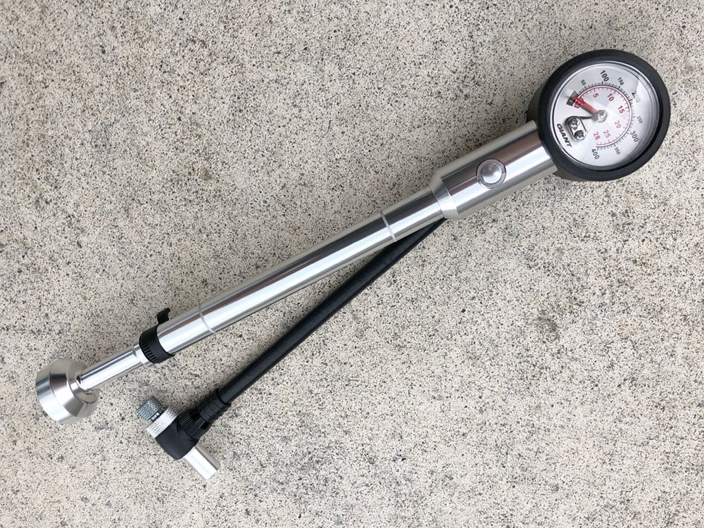

You know my old pump looks similar to your pump @Beekeeper and I get the same problem. If I don't time it right and twirl it out fast enough, a considerable amount of air from the shock rushes out. And it's not just the air coming from the pump gauge and hose. The screw connector of the pump presses the valve as it goes in, but when unscrewed - air can escape through the threads before the connector 'nib' can back off far enough for the shock valve to be closed beforehand. If I'm slow, as much as half the air pressure I pumped in can escape.
The newer pumps, like the Rockshox pump has a rubber sleeve that seals around the threads before it pushes the valve open, and so when the pump screw connector is being withdrawn, this rubber sleeve keeps the threads sealed until the valve is fully closed. Simple but effective.
I just bought a GIANT shock pump that has a two stage connector (like what Zimmerframe mentioned early on). There is a large knurled thimble that you screw onto the shock first. Then once that's all in and fully sealed, there is a smaller thimble that you screw-in next - that pokes a nib to open the valve. You unscrew the thimbles in reverse order to detach the pump. I can hear the air coming out of the pump, but that's a minuscule sparrows-fart compared to my old pump.
Pros and cons about the Giant pump...
Pros - good build quality and the pump handle is comfortable (large and round), and believe it or not - it goes all the way up to 400psi (I guess for the newer higher pressure shock designs).
Cons - the high capacity dial vernier markings (smaller and closer together) makes it harder to accurately place the needle for pressures under 100psi (common pressures for front forks). It's also on the big side as far as size is concerned, so not exactly something I'd bring on the trail with me.
But hey, I'm not complaining... best pump I've got to date. Takes away the stress and drama when removing the pump - and I know for sure that the pressure in the shock is precise and more importantly, repeatable. I believe there are other shock brands with a similar two-stage connector... but what can I say, I'm a Giant fanboi. :giggle:
