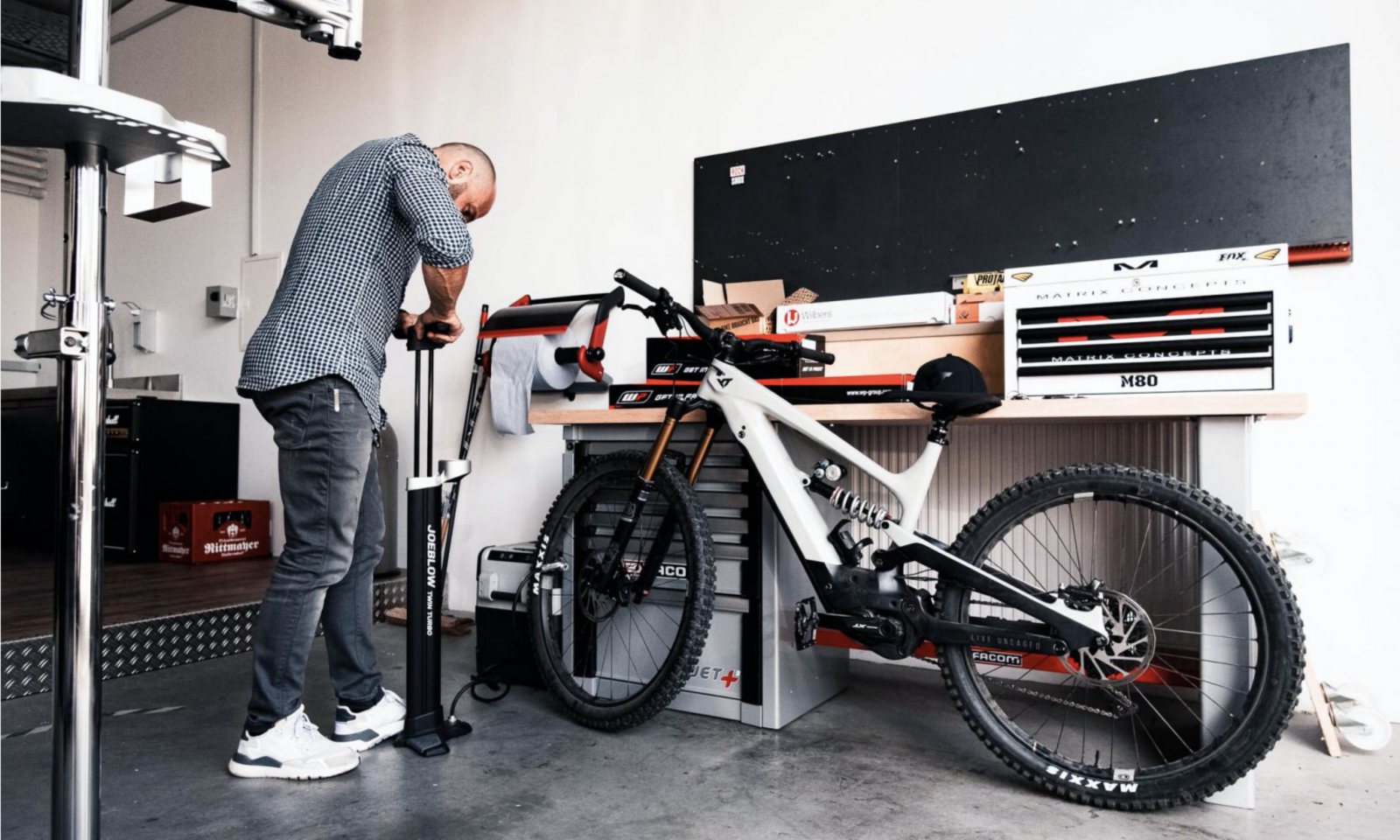

The funny thing is that the boss of YT, Marcus Foresman, runs a coil on his own Decoy
