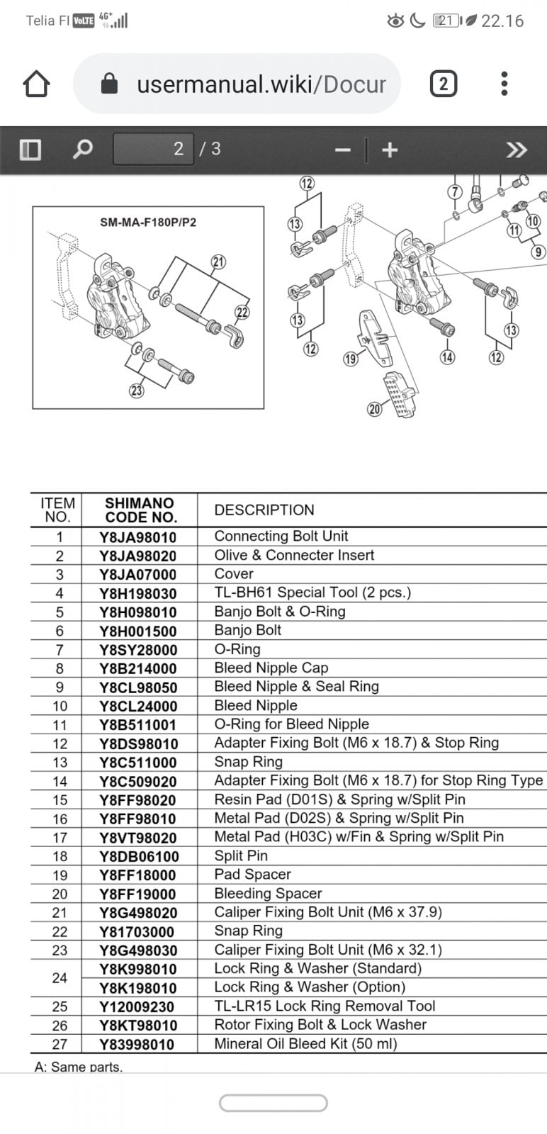

Check if the piston is still at one piece. Common mistake is to put bleeding block in but not use the locking pin. Block tends to move around when sqeezing the lever and can crack the piston if no pin is used. It's ceramic piston that cracks easily. There is no spareparts for the caliper from Shimano, only replacement calipers.
Caliper has super simple structure. Two halves, four pistons and every piston has one rubber seal. Only causes for leak are seal damage or cracked piston.
Block was in OK. It's the seal.
I've managed to get a secondhand Saint caliper from a mechanic in a bike shop so I can at least get out whilst I'm in Spain.
Bit annoyed with myself for not researching the zee, as I'd would not have bought it looking at the reviews and problems. Also find it hard to believe the is no service kit.

Feel free to look for a service kit from Shimano. No one has found it yet. Some Chinese company makes replacement pistons that have aluminum core. I asked for pistons / seals once from Shimano like many before me. They do not want customers / shops messing around their brakes.
