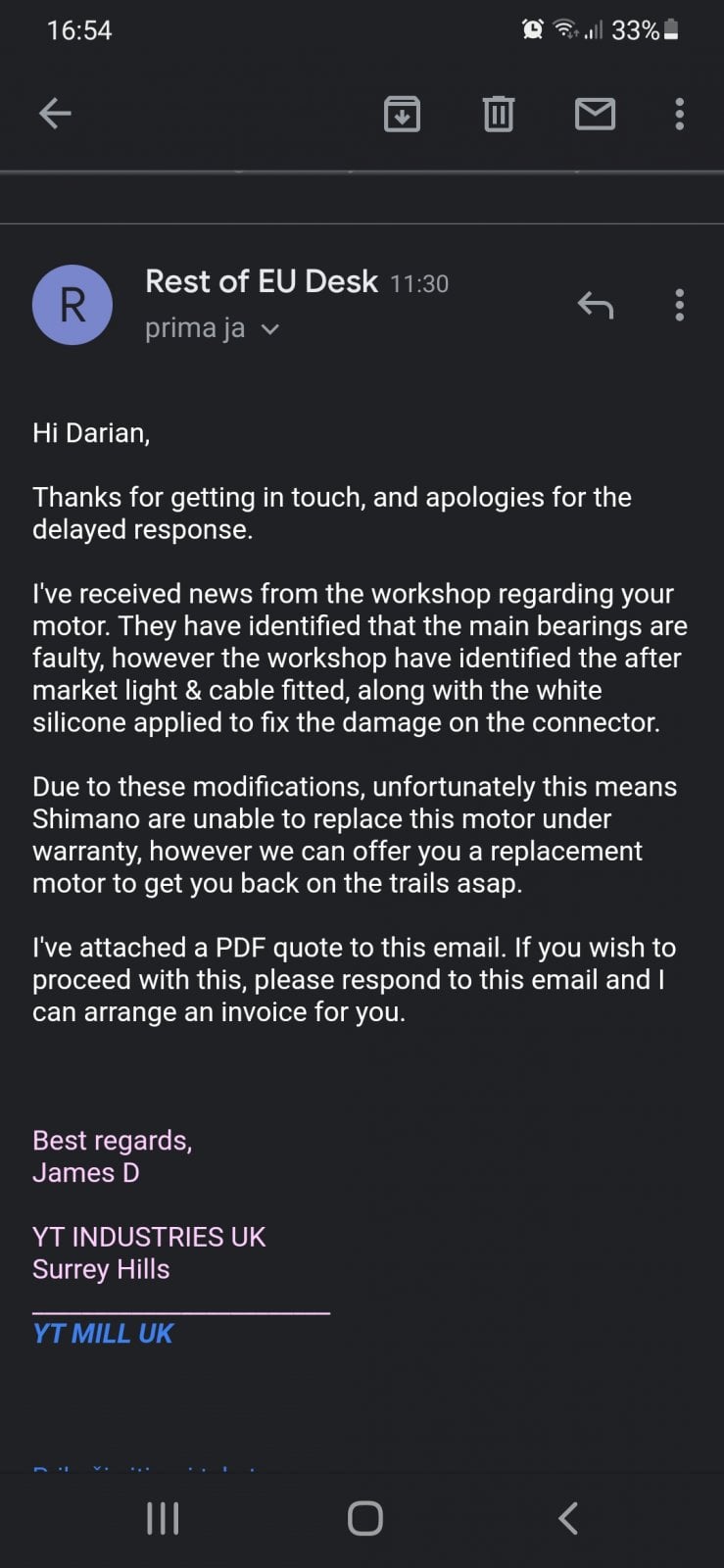

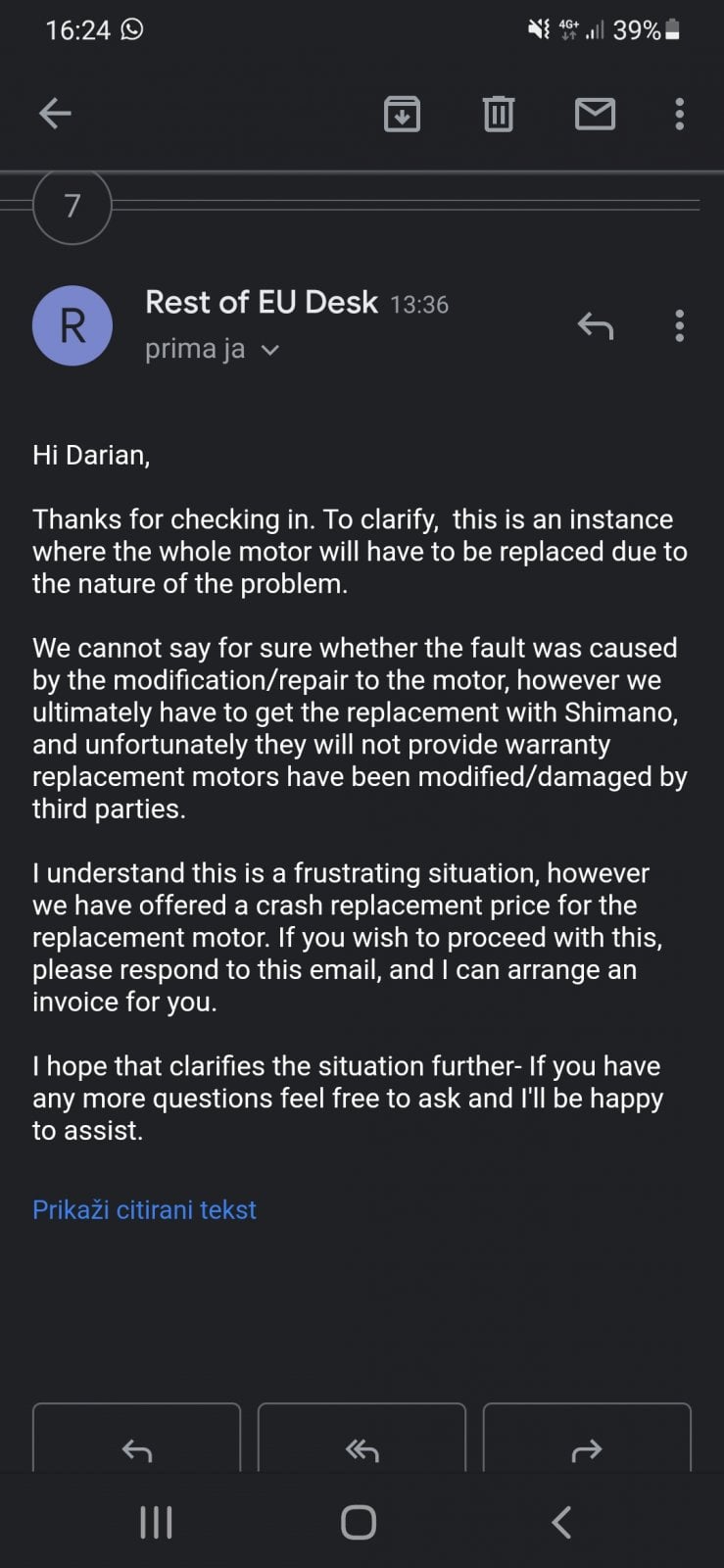

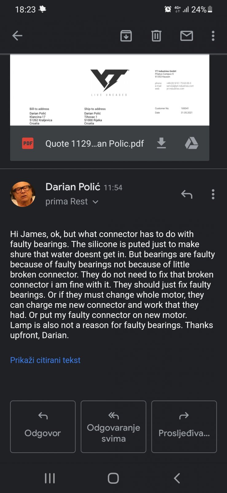

Hi guys, advice please....
Story goes....i have sent my YT Decoy back because of faulty bearings. But Shimano refusees to change the motor because i have mounted aftermarket lamp and cabel of Lightmove se 150 (has shimano compatibility and all kind of certifications and rewards). Also when i have mounted it i couldnt disconect properly main motor connection and peace of plastic broke a little. Nothing serious and nothing conected with bearings that broked.
But because of that, they refuse to change the motor in warranty.
Yt offered me new motor for 960 euros.
My question is....has anybody had similar situation? Or does anybody know can i complain someone and can i win over this situation or is it 100% bad for me.
Thanks upfront and best regards, Darian.
Ps. I have attached the mails.

Just an info on my situation.
So after allmost three months i recived my Decoy back. With new motor, new motor cover and ofcourse new connection on motor. It was a struggle but YT sent motor two times to shimano service and they finaly accepted, as they said good will.
I am satisfied and it worth waiting so much and exchanging 30 emails.
Thanks all of You for advices and comments.
If anybody want details, feel free to ask.
Peace....
