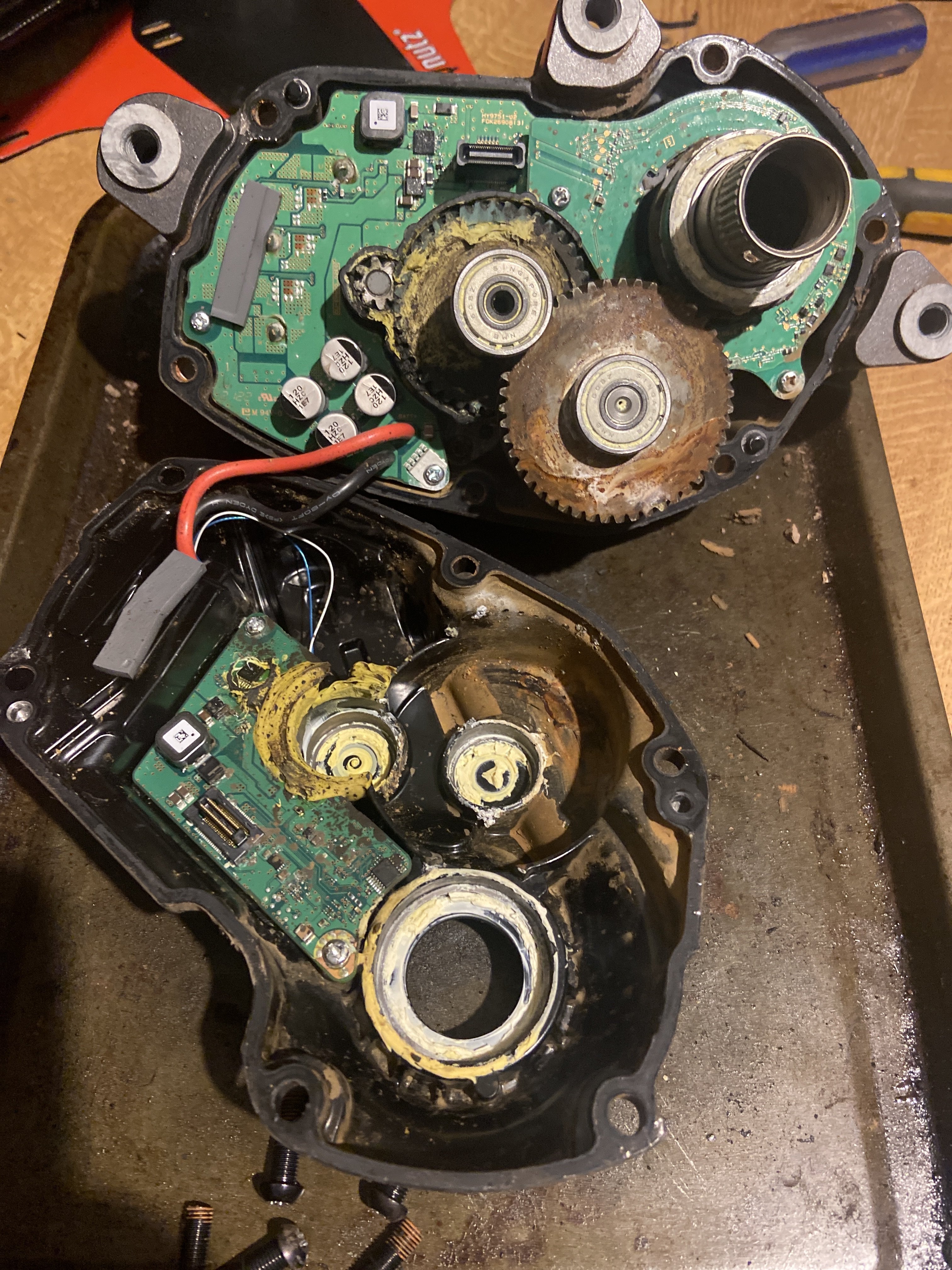

I have on my workbench, a Ep8 with 400 miles on it, you can see a water line from where water has leaked in!!!
This motor hasn’t been pressure washed, just been ridden through one British winter.

That looks like an assembly problem, or put it another way, a Quality Control problem. Why else should so many people have zero problems with their EP8s.
Bad luck Dan. :(
With only 400 miles on it, have you ruined your potential for a warranty claim by opening it up?

Has it been ridden hard through streams? Or maybe transported externally on a bike carrier whilst raining hard....at 70mph+? Cos that doesn't look like a 'oops it just happened somehow' problem. 🤔
