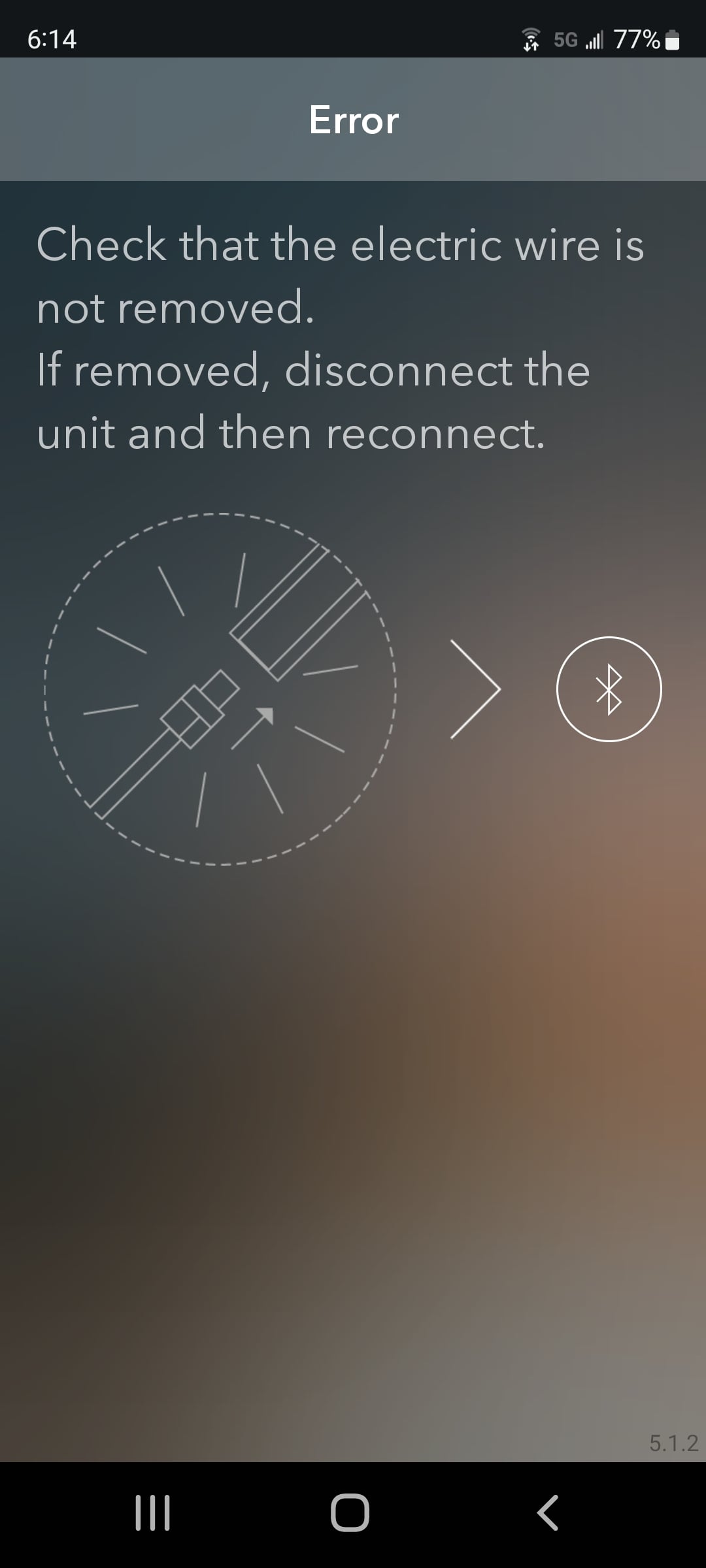

I suggest to reset the assist to factory settings and only use SL for checking battery health. I use etube for any adjustment of the power levels. My E8000 system did not like adjusting the power with SL. And if you have an external battery like mine I use a pick to pull the connector pins on the battery outward towards each other for better contact with the connector pins on the bike. I do not get the E010 code any longer with the pin fix and no error like the one pictured since stopped using SL for adjusting the power assist settings.
