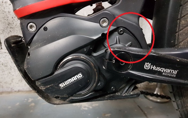

Hej Hej @Phil_st
I made myself two days ago the servicing of my E8000.
It seems to work well after it.
May be I am a lucky guy in this affair.
The torque sensor is reliable like before.
I have a Husqvarna and the place for the E8000 is very very sharp because of the design of the framework.
I ask me if I could once replace the E8000 with the EP8... of course with the accurate connectors.

Hej Hej @Phil_st
As far as I know, the E8000 and the EP8 have exactly the same profile and bolt patterns so can be swapped. Its the same on the Merida I have with the tight frame design and as Phil_st said, the boys at Epic Ebikes swapped out the 8000 for the ep8.
9,190
Depending on the frame design you can swap in an EP8, the mounting points are the same.
On bikes like the OG Merida and Vitus which had the basic frame mounts which don’t overlap the motor not an issue.
On something like a YT Decoy where the motor fitment is semi integrated into the frame due to the design it might not be possible

@Phil_st
For example wrote me today the technical departement of Commencal
that for all their own frames it is not possible to fix an EP8 instead of an E8000.
And they can't send me a broken EP8 for a test because they have to send it to Shimano for replacement.
But since last Monday my servicing of my E8000 seems to be totally positive.
