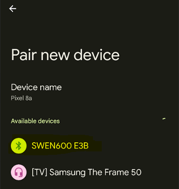

On my EP600 motor. I need to press the mode button once, on the bike, after turning on the App in the phone, before it will connect.
So turn bike on. Wait till booted up.
Open App in phone. Wait till connection status screen comes up.
Press mode button on bike to go from Eco to Trail Mode, or any Mode.
Then App connects.
