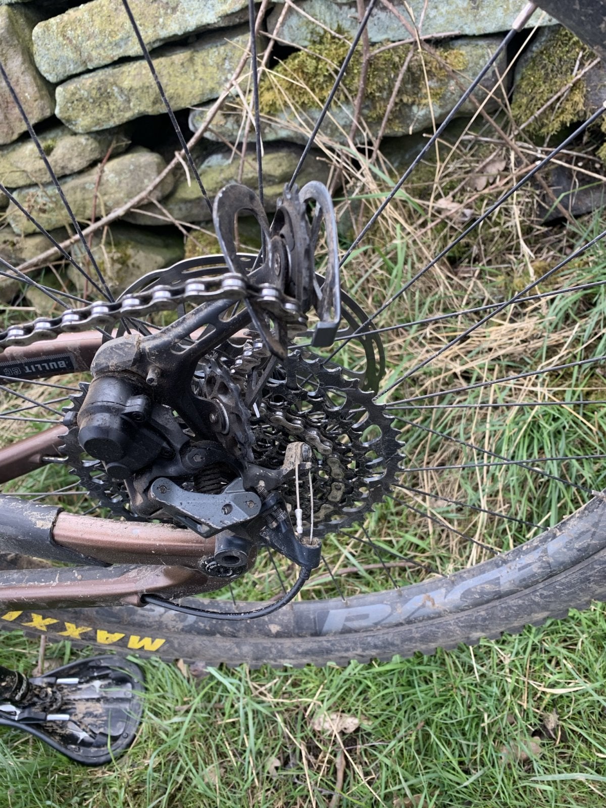

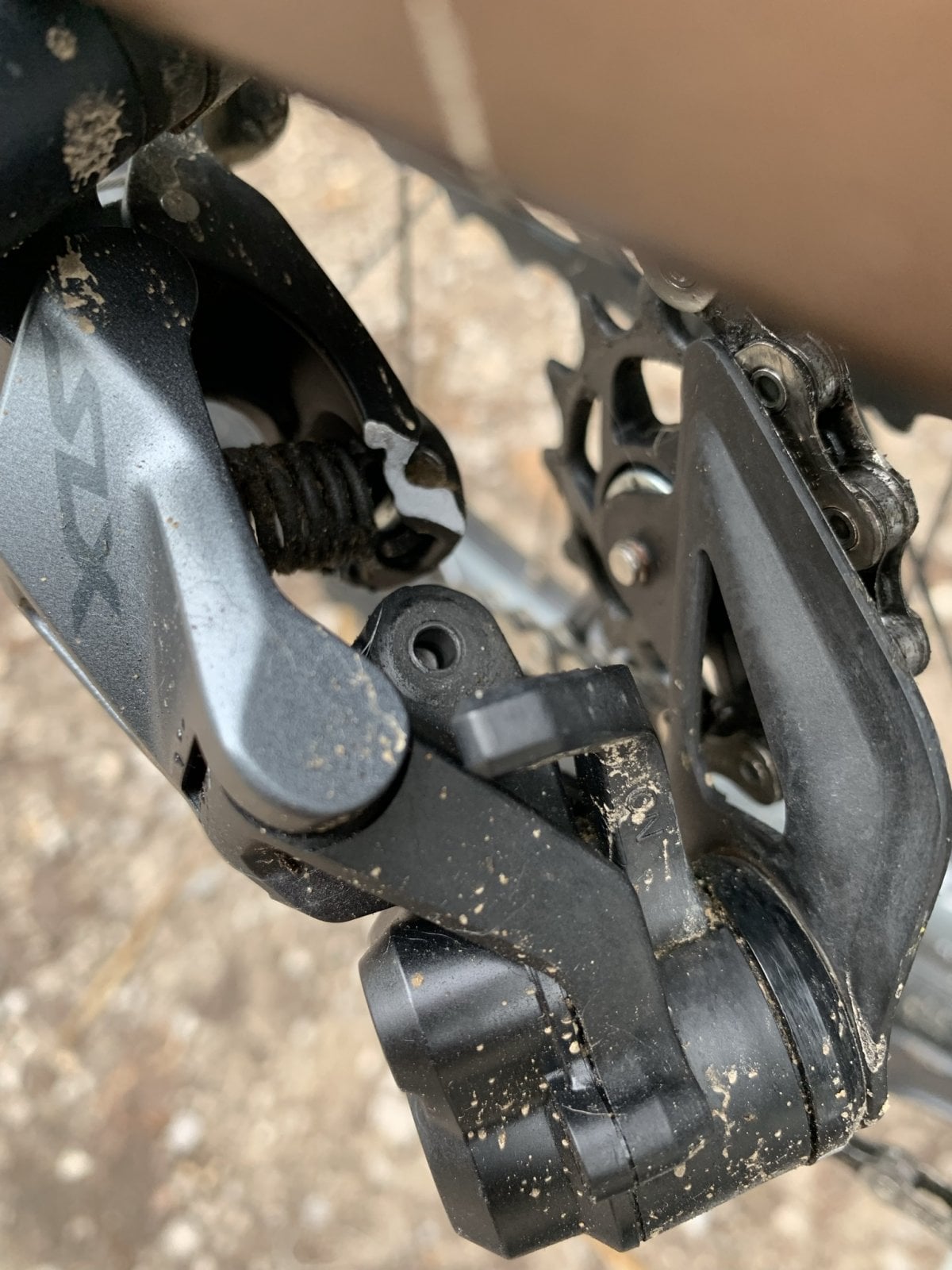

Until this year I've prob broken one derailleur in 30 years mtbing. I've broken 2 in the last couple of months.
Is it bad luck or are they getting crappier? The breaks look almost identical.
9,411
10,001

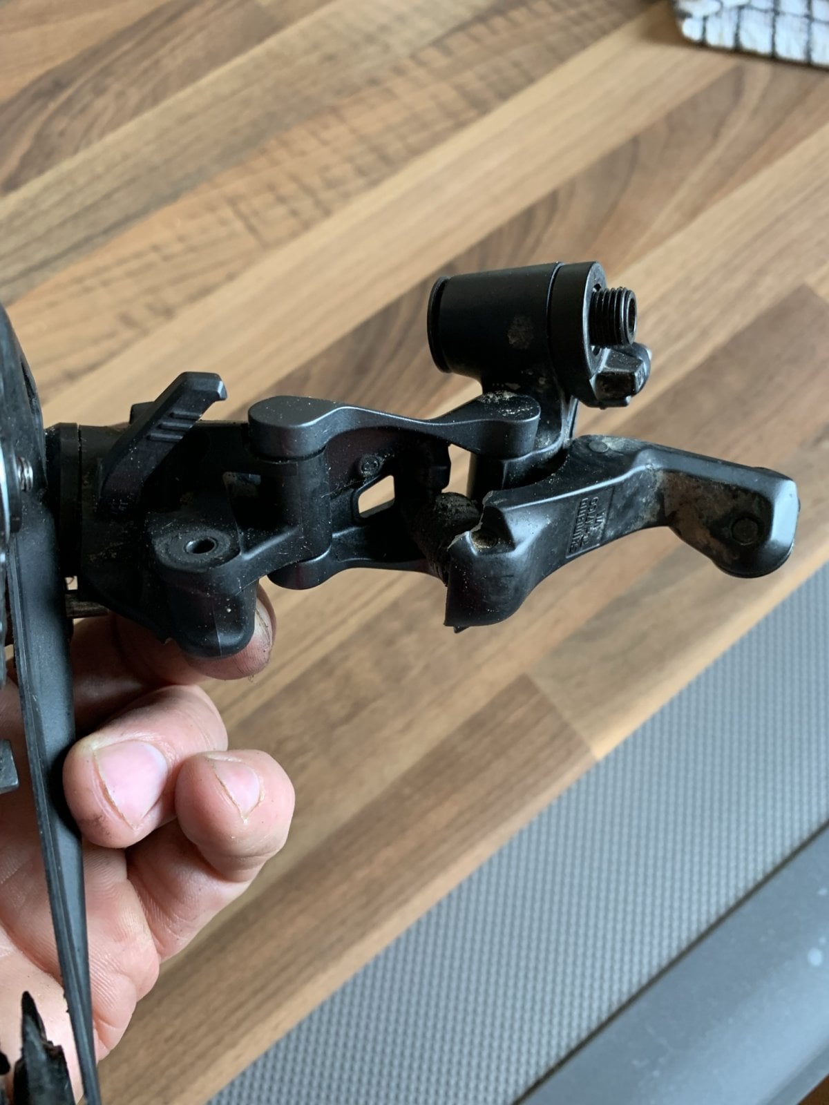

I broke an XT 12-speed and I was surprised to see that the section where it broke through the bolt holes was plastic.
I caught a young pine sapling and the main body broke in two pieces. No damage to the mech hanger.

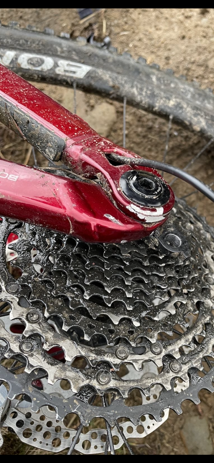

Both of my derailleurs (XT & SLX) looked exactly like the one above. I was under the impression that the hanger was the designed weak point to save costly derailleur replacements
madsen203
Mar 16, 2022
26
Bay Area, California
Not about saving the derailleur—it’s about saving the bike frame. True the hanger is the sacrifice piece in effort to save both but it’s main purpose is to protect the frame as if that damages, it could cause greater injury or expensive repairs. With carbon frames, repair is unlikely.

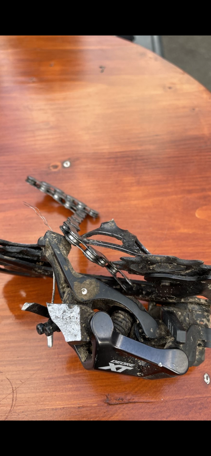

Send it back to Shimano they will send a new one, buy the next cheaper. model m8100 go to M6100 significantly less money, Shimano is backed up several months, the new one will come, just about the time your current one will be breaking again, then repeat the process I have done this at least six times, does not matter what the Shimano part is if you send it, they will replace it. Shimano has a two year guarantee, but more importantly they stand behind what they sell. Ignore what your LBS says go directly to Shimano, my buddy just got replacement disk and pads for free.
Warm Regards Ruti
ps I break at least one a year often more, e bikes chew up entire drive trains
kronos42
May 19, 2021
slx rear derailleur was just completely destroyed. I could not find an address for Shimano support for Germany. Only normal dealers are listed on the website as a service center. @High Rock Ruti where did you send your parts?

High Rock Ruti
I send mine to California
SHIMANO NORTH AMERICA HOLDING, INC. / SHIMANO NORTH AMERICA BICYCLE, INC.
One Holland, Irvine, California 92618 U.S.A.
Phone: +1-949-951-5003 / Fax: +1-949-768-0920.
I just send in the broken part i.e. the derailleur in a box with a return address, nothing else. The last one took about 3 months to come back, but ignore what your LBS and your friends say, send it they will replace it.
