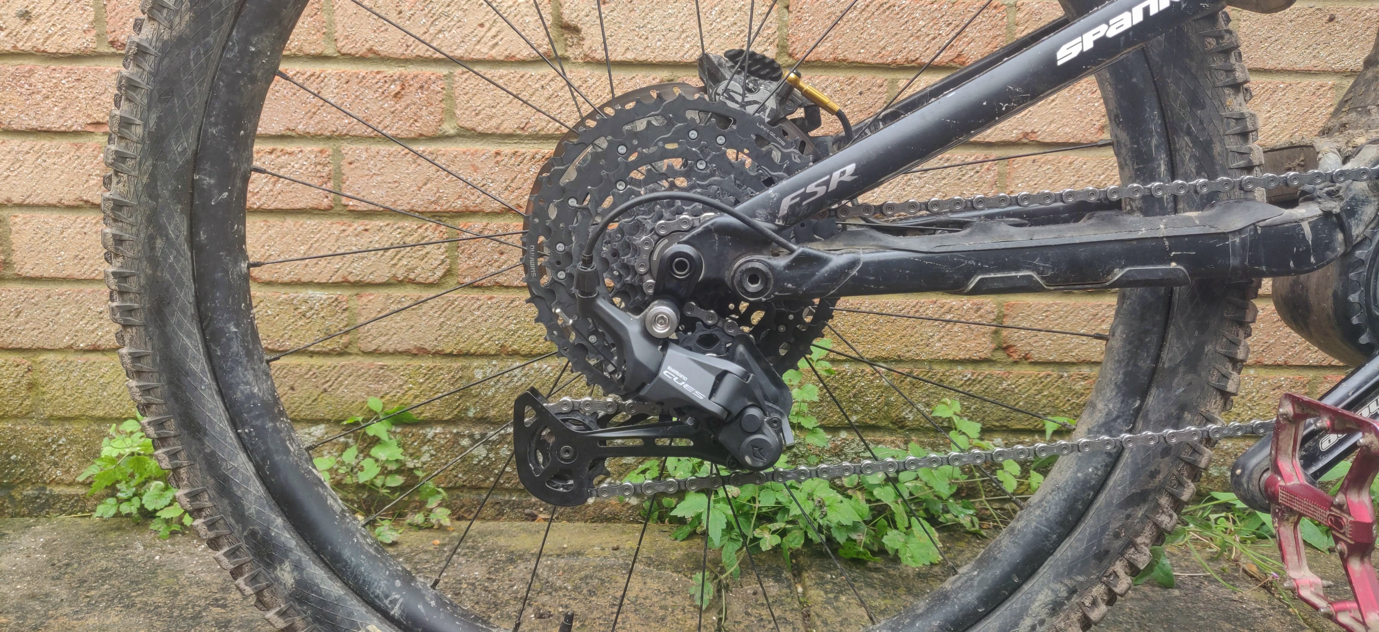

All installed & the shifting was poor. It either indexed fine on the big cogs or the small ones, but not both at once.

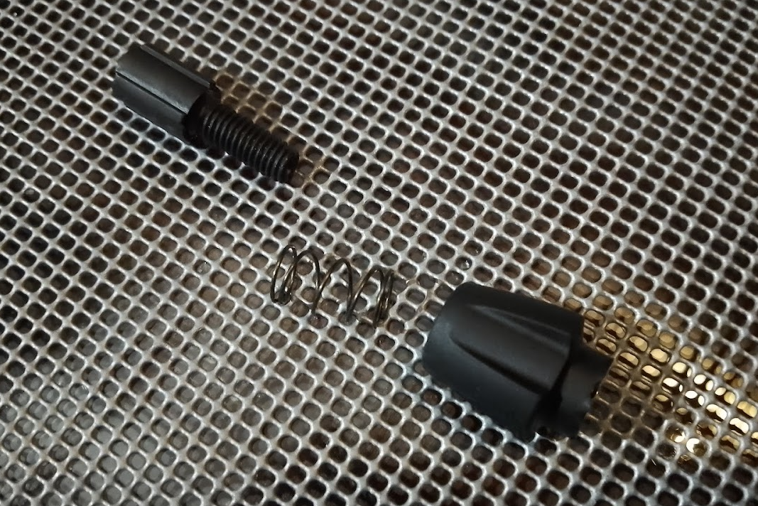

Additionally I don't like the adjuster on the mech, requires a bigger cable loop than usual.
The quality is also very poor as shown in the videos below, lots of slop in the mech in the main pivots & the cage pivot, plus a wobbly shifter. Possibly this causing the shifting issues?
I fitted a new gear cable outer a few months ago.
Additionally the 2 small cogs were loose after each ride. The lock ring wasn't coming loose as I marked it.
I may have fixed this now by tightening more than recommended. 40NM with the torque wrench then another few clicks by hand. I was really really leaning on the spanner to do this. I've never had to tighten a cassette up this much before.

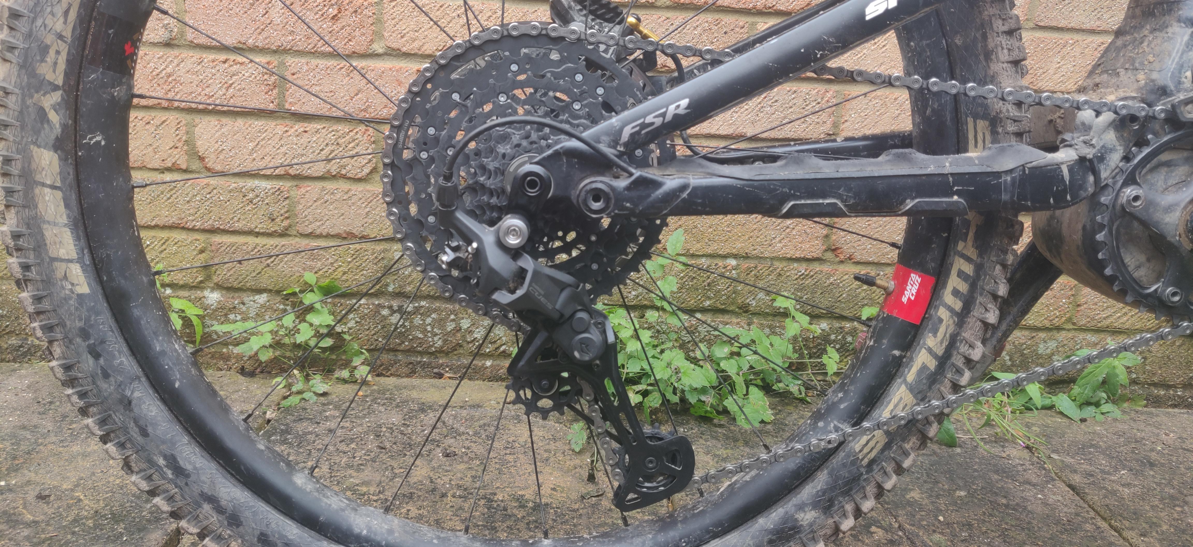

Despite the new hanger, the shifting was still not great. Appreciate the hanger may need straightening from new, but I didn't have the tool and the old hanger was ok with the previous slx hg setup.
Struggled to go up the cassette without an overshift near the middle. Any tightening of the barrel adjuster and the chain wouldn't downshift from the 48t.
I had thought the chain slightly too long, so dropped it from 120 to 118 links. This made no difference.

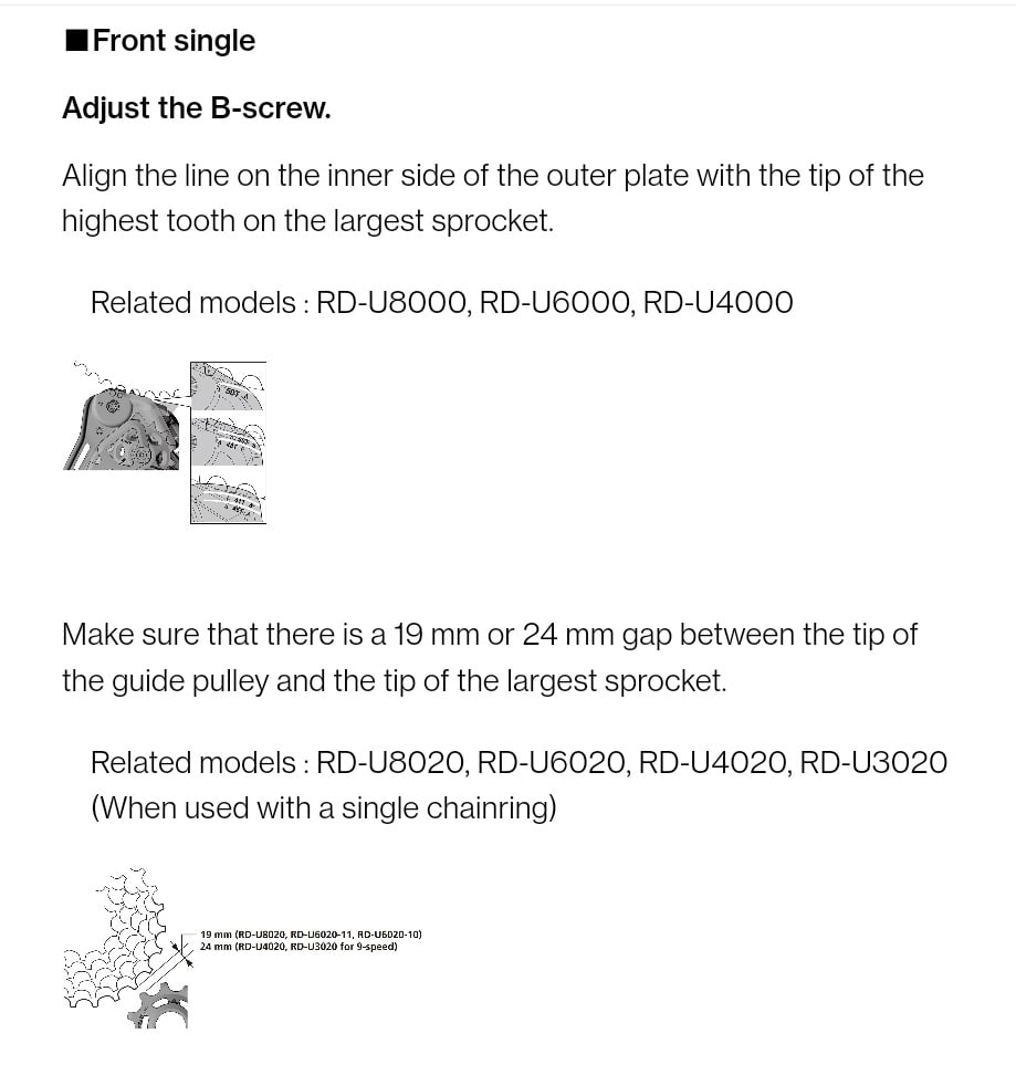

The derailleur has markings for b tension as below.
Based on previous transmission setup, this gap between teeth looked too big to me at 18mm.
The tech doc doesn't give a measurement for the u6000, but it's close to 19mm given for the dedicated 10 speed u6020 derailleur.
I wound the b screw out and dropped the gap as low as possible without interference and ended up with 10mm. Looked much better.
Now it started to shift cleanly. After a ride at the bikepark the shifting was faultless. No further adjustments needed, no crunching, ghost shifting, skipping. Absolutely 💯 %

For reference, you can remove the barrel adjuster and just use the insert, it doesn't gain you any length advantage over it being screwed all the way in though .
