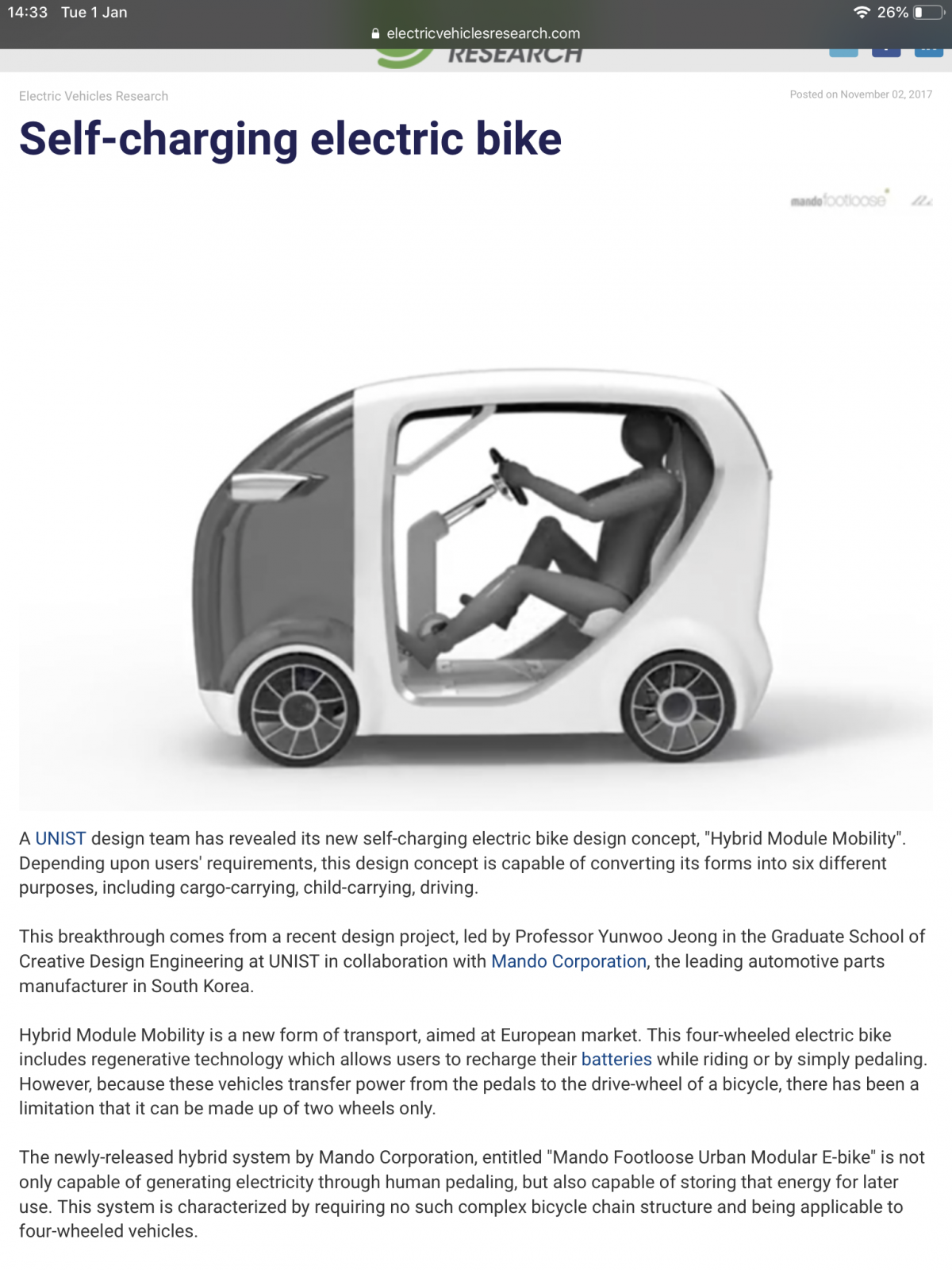

It appears the concept has already been invented.Now only a matter of time
