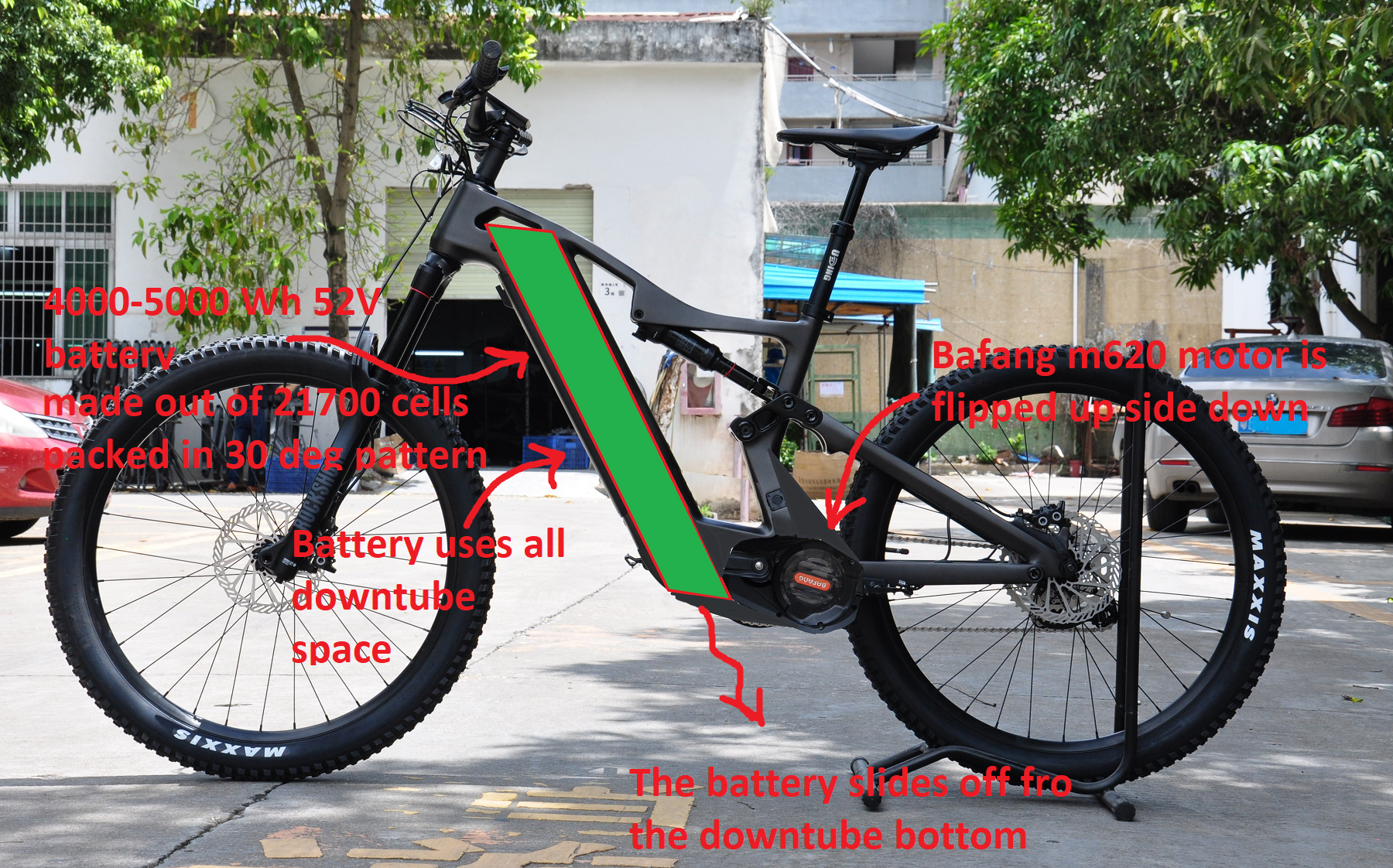

If you are seeking for the best seller product to develop I have an idea for you. Here is my dream bike - clean cool looking full suspension carbon fiber frame eMTB with 1500W (or maybe 3000W) Bafang m620 motor with larges possible to fit battery. The battery should use the whole downtube space from top to bottom. The Bafang m620 motor should be flipped up side down to free more space for the battery and to make this battery possible to be taking off the frame without removing the motor (I do not know if it is possible with the existing mounting spots of the motor, it may require to develop a custom bracket to be able to mount it up side down).
now we have the EMTB frame fit for bafang M620 750/1000w motor, mid-drive motor have no so big power 1500w-3000w, 1000w motor is the highest power available on the regular market.
and battery is bafang BT F25 820WH battery, no so big 4000-5000wh, that request a huge space on down tube.
of you can DIY the baterry with 21700 cell 5000mah, Capacitance may reach 2000wh, but regular factory can not supply it with big quantity, This cannot pass the European battery safety standards.
