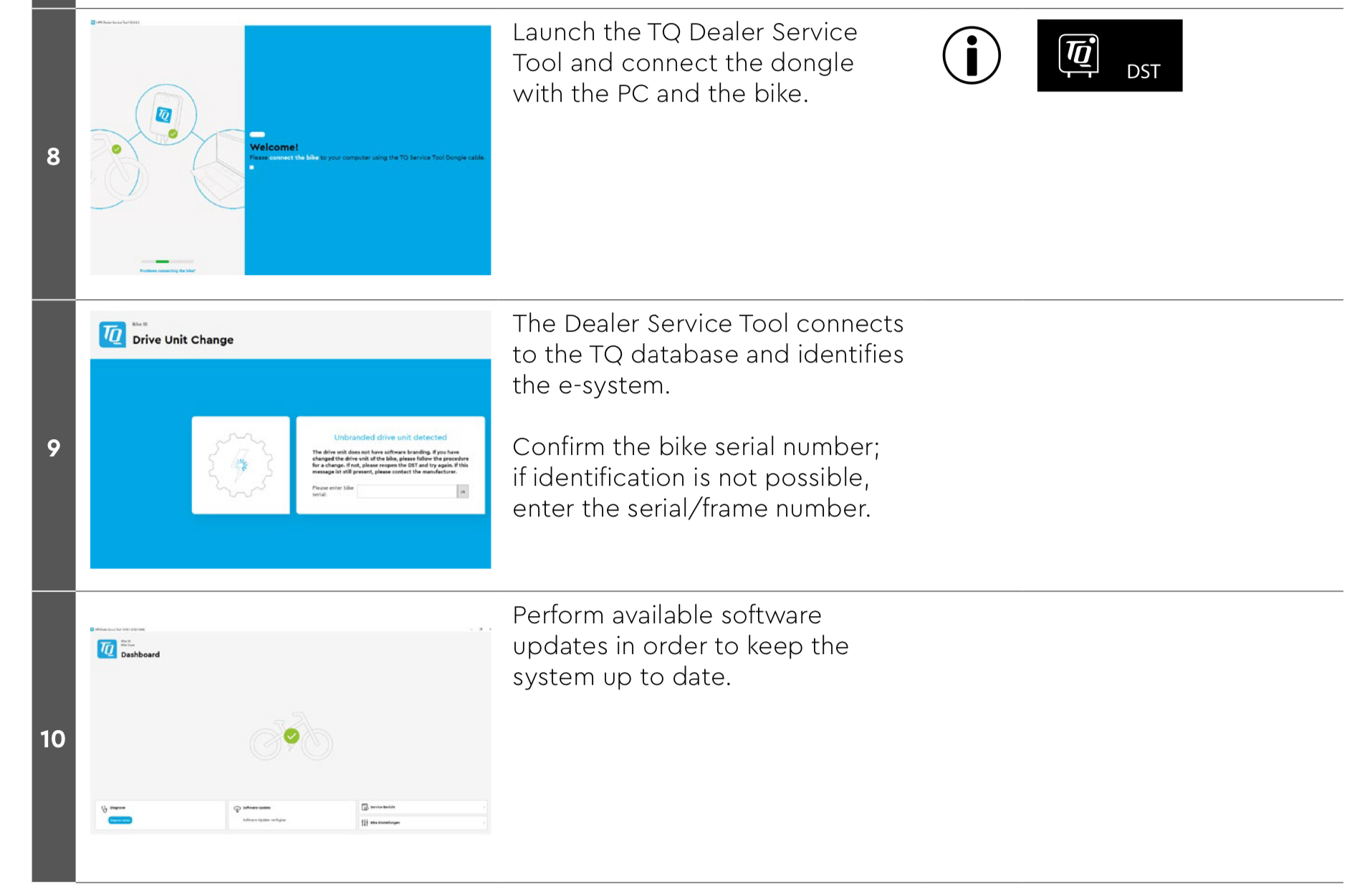

According to the TQ service manual page 16 you need to connect the motor to the TQ dealer service tool after installation and download the correct motor firmware (see screenshot below).
The TQ service manual is here: https://www.tq-ebike.com/fileadmin/...Manual/DRVE_Servicemanuals_EN_Rev0300_Web.pdf
In answering a question about mullet setup TQ says „To make sure that TQ-powered bikes are compliant with the allowed maximal speed, the software is set for each bike’s “factory setting” wheel size and cannot be modified. We are aware that this is not an ideal situation for the smaller rear wheel lovers. But, for example, by changing the rear wheel from 29 x 2.35“ to 27.5 x 2.6”, the cut-off speed will only vary by less than 1 km/h or 0.6 mph, which we find as an acceptable trade-off.“
