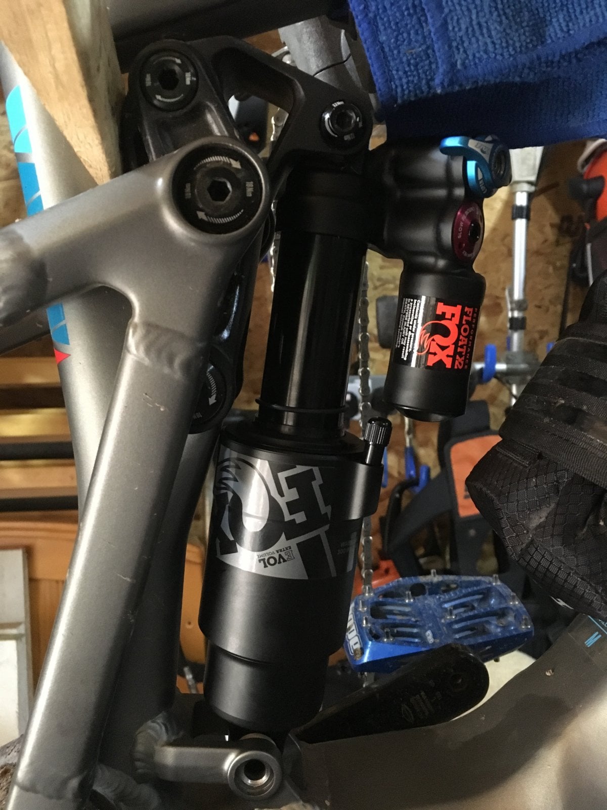

Hi guys, so I have been looking at upgrading the rear shock on my Sam2 to give some compression adjustment. After seeing a post on Focus' facebook page with an X2 Float installed I picked up an unused Performance Elite on eBay.
Unfortunately the shock in the pick must have been an older 2018 model. Since then they have change the can to a 300PSI max unit, which is larger.
Long story short newer X2 Floats will not fit, contacts frame and means the bolt eye is out by 1/2mm, bugger!
Anyhow, going for a DVO Topaz, wish me luck!
