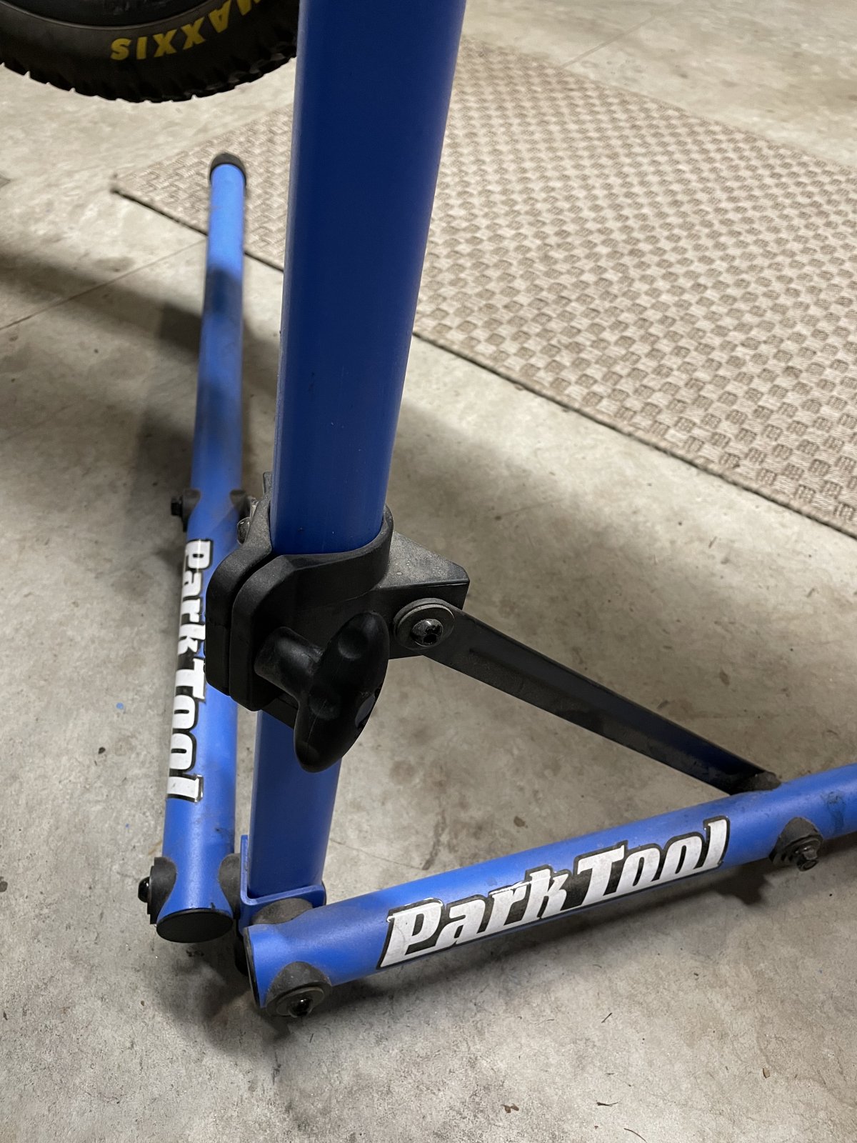

However…two mornings ago, I found my bike, and the stand, laying on the floor. The lower clamp of the stand had loosened and caused the entire collapse.

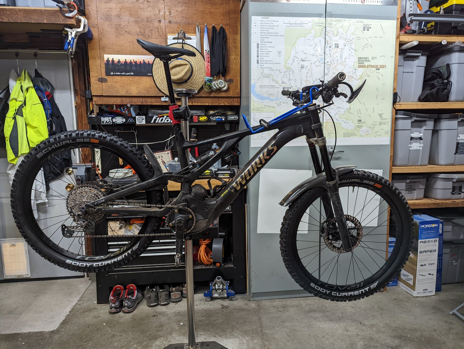

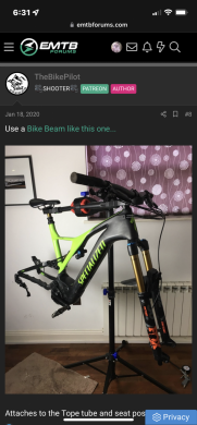

I can’t remember where I got the idea but here’s another method by @TheBikePilot .
I like using this method for carbon frames and I keep the “Bike Beam” on the stand. Fairly easy to attach once you get the “hang” of it. 🙄

Yes that looks like a good way to do it. Is this the same thing:
Yah, that’s it. I’ve used this for 3 years for my bike and for repairs on other bikes also. It’s fairly quick to attach. Mine cost about $55 CDN. I haven’t used it for the car/bike rack yet (which is what it’s for) but it seems to be strong enough.

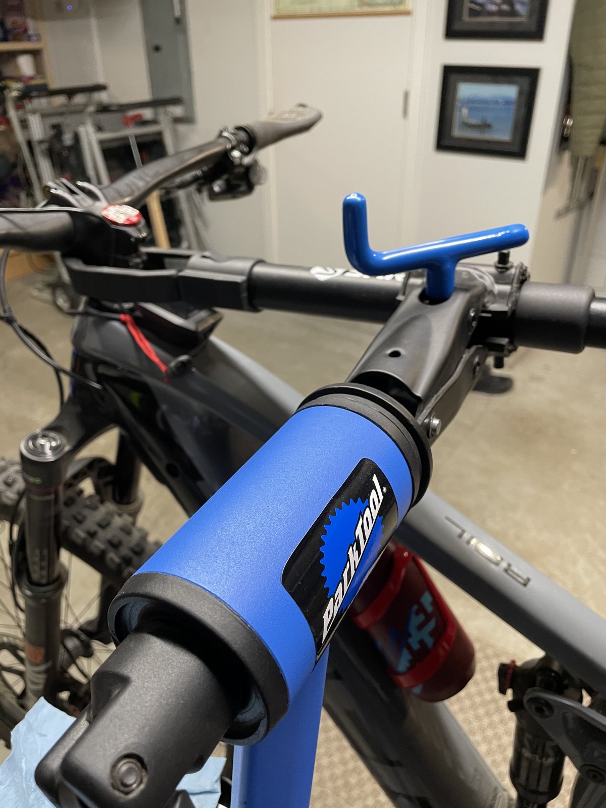

I clamp on the dropper stanchion (not the dropper body). I have seen one of the bike mags on YouTube suspend the carbon framed bike clean off the ground by that method and I know that my LBS does that as well. But I don't like that for a heavy emtb, so I leave the front wheel on the ground. If I need to work on the front of the bike, I leave the rear wheel on the ground or turn the bike upside down on to a floor mat.

Same here….carbon frame, I also did the same and left it on one night, had collapsed over night and found it on the floor :(

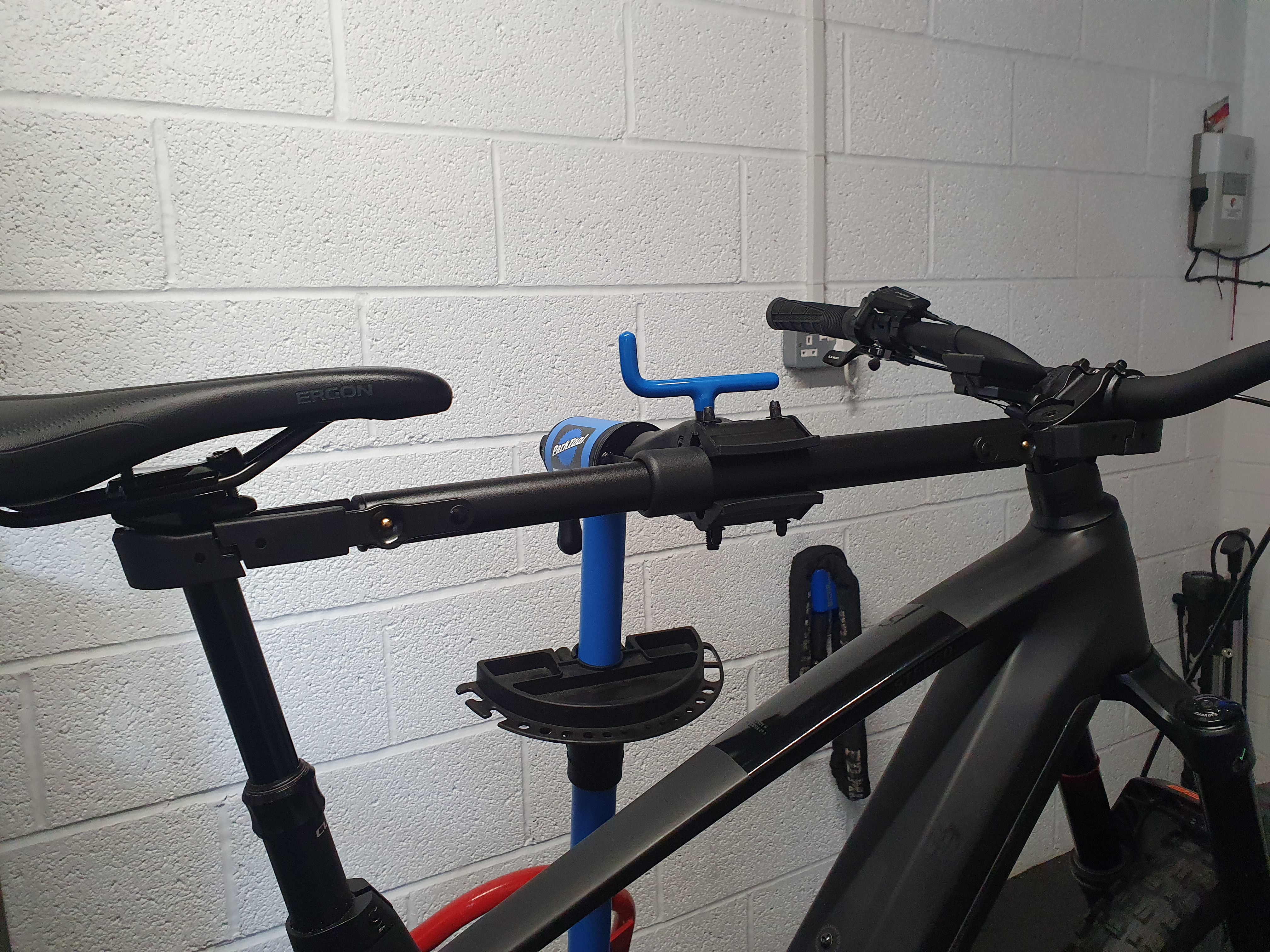

This was a great question, thx. I also have that Park Tool stand and I have one of those adjustable cross tube things that I used to use on my wife's Trek road bike since it was a step through and I needed it to attach to my older Thule style rear rack.
I have two new tires coming tomorrow and I was going to use the stand for the first time to swap out the tires. I would prefer to use that cross tube now that I've seen it being used above.

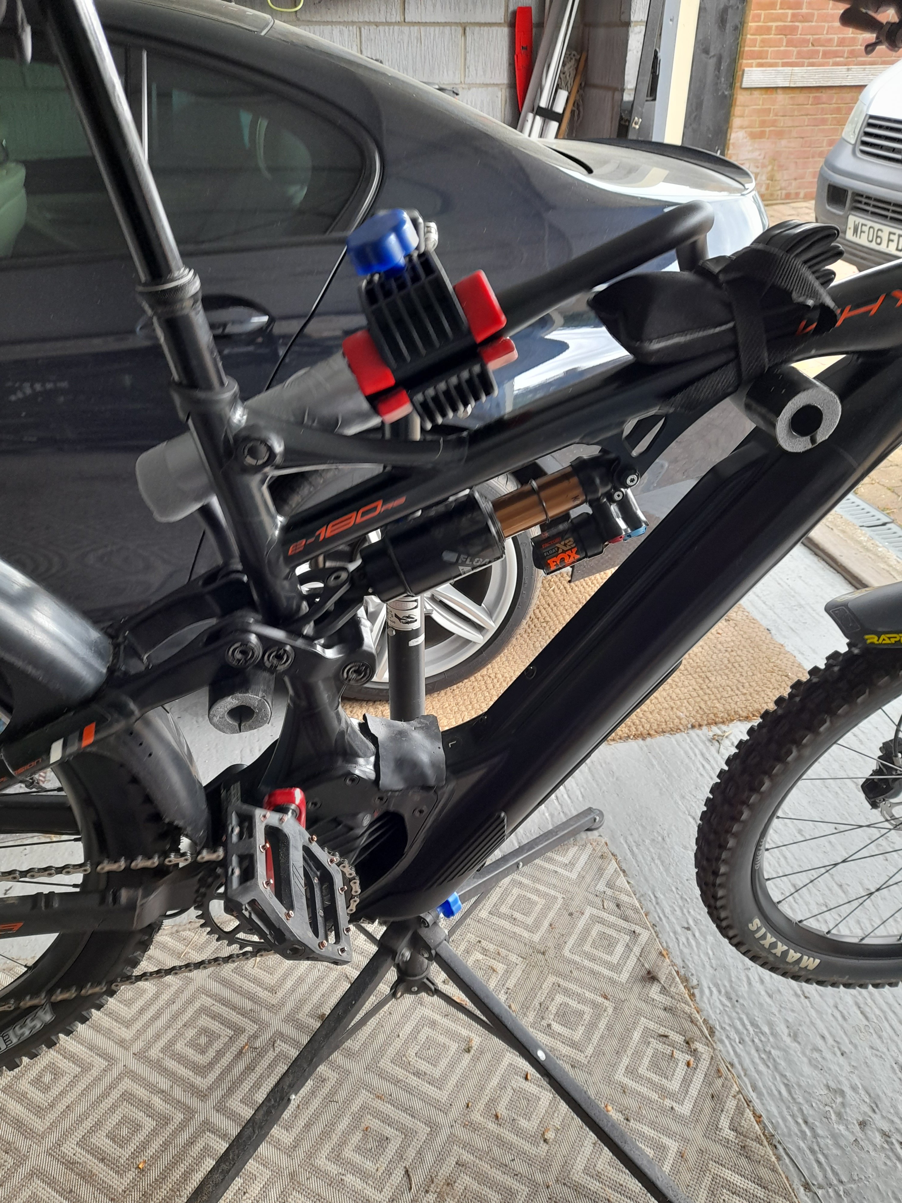

I use the Park Tool platform stand for most work on the bike. It can be mounted using the fork thru axle or the rear wheel thru axle if I need to work on the headset for example. It avoids hanging the bike from the top tube or seat post, neither of which I think are good for the bike. I also like the fact that the platform can be rotated 360 degrees so I can work on both sides of the bike without moving away from my workbench and tools.

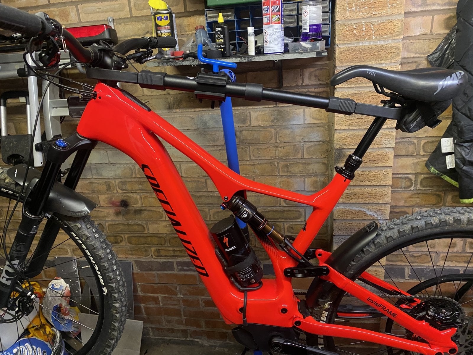

I also have an ordinary Halfords stand and have mounted in the jaws, a length of timber with 2 ladder rack hooks screwed in 28cm apart so that it just hooks under the top tube. It is quicker to get the bike off the bike without the need to remove the front or rear wheel. The bike is however free to move side to side with that arrangement so I typically only use it when removing the battery or doing a quick chain lube.

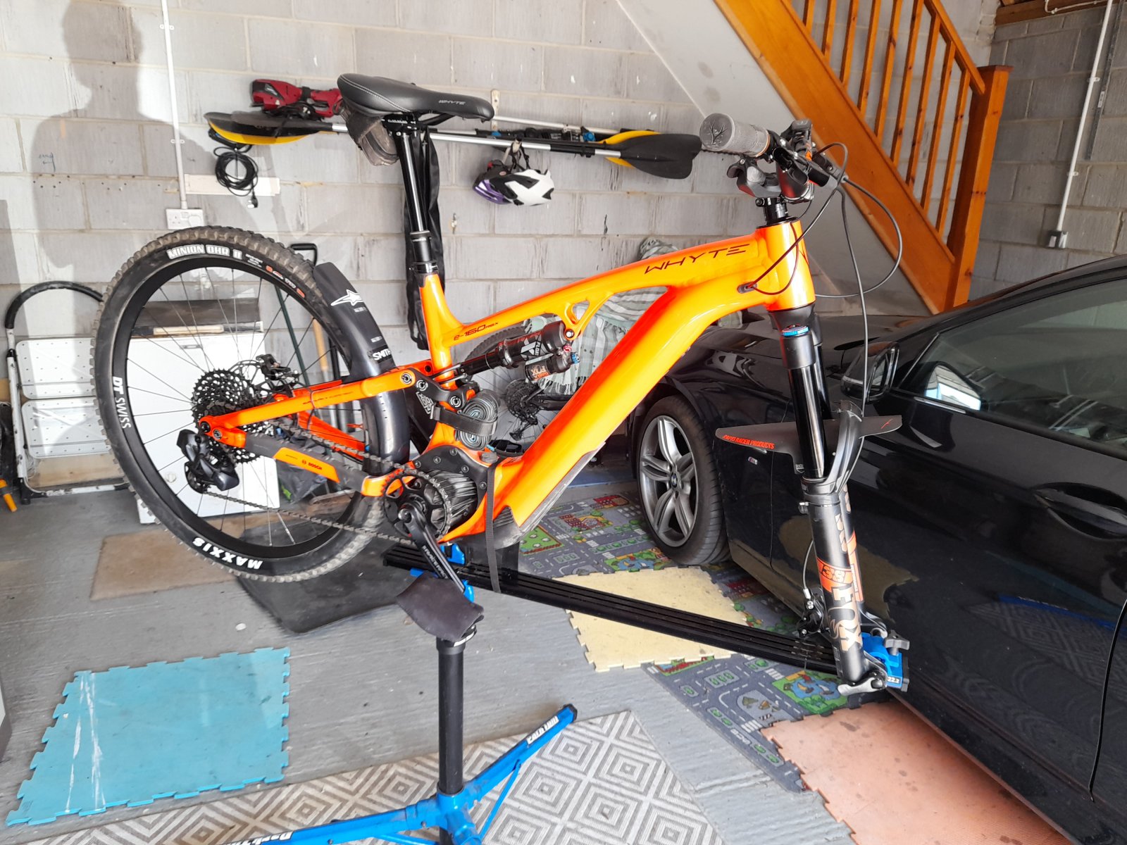

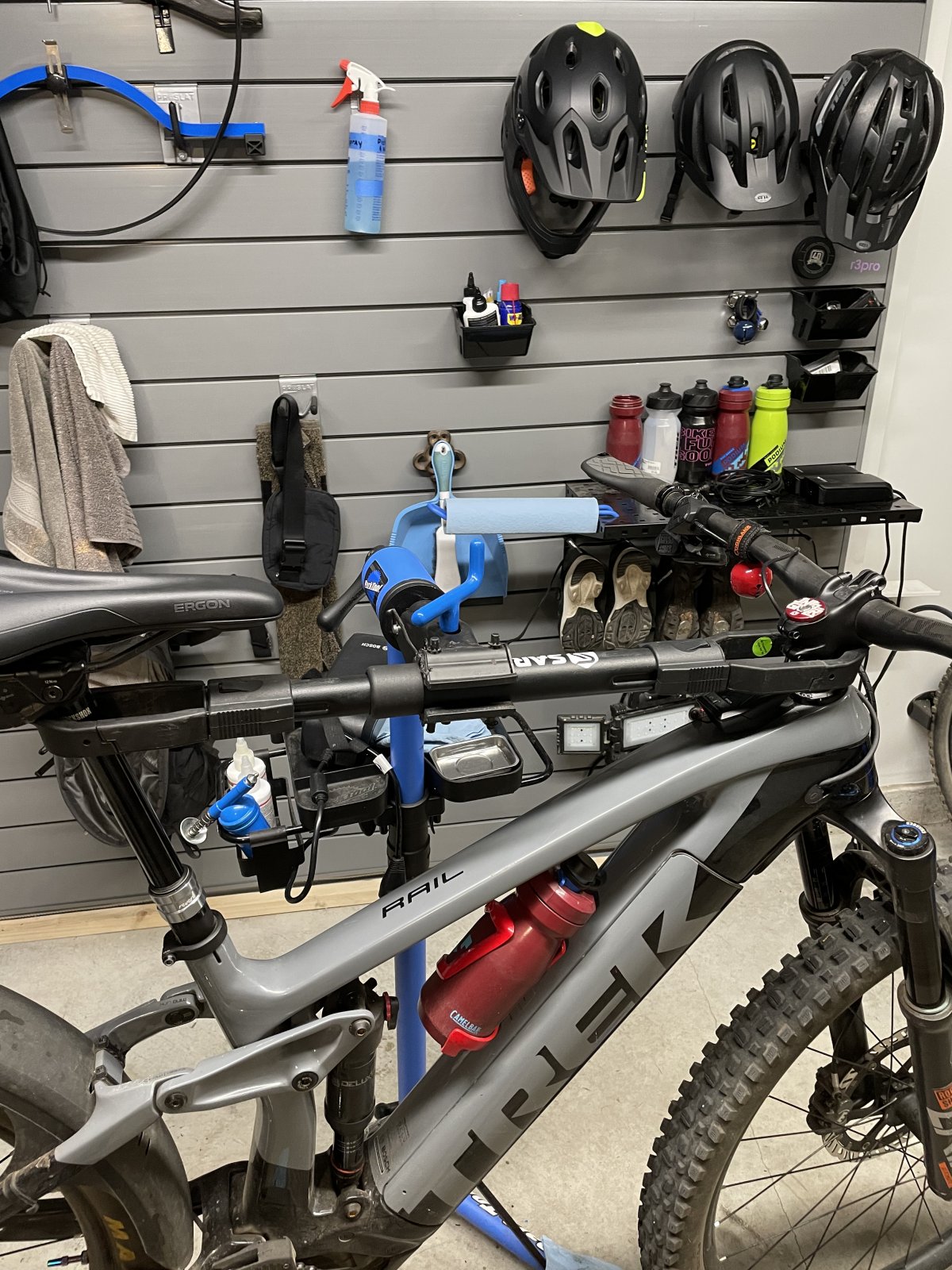

I clamp the seatpost on the ground and then lift and lock the stand. My 185mm dropper has the perfect amount exposed.
Custom stand to support the extra weight.

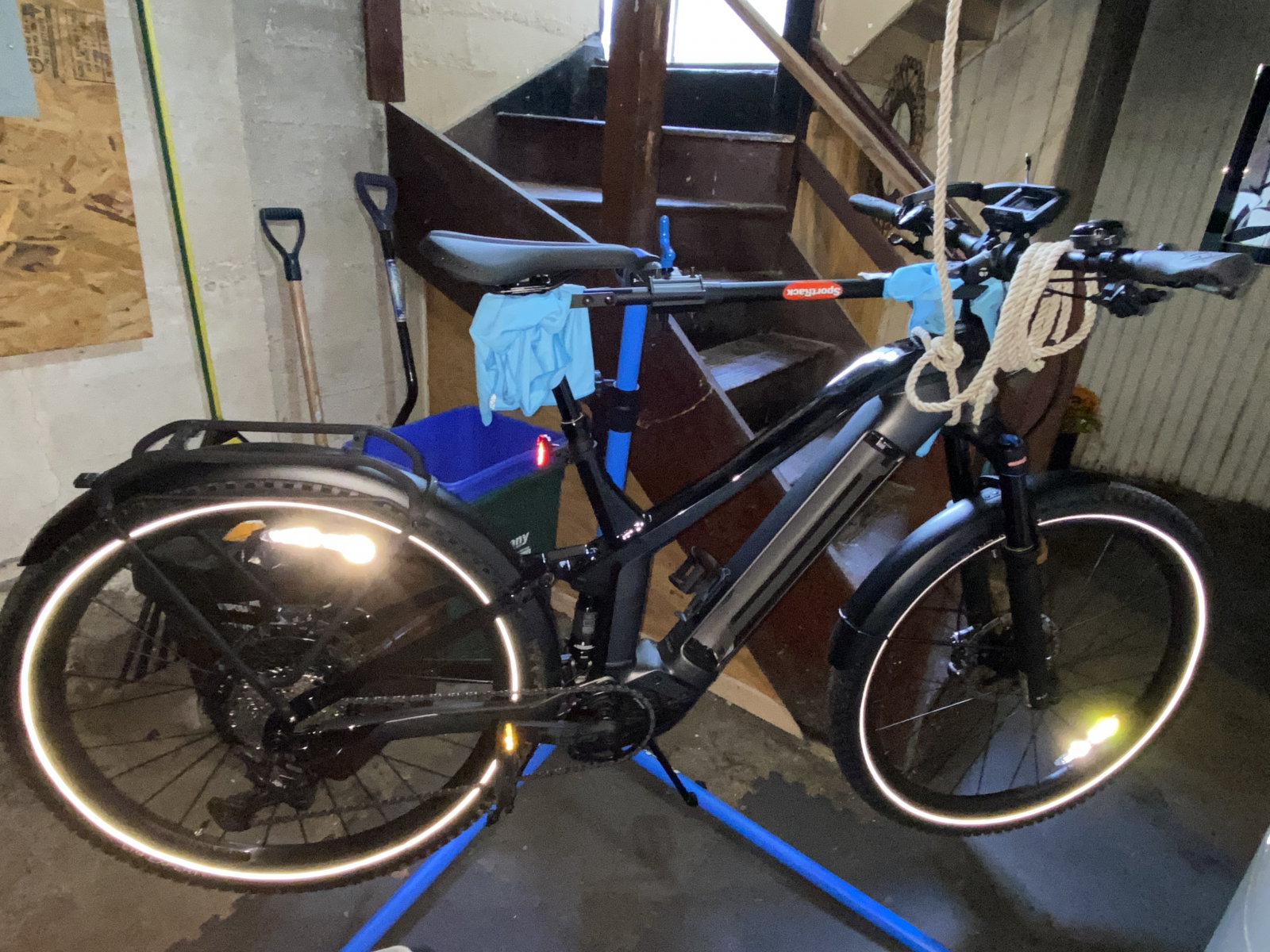

Just swapping tires out. That adjustable cross bar that others have mentioned is the only way to fly! I forgot to tighten the bottom Park Tool stand's bottom clamp suddenly the bike fell into me. The stands vertical member clicks into place, but the stand collapsed towards me without that bottom clamp tight 😱. Good thing I was standing next to it. I tightened it down and then attached a rope for added security. I used a couple of thin rags on the hooks even though they are rubber or plastic coated to protect the finish:

I like this idea....what are you using for the clamp on the seat post?

I could have used any clamp and decided on the feedback pro elite.
I think it's better than the park heads. The efficient velo tools was my first choice, but I couldn't justify the price.

Where have you found that lower clamps?
Dor you have a picture of the srew used?
I have the same problem. When I'm working on my bike in the stand it allways folds down.
I do it as tight as I can, but it still drops. It's a major problem as I've had my old bike fell over in the stand like that and bend my crank arm.

That happened to me once using the park tool stand. Discovered my bike and the stand laying on the floor. The clamps on the stand had slid. I tightened the screw(s) then added a little bit of tape so there was no sliding action going on. I don’t fold my stand.

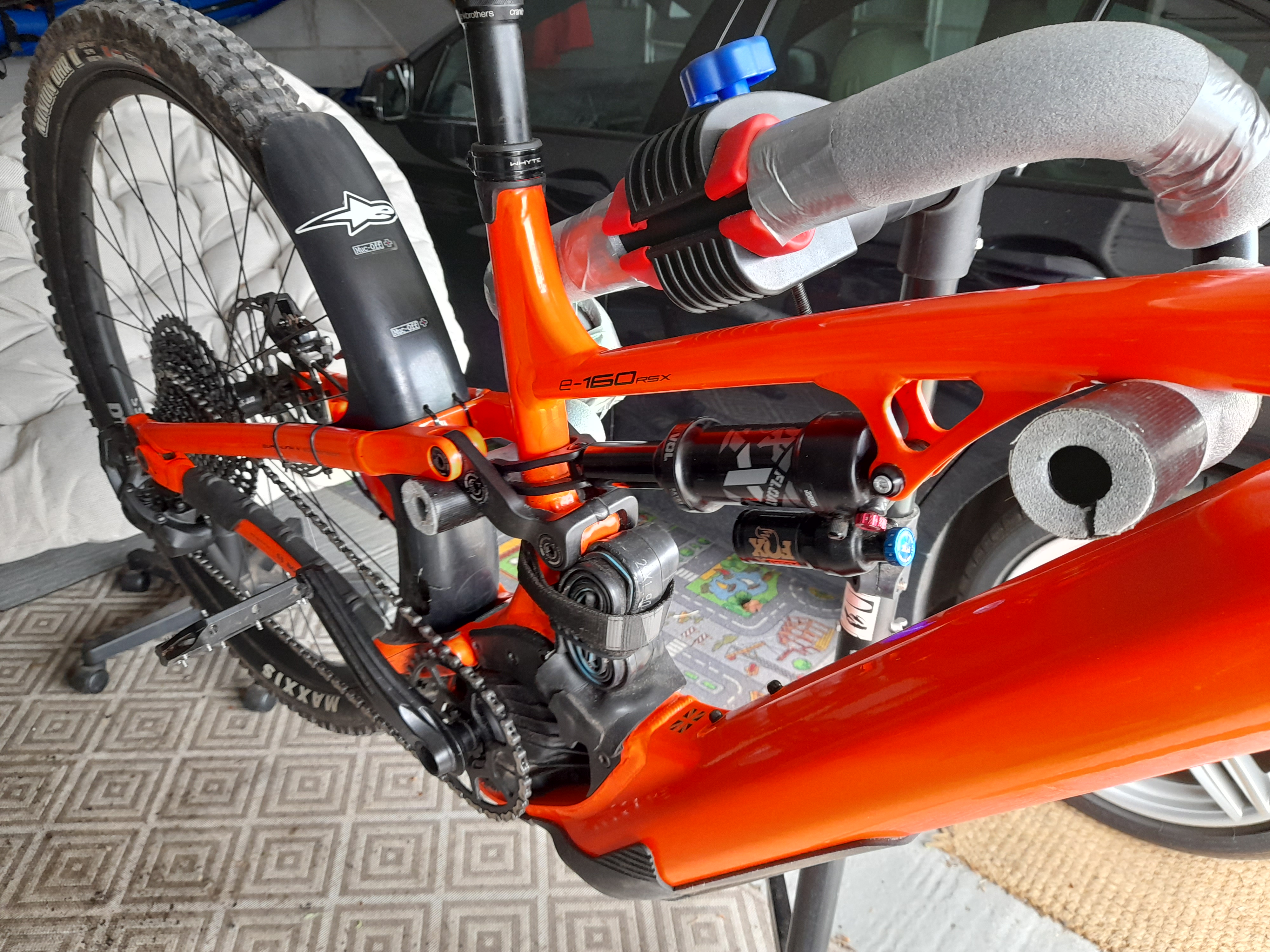

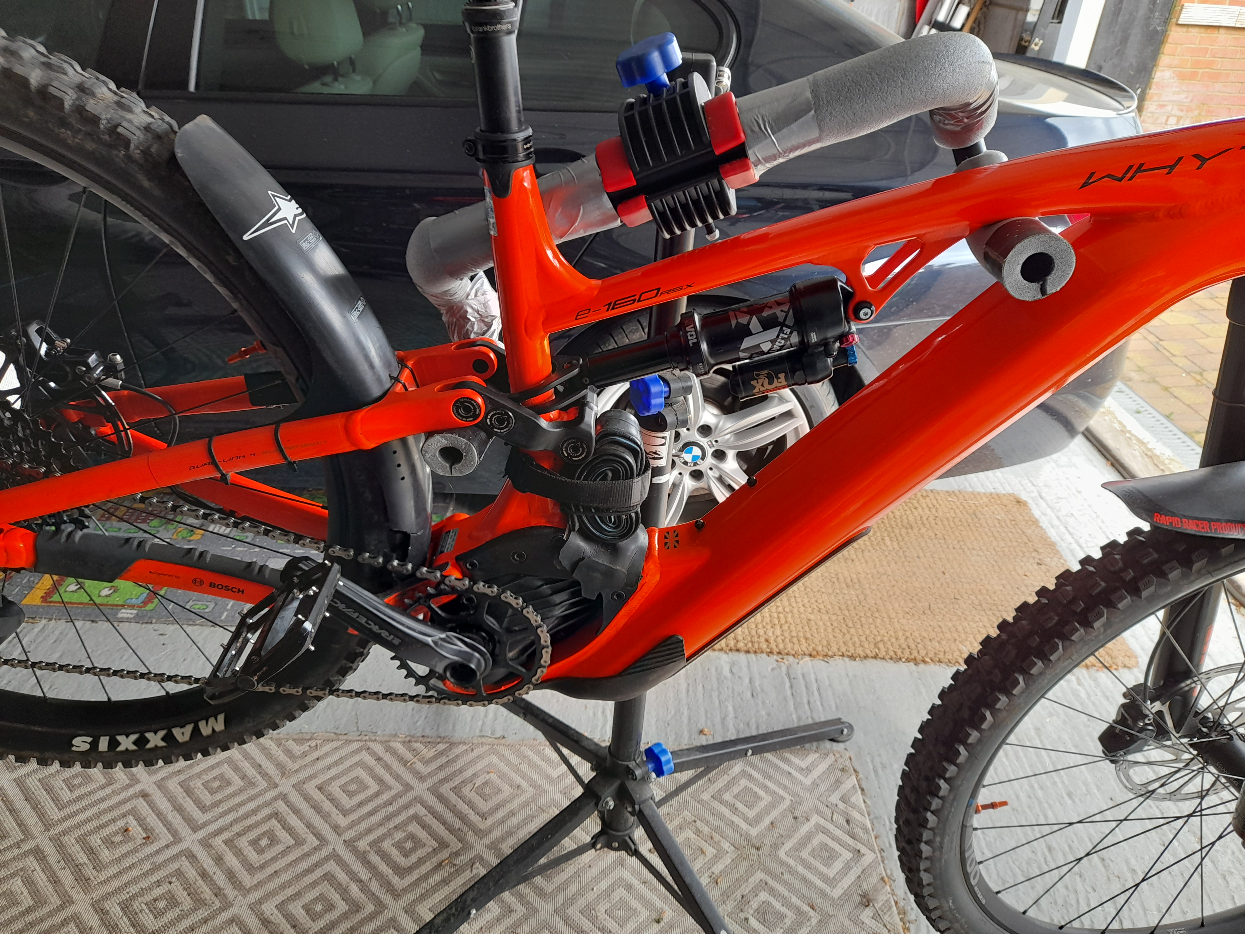

£10 440mm handlebars from CRC. Whyte e160RSX and Whyte E180RS both fit.
ps I dont trust the height adjust clamp on this cheap Halfords stand............I drilled through and put a nut and bolt through it. It does not need to be a djustable.
I use this set up for cleaning and lubeing..................my Park Tool platform stand for maintenance work.

Another +1 for the Halfords (or any other suitable brand) false crossbar, definitely my preferred method for almost all jobs that need doing on the bike including washing.

I have changed to the false crossbar for most jobs now. It is probably the most stable option. I still use the drop handle bars option if working on the headset.
My 3rd option is the Park Tool platform stand which I use for .ore extensive maintenance work. I modified the BB section of that stand to better support the motor bash guard area as opposed to the original design suited to analogue bike BBs. The big advantage with the platform stand is the fact it swivels so both sides of the bike can be worked on from the same position by my workbench.
