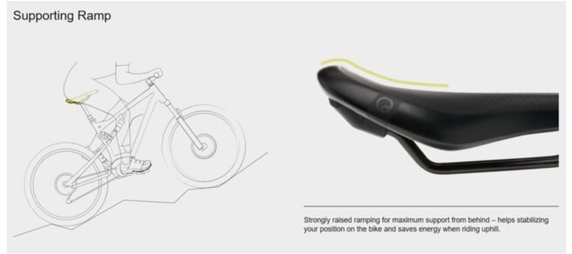

Ergon has done a good job with saddles designed for different styles of riding and anatomies. I’ve used brands like WTF, Sella over the years and gravitated back to Ergon for road & mtb.
