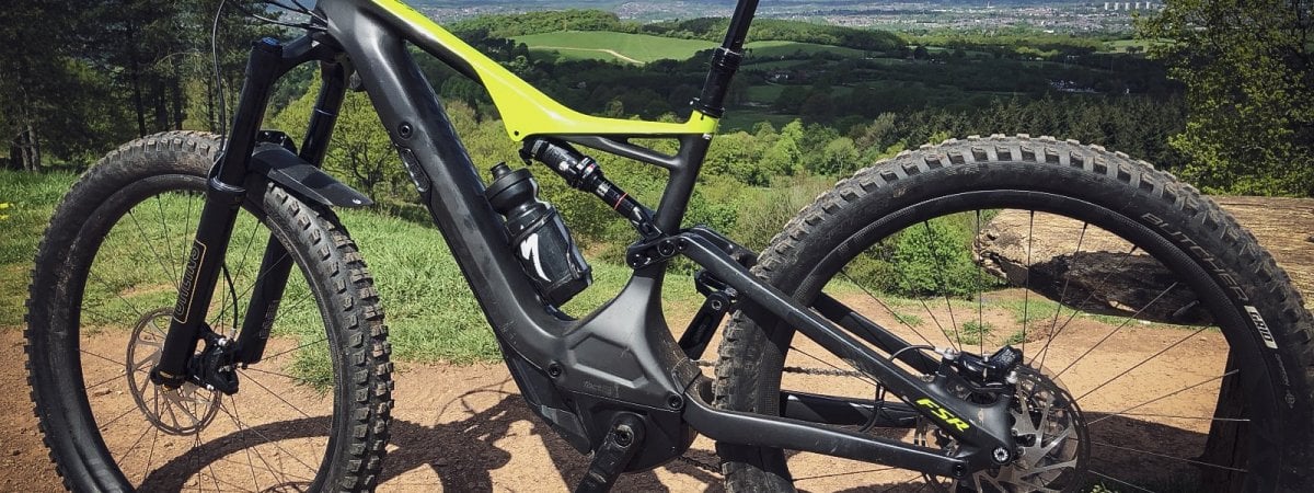

So I have just passed the 2000 miles on my levo, and I thought I would post a not so little story of how I have got on with it since November 2017. Originally I was having the new Stumpjumper but having had a go on my sister-in-laws Pendleton e-bike I was intrigued as to what an E-mountain bike would be like? So called in to my local (1.5 miles from my house) Specialized dealer who has been supplying my bikes for over 20 years, he had an 2017 Levo test bike that I could have for the weekend.
The first thing I noticed was the weight, but the power alleviated that straight away, an hour of trail riding and I was converted! Again the weight is on your mind all the time but the pay off with the power makes it so much fun you soon forget, so back to shop to order a 2018 model that was about 3-4 weeks from launch.
I had original thought of having the base Levo but once I had added a few upgrades I was at the Levo Comp price, so it seemed easier to go for that, but again I was thinking about all the money I had spent on upgrades on bikes over the years, So I decided to go for the S-Works (telling my wife I had ordered a Carbon Expert ??) I had also ordered her a Comp Carbon ?, so bikes ordered now just the wait for them to ship from the U.S. to the U.K.
Monday 27th November was collection day, excited ?, picked the bikes about 3:30pm had a bike fit so that they were set up perfectly, once my wife had got over the shock of the bikes I had ordered (we are still married)only a short ride that night but since then I have rode most days, wind, rain or snow and now sun!
So firstly let me say Brothertons (Specialized Dealer) and Specialized UK have been amazing!
Let get the problems out the way, first wash with a hose and the wheel stickers came off, now this is not a major thing, but on a Specialized I expected better, Specialized said they would send some new ones out, I preferred them Carbon black anyway so had no intention on putting them back on, next the paint on the rear shock hinge chipped away with movement, Specialized sent a touch up pen and a sizeable credit to spend on Specialized goods at Brothertons ?, next the rear mech cable snapped, replaced no questions asked, this was all before the 100 mile check up. Then the remote handle bar switch failed, new switch fitted more credit from Specialized?, then the motor kept cutting out, Specialized sent out a new motor, new motor fitted, but it was making so much noise they had to send another, motor 3 fitted, all good, a few weeks later remote handle bar switch failed again. It was getting to the point that I had no trust in the bike when going out.
Unbeknownst to me Brothertons had been speaking to Specialized about replacing the bike, this is where supporting you local bike shop buying 10 bikes in 20 plus years helps, Specialized said they should be sending a new bike out over night! The old bike had done 1,300 in 4 months, new bike arrived on the 18th April and I have not had a single problem with the new one??, I must say don’t be put off a levo as my wife’s Carbon Levo has not had a single problem.
Now the good stuff, the most fun I have had on a mountain bike for years, it puts a smile on my face every time I ride it, I was always great a getting up hills on my Stumpjumper but always burnt my self out before getting to the the fun down hills. Now I don’t have that problem, S-Works feels like my Stumpjumper with a motor, the extra weight loss makes it feel like any other manual bike and with the battery out maybe lighter, with the motor out it’s definitely lighter?.
Front Fork is Öhlins RXF 36 150 mm - what can I say, best forks I have had under me, always loved Fox, never liked Specialized own, I like mine stiff and these seem to make me feel planted into the corners, not messed much with the settings.
Rear Shock RockShox Monarch RT3 Autosag 135mm - it was supposed to be an Öhlins rear but Specialized had problems with it in development I hear, again it’s plush when it need to be and perfect on descents.
Motor/Custom Turbo 1.3 Brose Drive - Other than the problems with my first bike motor, it’s been perfect, even in 30 degree heat we had a few days ago, I have heard people say that the Carbon would not be good a displeasing the heat but I have had no problem with over heating. Can’t compare to the old motor but the power is smooth, only use turbo when it’s very steep, as I tend to go places I would not on a manual.
Drivetrain SRAM XX1 - very quiet on the trail, but changing gears uphill does occasionally make it clunk, but that’s more me not reading the terrain. Shifter is quick, love the thumb knuckle down shift.
Brakes SRAM Code RSC - wow, just wow... the best brakes I have ever had! They are frighteningly amazing, I did now realise until I had my wife’s Levo Carbon for a day and almost killed myself riding a trail I ride all the time the same way I do on my S-Works. If you are going to spend money on an upgrade on your Levo then these would be top of my list.
Seatpost Specialized Command Post IRCC - I tend not to use it much, I like to feel the bike between my legs so it stays up.
Handlebar Specialized Trail Carbon 780mm - the only problem has been riding a single track through some very tight trees it was close?, my wife had hers cut down to 720mm, I will give hers ago and see how they feel.
Wheelset Roval Traverse SL Carbon - rotation weight definitely helps, could feel the difference when I was on my wife’s bike with alloy wheels, again if I was looking at Levo upgrades it would be second on the list,
Tires Specialized Butcher Grid 2.8″ - you read how amazing some tyres are, butI think you get sucked in to thinking they will take any thing you can throw at them, a few times I have taken corners and they have slid away, but that might be my skill more than the tyres ? but they roll over anything.
Battery 504 - the only little problem I have had is occasionally getting the battery back on if I have taken it off, just getting the pin lined up. Charging in full is about 3 hours. I always clean the power connector after every ride so that the magnetic connection works ok. I have never run the battery out I did a 46 mile ride the other day, canal ride, decent most of the way their, lots of uphill locks on the way back, got home with 20% left. I’m 5ft 10” and 14st just for your information ?
Maintenance - I’m one of those people who likes a professional to do it so other than cleaning, degreasing and GT85 it goes to the dealer, I’m lucky it’s around the corner and I know it’s done right! I do make sure I cover the handle bar switch now when GT85, I know it’s a sealed unit but just in case,I also clean the speed sensor just inside the rear of the frame.
I needed to check the weight for the bike rack, both bike are medium
Levo S-Works 18.5Kg (no battery) 21Kg with battery, full water bottle and saddle bag with a few things in.
Levo Carbon 19.8Kg (no battery) 23Kg with battery, full water bottle and saddle bag with a few things in.
So just over 2000 miles done since November and I have to say I’m back in love with mountain biking, I always loved it, but now I love going up hill too, I was on the fence about e-bikes but I ride more now than I ever have, on Sunday I went to ClentHills my local trail in the midlands and it was 90% e-bikes ?that’s the a big change from last year. It’s great for starting conversations too.
Thanks for reading?

Hi Cyclone,
I true to answer them in order...
The feel between the Comp Carbon and S-Works I did not think would be to much but boy was I wrong they are like two completely different bikes to ride. Remember the Comp Carbon is set up for my wife who is 5ft 4” and 10st and I was not allowed to change her set up or face the consistencies ? The Comp Carbon is a very slightly heavier 8m Carbon compared to the S-works 11m, I’m sure with the same parts from the s-works on the comp Carbon you would not notice. Obviously the rear swing arm on the Comp is alloy making the back end heavier plus alloy wheels, so that changes the feel. The Carbon on the S-Works is a mat black finish compared to a glossy finish in the Comp Carbon, I like both, I would of like all black and for it to have that lattice Carbon look, but thats just me. My wife had the Red top bar model only because the chameleon blue/green was another two week wait, but that’s my favourite on all the levo’s this year.
The handling, the comp Carbon handles like a dream, but I had been riding the S-works for 4 months before I rode the Comp Carbon, so it felt different straight away, but trust me on single track it performed superbly, never did it feel like it would not do what I wanted.
The Ride, felt different mainly because I’m 4st heavier them my wife so the rear sat lower and her seat is lower too, like I said she did not want me to change anything, but not once did I bottom it out. On the road I can only say I felt like I had to put in a little more effort on the Comp Carbon, again due to the wheel rotation weight and little extra bike weight, I just put up the Eco by 5% to 30%? trail stayed at 60% and turbo at 100% ?. On the road is not these bikes true environment but both bikes, have enough power the to get away from the lights in race mode fun, I love to see drivers faces ?.
The breaks, as I said before this was the big wow factor for me, the s-works are instant, throw you over the bars if you pull the front to hard instant! I’m not saying the Comp Carbon are bad but after riding the S-works you notice it instantly. Once I had got used to the Comp Carbon breaks I had no problems at all on fast corners, my wife’s leavers had be dialled in as she has a small finger reach, so they are already closer to the bars. The SRAM Guide RE on the Comp Carbon are a 4 piston break so no problems in stopping, it’s just that instant scrub off of speed with the SRAM Code RSC coming into a corner is not as goo is the only way to describe it as the S-Works. If you have funds £230 to upgrade then you won’t regret it! Don’t do it until you have tried the SRAM guides just so you know how good the SRAM codes are.
Front shock, ohlins are the masters of suspension not that the Rockshox Revelations aren’t good because they are, they now have 35mm tube so are inline with the Pikes and we know how good they are! But I like the stiffness of the Ohlins you feel the small pebbles, not harshly just through the bars like light morse code, with the Rockshox its more smooth and relaxed, but it’s personal preference, both are excellent.
The difference between the bikes (both medium) was a shock to me, it’s not one big thing, it’s all the small thing that make the big diffrence, weight, wheel rotation speed, frame stiffness they all added up, the Comp Carbon is an amazing bike that will do more that most people can throw at it! Like me most people on the forum are not pro riders just want to enjoy e-mtb your not going to be entertaining any competitions, if I had to choose between the Standard and the Carbon Levo I would go with the Carbon if the funds allow? The £750 difference between the two is worth paying. So when you replace or upgrade parts you have a better stiffer frame as starting point. On a side note I was told by my dealer (Specialized, not drugs) that the motor is mounted differently in the Carbon bikes than the alloy bikes too.
Weight of the bikes might be a little off as I stood them upright on the bathroom scale but it’s about 1.8kg difference with the battery on. The batteries are the same.
As for the S-Works I’m lucky enough to be in a position to afford one, it’s taken me almost 30 years from my humble beginnings on a Hardrock’s, to Enduro’s and Stumpjumper’s, I thought S-works can’t be worth the extra money you have to pay they can’t be that much different? Oh how wrong was I....
The only down side to the S-Works is I feel guilty some times because of the cost, but that soon stops when I’m flying down the trail.
If you have anymore questions please free to ask, I’ll do my best to help, what ever levo you choose you will love it ?
