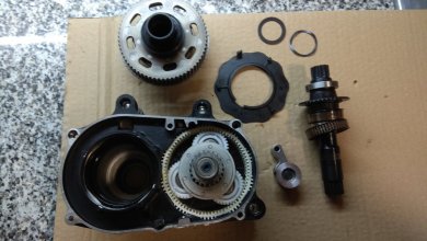

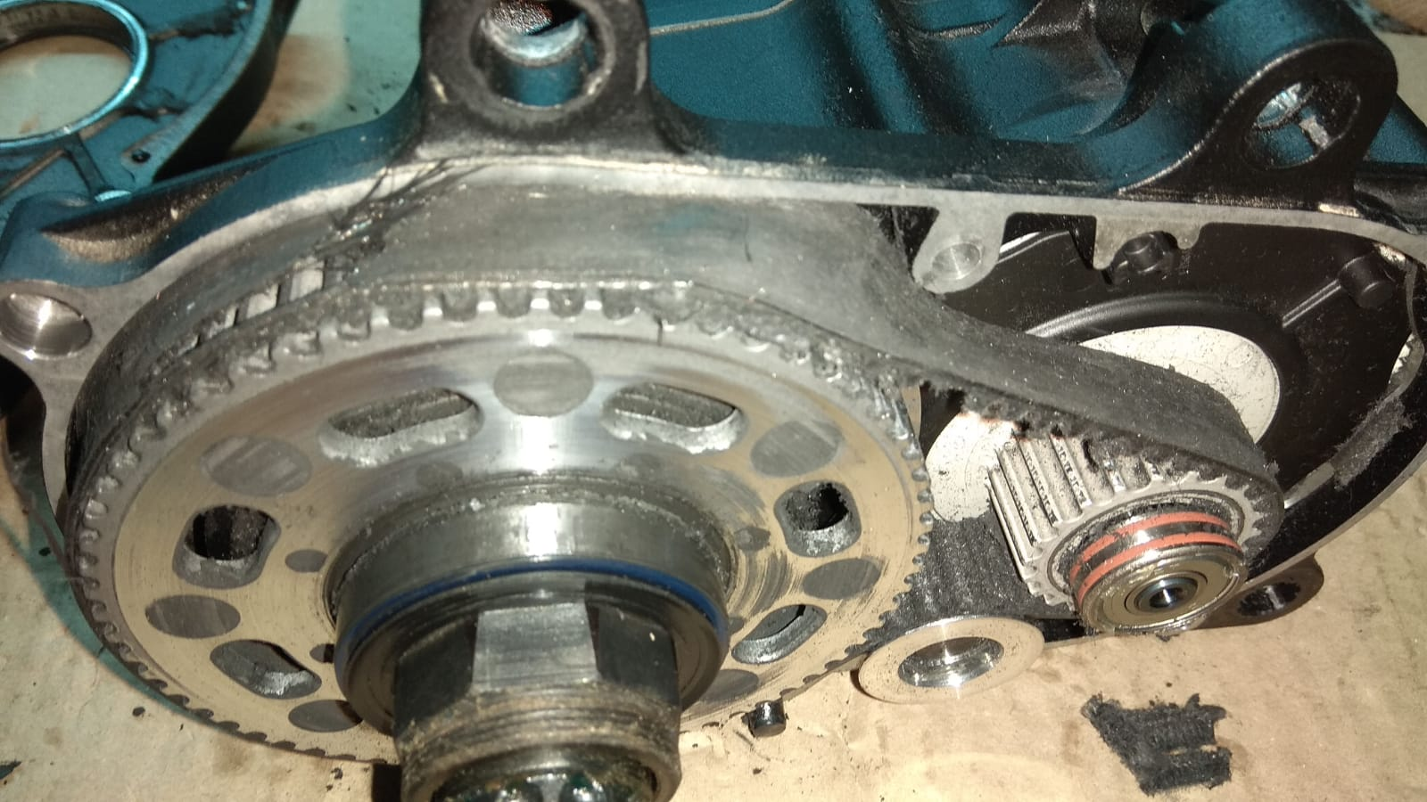

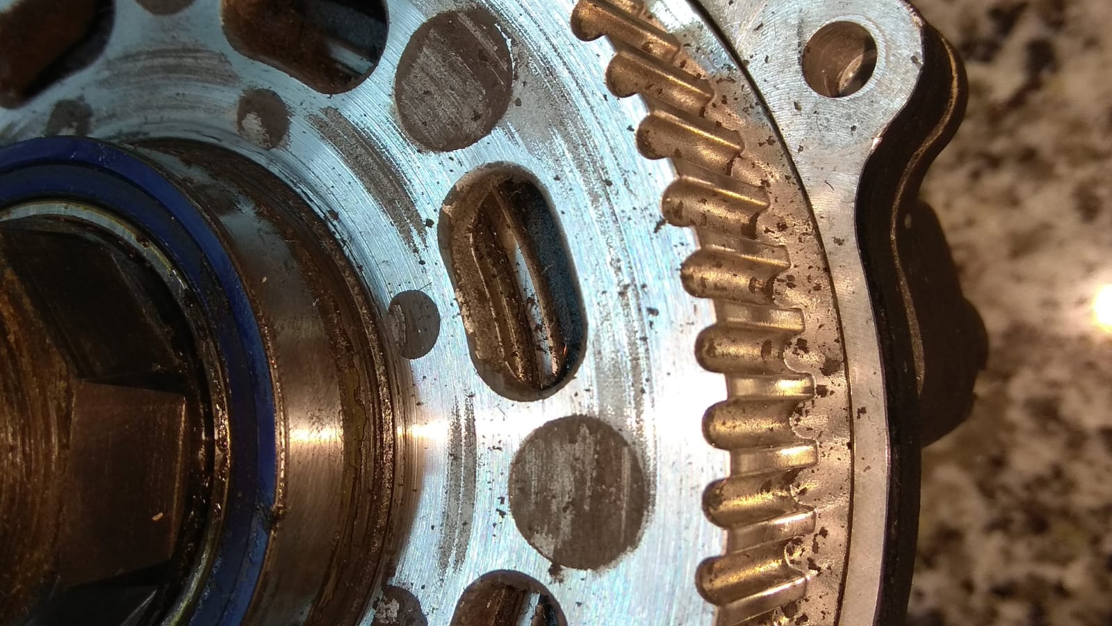

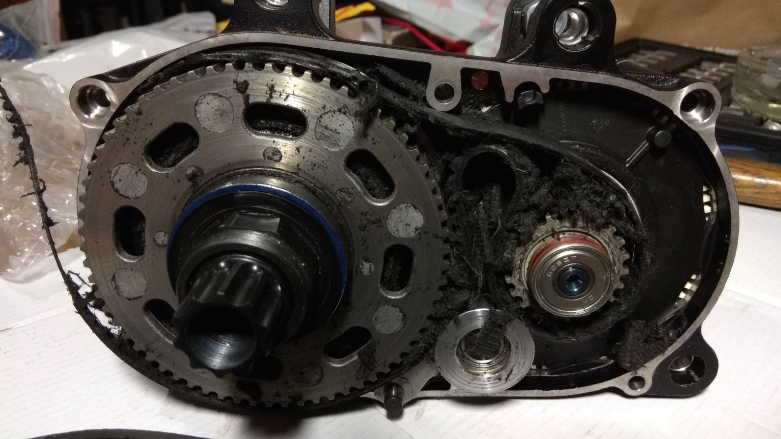

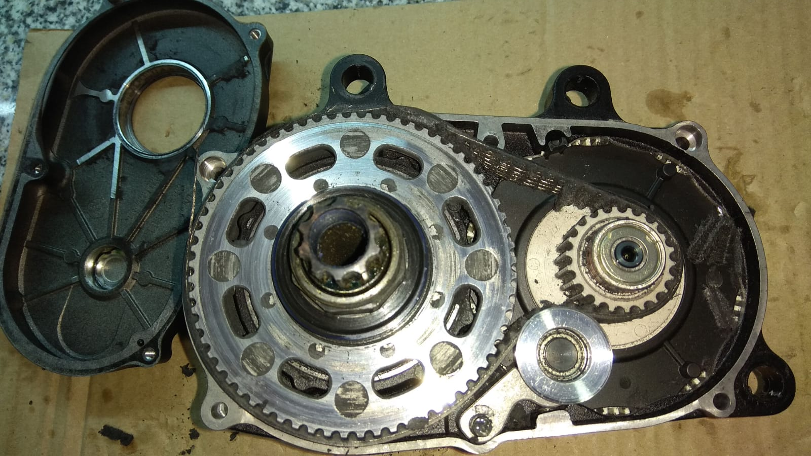

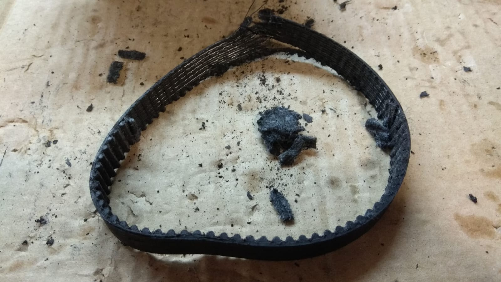

The original motor of my bike (I have 2), also broke the belt, but this time I think that the trigger for the disaster was a fall or a blow of the connecting rod in a sea of stones ...
The crankshaft has shifted and pulled the large pulley bearing out of its housing slightly and the pulley has been misaligned and rubbing against the casing, until the belt has derailed.
Is it worth while having the motor open to change the spragbearing of the crankshaft for a more robust one with a metal cage?

@Bearing Man , What waterproof grease do you recommend using on the ends of the crankshaft?
For motor planetariums I guess the BOSCH one is ok (Molikote PG-75)?
For Spragbearings, if they have a metal cage, and needle bearing, wouldn't it be better to use a high-performance grease instead of Molikote PG-75 (less effective but more suitable for plastic-plastic plastic-metal)?
Do you think that the tremendous price difference that exists between the strap of the Brose kits (Gates Carbon) and a standard industrial strap (Gates Powergrip HTD) that the aluminum Brose had, is going to suppose a proportional increase in durability (10x ) ?. I doubt it...
It's a shame that Gates doesn't sell the Poly Chain GT Carbon in 405 ...
For the plastic planetary gears you are right, either Bosch motor grease or Molykote PG-75 will do the job. For the ends of the crankshaft that are subject to water I would use a very water resistant "tacky" grease that will not wash off easily. There are many on the market, we use Renolite CA-LZ but this is a bit tricky to get hold of.
NEVER use the wrong grease on sprag bearings! Never use too much grease on sprag bearings either. If a high pressure grease or one based with Teflon or PTFE is used, the bearing can slip and grip, this will shatter the bearing. Too much grease will stick the sprags together and cause the one or two sprags that are free to fail. We supply a small amount of grease free of charge with our bearings and overhaul kits.
The needle roller bearings are pre-greased from the factory and should not be cleaned and re-greased, once dirt has been in there, the bearing is damaged!
Gates Powergrip HTD belts have glass fibre strands and will last about 5 minutes (trust me I tried many times!).
? Thanks for your answer
(In your videos you also use bosch motor grease in spragbearings, right?)
This one looks very good, but I don't think they market it to the right extent ...
This was a scrap motor and just wanted to show a grease being used. Didn't expect people to pay that much attention to be honest!
Is that I pay a lot of attention ;) ? ? ?
I had read that the presence of Teflon in spragbearings grease should be avoided, thanks for confirming.

Summarizing:
The belt---: there is no other reasonable option than to buy the original from the Brose kit.
Planetary grease---: Drive Unit Bosch or Molykote PG-75
Crankshaft end grease---: Renolite CA-LZ or similar waterproof grease.
Grease for Spragbearings---: ???? (also Drive Unit Grease Bosch?)
Vaseline petroleum jelly for belt
If the needle bearing is in good condition (if neither water nor dirt has reached it), grease it or not grease it? that's the question .... and with what?

Summarizing:
Yup, you summarized that exactly. Except I said "NEVER use the wrong grease on sprag bearings!" Bosch drive unit grease is the wrong grease.
Summarizing:
?‍♂️...sorry .... then ....What is good for this?

Good question... For my ebike motor repair business I spent years researching parts, bearings, greases, grease amounts, O-rings, seals etc. and a mans gotta have some secrets. If you buy your sprag clutch bearings or Brose overhaul kit from us, you will get the grease for free (y)

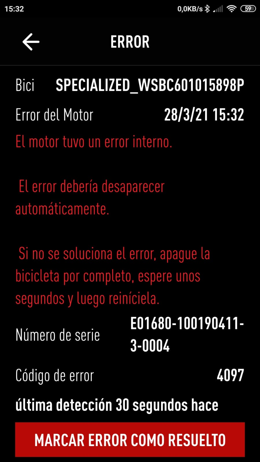

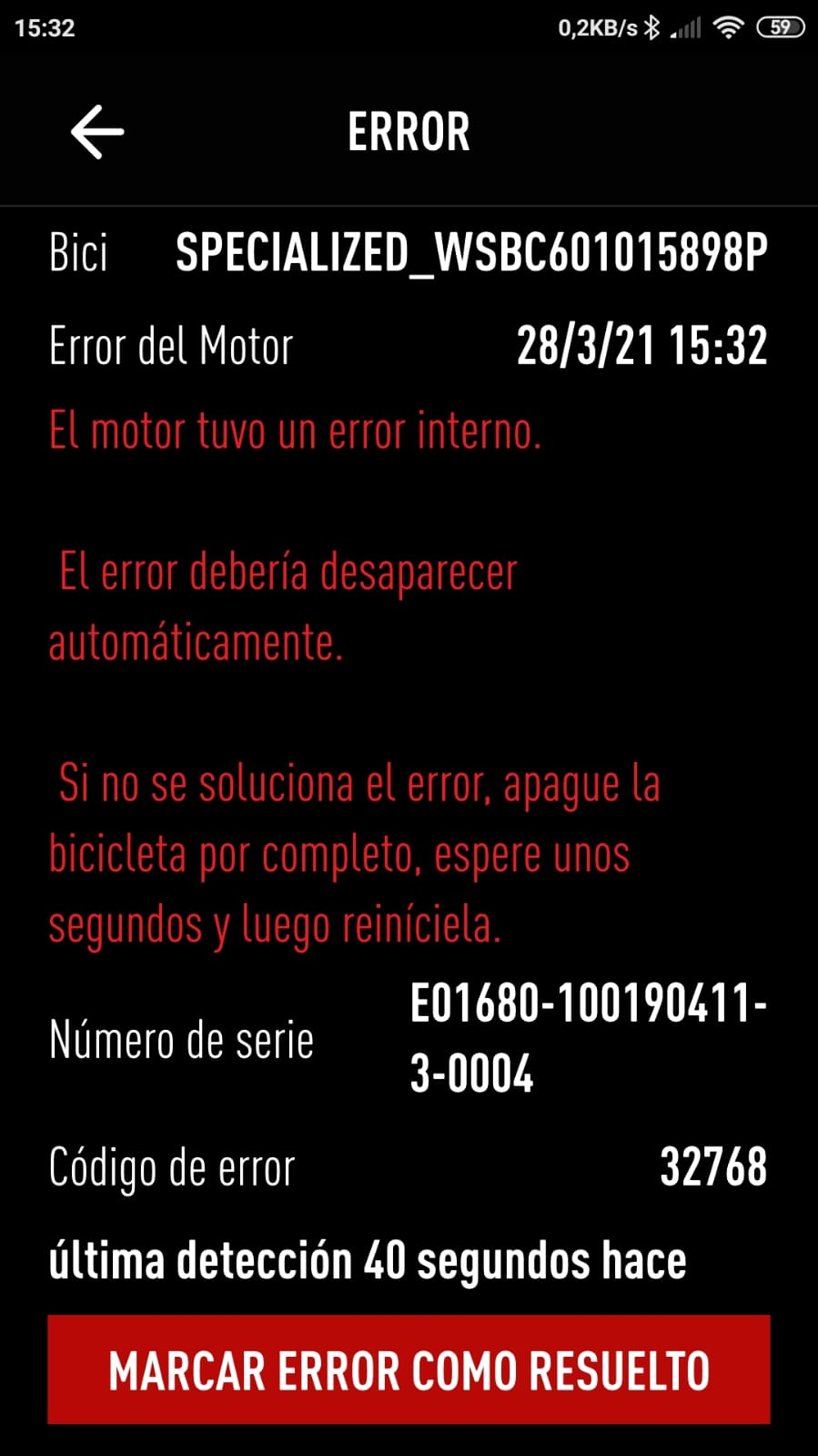

Hi, My bike, a 2019 Levo broke the belt, I have replaced it with a last generation one.
The problem is that when starting the bike, an engine error appears in TCU.
With Mission Control v2.2.0 I have obtained the codes of these errors: 32768 and 4097
View attachment 57271 View attachment 57272
Battery-motor cable is a new one.
It has been tried to put a new engine and everything works perfectly, then it's an internal engine error.
I don't know if 'Turbo Studio' is capable of erasing non-volatile fault codes. (like on a car)
The fact is that at my dealer they are totally lost and they don't give me any other solution than to change the entire engine.
Any suggestion (other one than change motor ;))...... TK

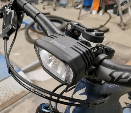

i had a very nice, and very expensive Lupine AF light installed on my Levo, about 380 euros, and now,it doesn't work with with the new motor that i had to pay for, apparently specialized doesn't want people to draw power from their motor anymore, or they just released some buggy software, ok it's summer, so i'm fine, but in 3 months time i will have to spend another 300+ euros on a new lamp that will never be as good, because i will have to attach a huge battery to my frame, that is just UNNACEPTABLE !!!
sadly the dealers can't downgrade the software, and specialized refused to do it, so basicaly i can't ride my bike at night anymore, so i can't use it at all in the winter,
they should do the OPPOSITE, i was very dissapointed that the levo gen3 didn't have at least a simple power network, usb close to the handlebars (IN the frame), but allowing to connect a phone to the battery, maybe a 12 volt output there as well. (or whatever lights require)
some power near the dropper and derraileur post maybe ? and work with SRAM to have a connector for the AXS system ?
no, they prefer to close their eyes and pretend it's not an e-bike.
those changes would actually be barely visible anyway.
it's just SILLY to have such a huge battery in a bike, and then being forced to add three more !!

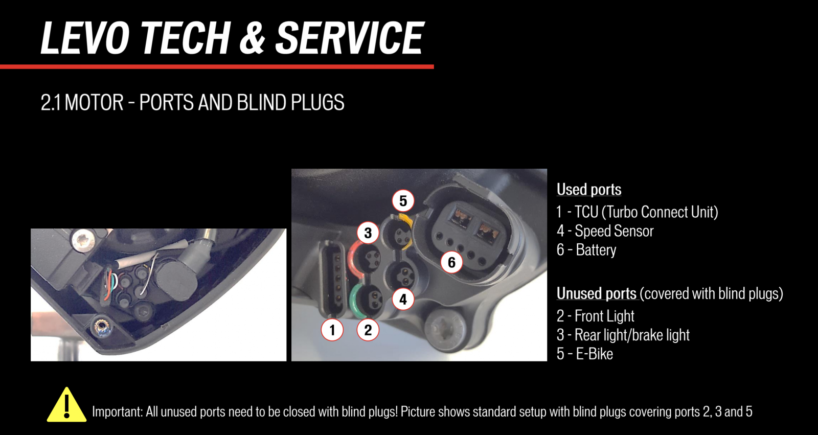

I was surprised to read that there are light output options. This is from the shop manual.
Key facts:
• Output:12V/24W, 2A max.
• Green port: front light
• Red port: rear light
Various front light work with the output the motor ports provide, examples: Supernova M99 Mini Pro-25, Lupine SL X E-Bike, Light&MotionSeca1800 E-Bike (order connecting cable separately)
Lights will be powered when bike is on, unless a switch is integrated into light wiring or head lamp itself
Moots YBB
Dec 18, 2018
67
56
Brussels
Key facts:
thx ! i think the repair guy was using the yellow connector
Moots YBB
Dec 18, 2018
67
56
Brussels
Key facts:
that fixed it :) i connected the Lupine to the green connector, works perfectly, thanks (again)
