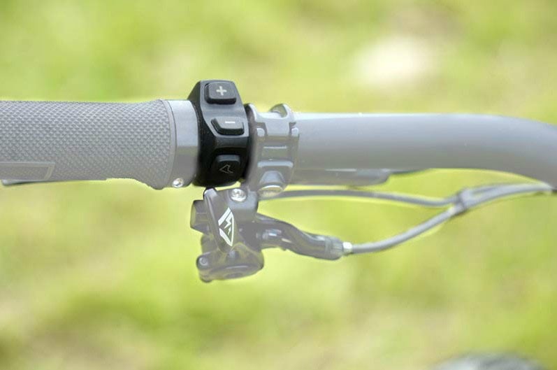

Other "S" Button (top) REMOTE SHUTS OFF REMOTE
SNEEZE
Sep 15, 2020
46
35
LAFAYETTE

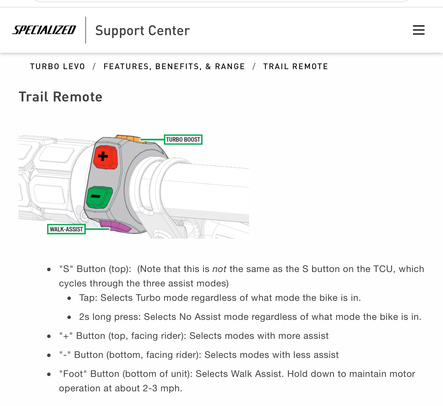

"S" Button (top) of Mode Remote
2s long press: Selects No Assist mode regardless of what mode the bike is in.
My question is once all buttons are disabled how do I get the buttons to function again.

The top button is Turbo...ie regardless what mode you are in it takes you straight to Turbo. Never heard of a 2 sec press disabling the modes and when I hit that button in a rush on a trail I often hit it a couple of times and hold it to make sure I have engaged turbo...it does not disable anything. I suspect your is faulty.
From the description above, it says “Selects no assist” mode. It doesnt (shouldn’t) disable the buttons. Cyclying the buttons should still work to get assist back. Maybe there is a problem. Can you change the assist using the TCU buttons..?

I wonder if that facility ( if that is in fact a facility!) is a more recent firmware update? My bike is 2019 Levo Comp and the manual does not say anything other than the top button puts you into turbo mode....on my bike there is no long press to go to no support. ( PS I would not put the bike upside on the bars with the motor on in any case)
