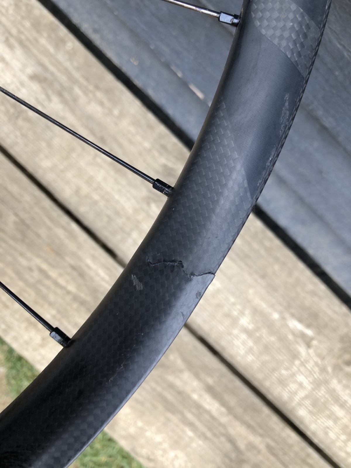

Stock rear wheel on expert done after 5 days of riding. I suspect in part due to poor tensioning from factory. After flat spot I noticed spokes are all very loose. I am 145 lbs and haven't ruined a wheel in 15 years and we have quite a few bikes that get quite a bit of use. Oh well not totally surprised, I think there are a few areas where they skimp or use house branded products to save a few bucks. I wouldn't mind on a low end bike but not as happy on a $8k bike. Not going to spring for it on the expert but I have WR1 composites with dt 240s on my Pivot, hammer them and never even touched a spoke wrench.

I have never had a rim failure on any Roval wheel or a hub failure on any Roval wheel that uses the DT-Swiss Star ratchet.
I have had the same Traverse SL 38 carbon wheels for 3 years and have never had an issue. I weigh 252 lbs and they are on my Kenevo which I use at the Skypark bike park.
What am I doing differently?
I have know clue, but my evidence to the contrary is purely anecdotal, just as the OP’s opinion is anecdotal.
But I am not letting Roval off the hook here either. The Formula hub they use in the rear wheel needs to be replaced by something else, because I have been replacing axles, frrehubs and bearings pretty routinely for my customers.
One thing that has been common in just about half of these cases is rust in the bearings. Yes bearings don’t last forever and will need to be replaced from time to time, but some of my customers seem to think they can powerwash or jetwash their bikes with no consequences.
Another reason, and I hate to side with the so-called “Traditional” or “Real” mountain bikers; a lot of Emtb riders aren’t very skilled riders. Yes I know we all think we ride like Danny Hart or Loic Bruni, but I have seen it time and time again. Heavier bikes with regular mountain bike wheels that are run into roots and rock gardens without proper technique or riding fundamentals.

Ive now destroyed two hubs on my Kenevo and while I am not by any means a pro rider, I do know how to ride. Some of the tracks I have taken my Kenevo on are way worse than a street side kerb. This bike is a gravity oriented bike and it should have the right gear from factory.
I would expect on a top of the line Kenevo they should at the very least fit them with the dt swiss hubs as they have now upgraded me to.
Up until this bike I have never broken a hub so it is obviously an issue as it’s happening world wide.
