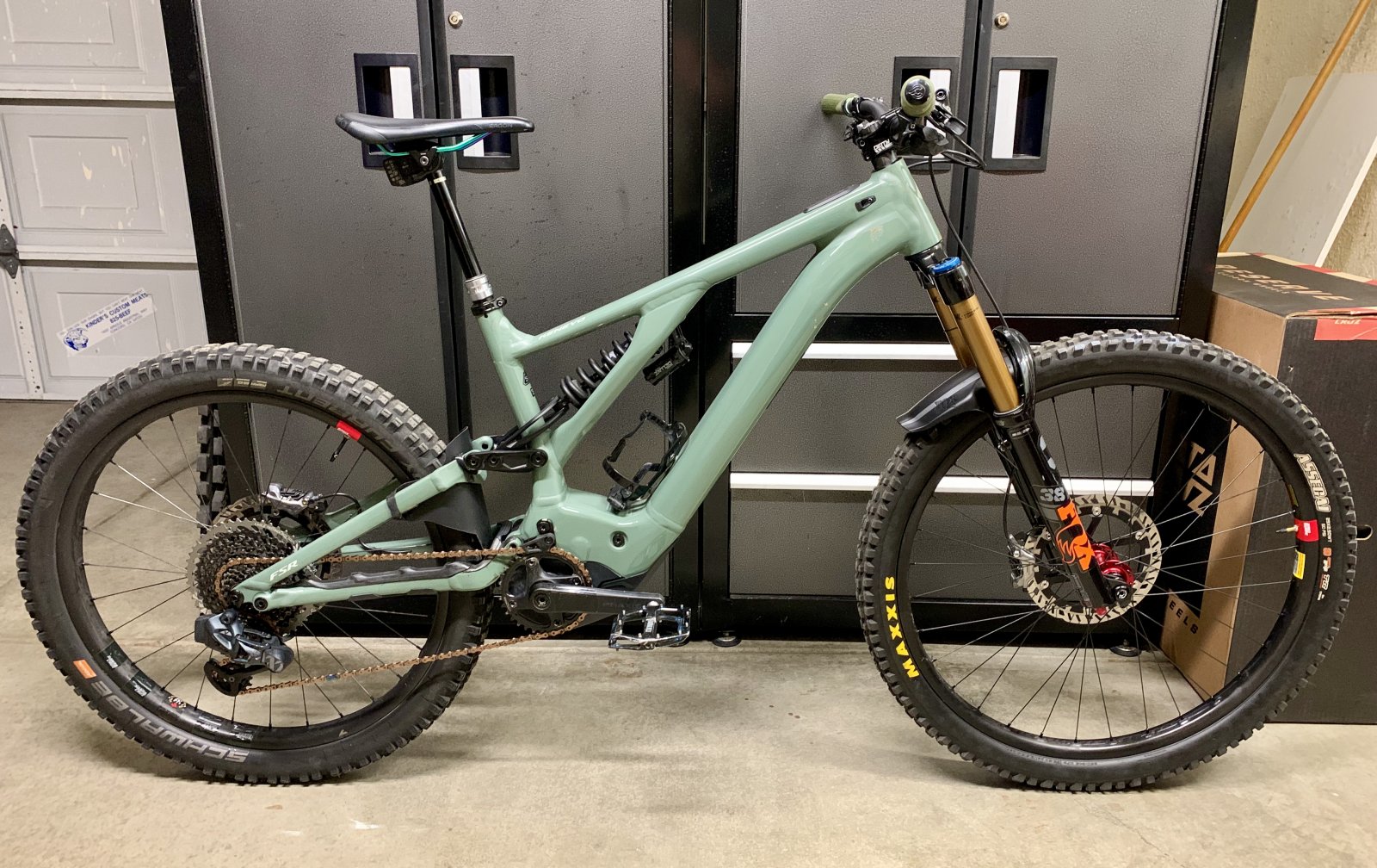

My solution that I was never really comfortable with.
The problem with the 15mm end caps from specialized is the axle will not be sitting on the heel bearings.
A new wheel sounds like the best option which is what I ended up doing.

I’ve tried to convert the axle at first because my rovals had rebadged dtswiss hubs
I’ve used dtswiss end caps on other roval wheels and they worked
The problem with the Kenevo rovals is that the front wheel endcaps have a cover pressed in
This version of the hub does not allow interchangeable end caps
My solution was to get a 29er wheel to go with my 38 fork and go mullet
