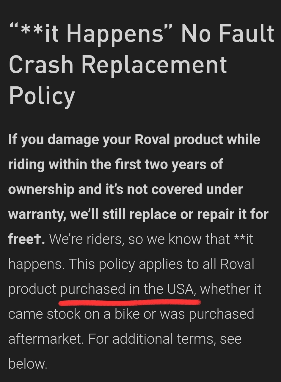

Hello EMTB crew!
I've got a Specialized Turbo Levo Expert rocking Roval Traverse wheels, and unfortunately, I damaged rear rim during my last ride.
Now, I've heard about Roval's "**It Happens" No Fault Crash Replacement Policy, which sounds pretty sweet, but there's a little hitch.
The official info I found says it's for wheels purchased in the United States after September 2019. I got my Turbo Levo in August 2022 in Croatia, so I'm not sure if I qualify.
Has anyone from Europe had any experience using Roval's "**It Happens" Policy? How did it go, and did you face any challenges with the whole U.S. purchase requirement?
Thank you in advance and happy riding!

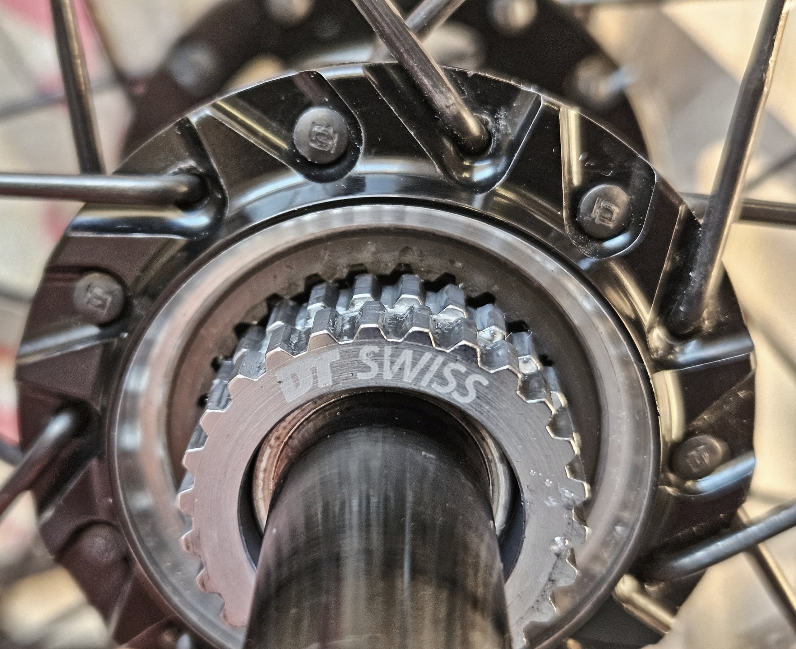

Just a quick note, Roval Traverse wheels actually feature the DT Swiss Ratchet LN system (see photo below). I've found this system to be pretty solid in terms of engagement and durability.

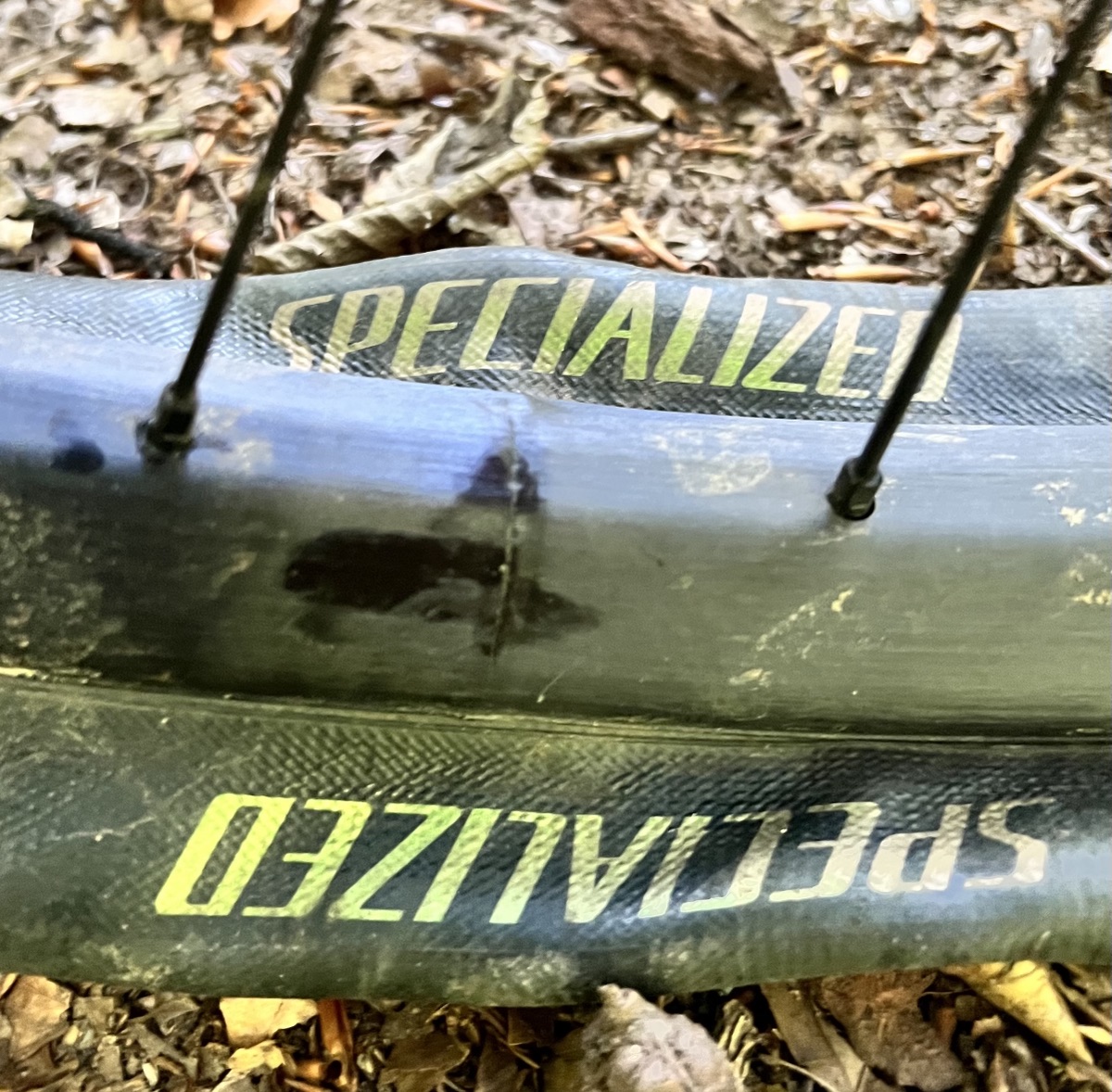

This one cracking on the weld after a rock garden hit elsewhere on the rim, roughly 5 rides old, is why I say specilized wheels are soft as shit. I’m fairly svelte and this is the first time I’ve split a rim on the weld since I had a Raleigh Activator, despite a lot of bike park laps and off piste rock gardens in the last 20 years.
This was before the ‘it happens’ policy, the bike shop just laughed and said theres no way specilized would warranty it. Replaced with hope/dt Swiss combo, which is going much better (I.e it’s done more than 5 rides and hasn’t catastrophically failed).
