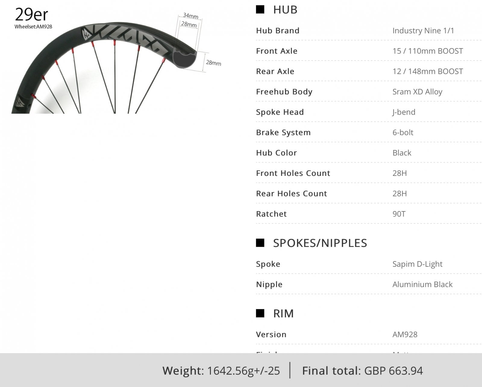

Have you considered getting a set of carbon wheel built by Light Bicycle they have a U.S factory and will custom build for you. This is usually a cheaper way and you get to have fun configuring your own rims, hubs, spokes etc

I had a look last night to see how light I could get a 29er wheel set to be. You are a little more restricted on the U.S warehouse compared to the global Chinese factory, but you would save a lot on delivery and import costs.
i know they do 'flyweight' versions on some of the XC rims. A big part of the weight saving seems to be on the hub choice. DT Swiss 180 is the lightest... but pricey. Sapim CX Ray spokes and aluminium nipples will also keep weight down.
However, I don't think you are going to get near 1200g. Realistically with XC rims about 1400g. But that Is only going to cost about 800 to 900usd

yeah, the flyweight XC rims on LightBicycle have a pretty pathetic strength rating compared to most other rims on their site. probably looking at at least 26mm inner width.

I got the 25mm inner width with I9 1/1 hubs, 28 spoke front, 32 rear. Under 1500g with rim tape and valve. Rode for a week in North Carolina with lots of roots and rocks and speed and held up perfectly. I’m sold on them. $1200.
