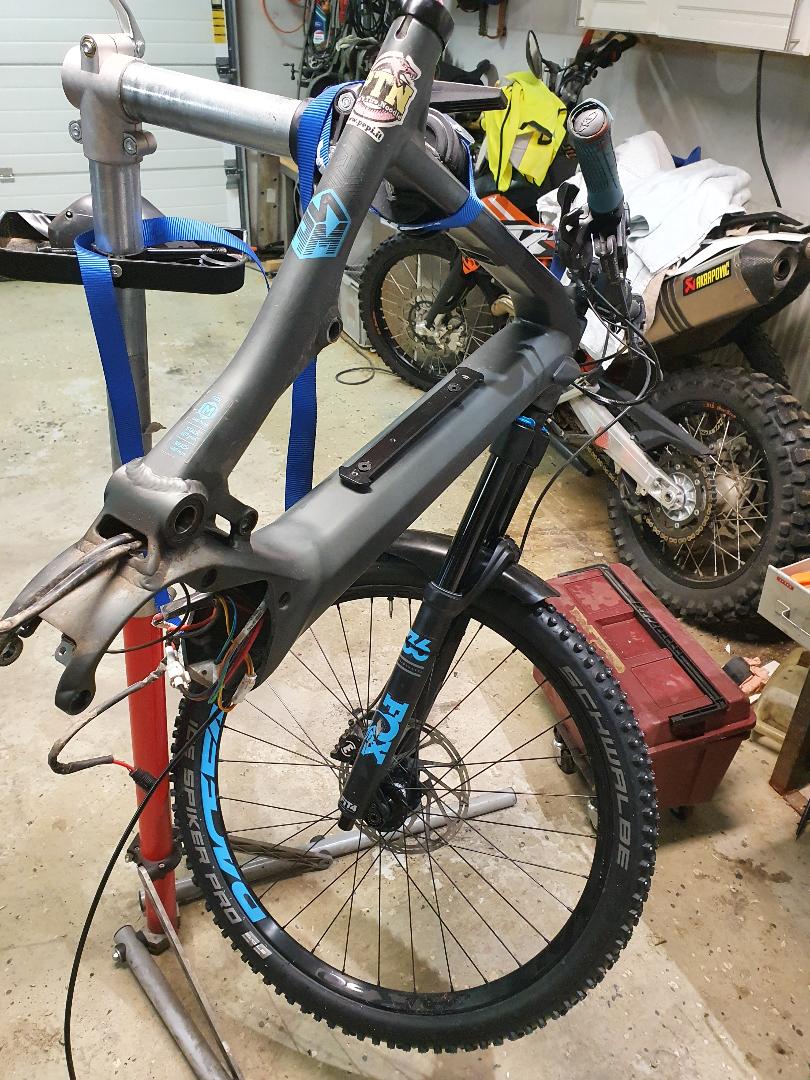

You do not have to remove the motor, it is enough to remove the shield on the underside of the motor which is fitted with four screws.
It is no problem to take down the engine. Loosen the cables and unscrew the six bolts.
sdcoffeeroaster
Jul 22, 2018
563
209
San Diego, CA
It is no problem to take down the engine. Loosen the cables and unscrew the six bolts. View attachment 27801
Yes I agree. I've had my motor and battery out of my CF frame since I replaced the frame (under warranty for decal cracking). The dropper post cable runs at the bottom of the battery in the picture above separate from the the other cables that run above the battery and are zip tied in to the frame above the motor. It should move freely. It then passes under the motor above that skid plate. So if you remove the plate you should see the dropper cable and determine that it can be easily pulled without dropping the motor.
